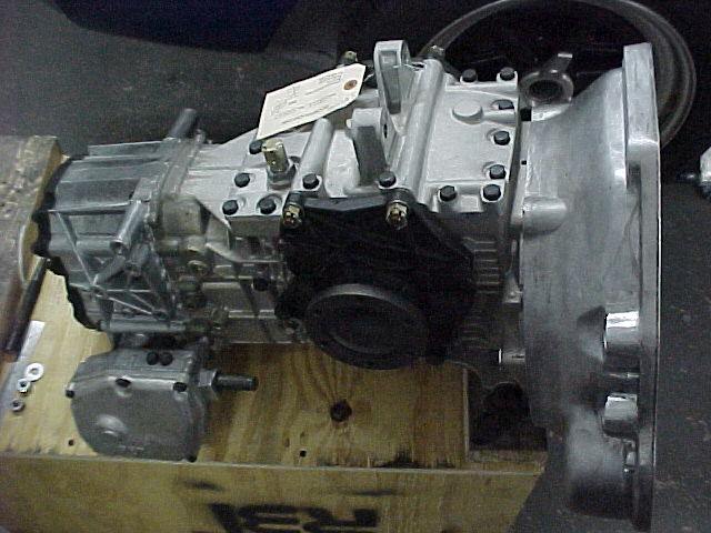

Martin,
Before you spend some serious cash, talk to Lloyd Butfoy at RBT. He built a new GT40 configured ZF-2 for me recently. I got my choice from quite a selection of ratios, BMW output/CV joints, right hand fit up and a new heavyweight bellhousing for about $9000 including shipping to the UK.
He is a very busy guy but is most helpfull and did my order in 4 weeks.

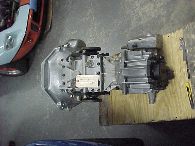

Wayne,
I regret I can't help you presently with exact test criteria as I'm waiting for my test certificates from RBT.
However, I purchased this transmission based upon sound advice from this forum. Please check out our Gary Gibbs' spreadsheet from last year and the pertenant threads on ZF and they will give you an idea of my expectations. 600HP is no problem with these boxes.
My car is currently built to a road specification but from the outset I decided that everything especially the trasmission and power unit would easily upgradeable to racing specification with a few retrofit parts. After all MDA make racing cars.
Maybe like you, I have found that information on ZFs is rather scarce and concluded that after several months searching, for my money this forum offers the best available advice - and long may it continue.
I will contact you as soon as the certificate reaches me.
