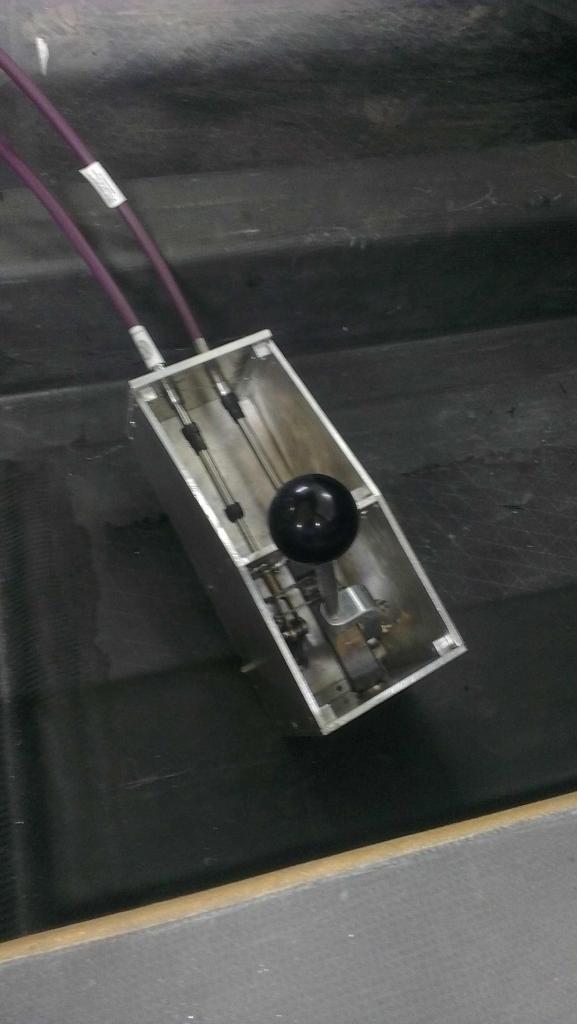

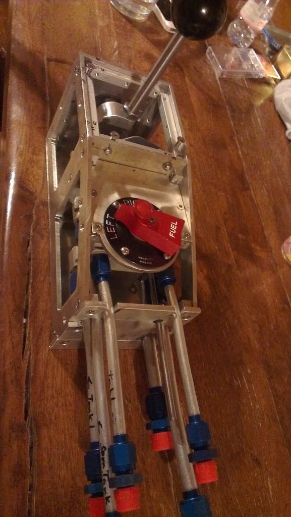

Hello
here some pictures of our shiftbox.
We integrated also the fuel selctor in the box.
I think we also worked with the Olthoff cable shift linkage direct on the ZFQ with some small changings.
Greetings from switzerland

OK so here is a pic of Olthoff racings shifter, cable operated for central mounting. Also ordered their ZFQ linkage adaptor for the gearbox.
Mounted on the BEC midsection with a hole opened for the cable.
Southern GT selector looked great with a very nice alu-frame showing gear position, so recommend that for those not going for central mounting. Its rod operated.

That is the same shifter from a late 80's/early 90's Toyota. I know, because I installed one in my car last year. Please don't misunderstand me though, it works like a champ!!! You can buy short shifter kits for them as well.
