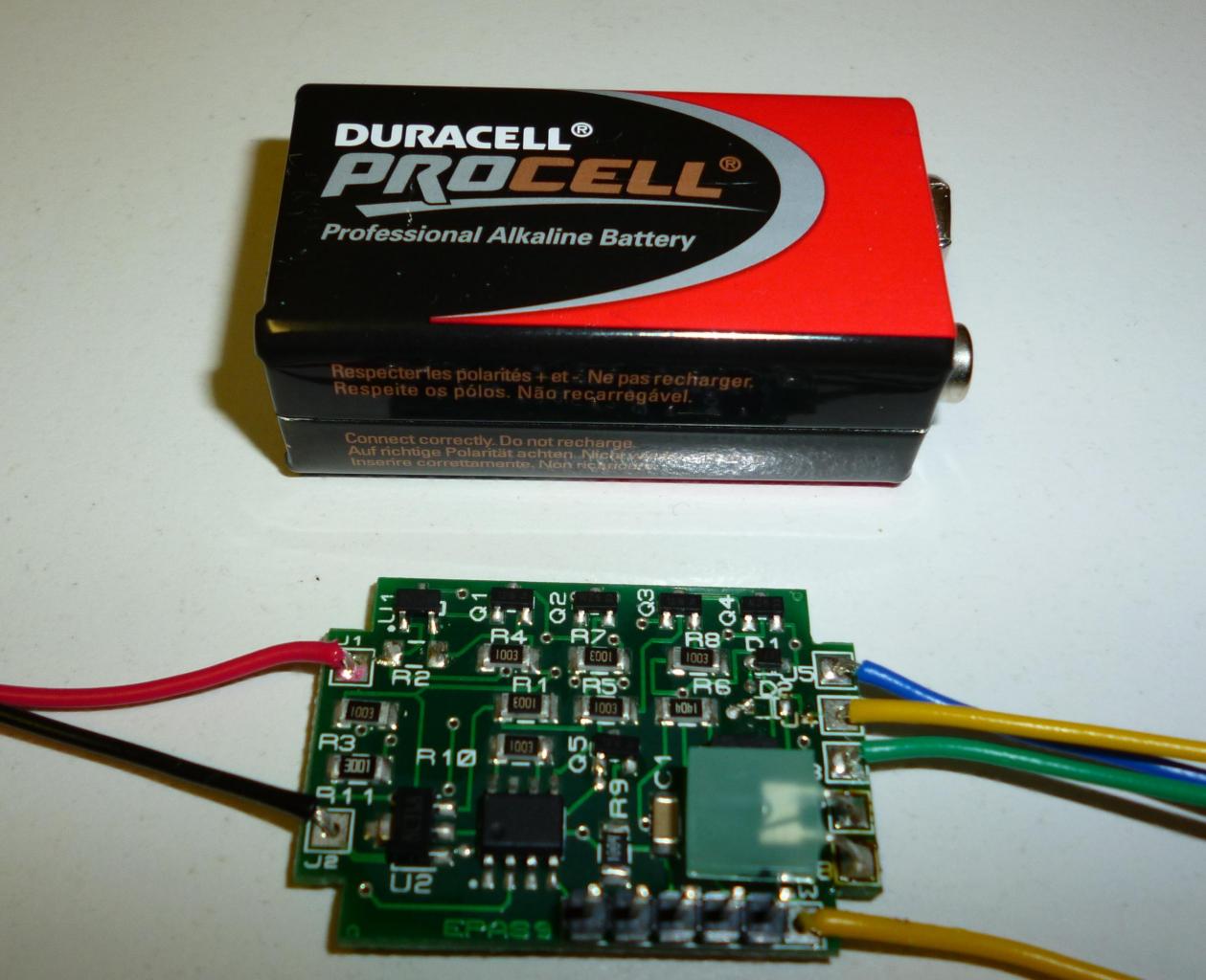

Got my Corsa C EPAS 'assistance controller' finished, I did not want to fit a knob on or near the dash!
My circuit has a 10 second delay upon start-up before it outputs any pulses, then it outputs a constant rev signal for the ECU to know the engine is running. it also outputs a low speed (high assistance) for a period of 1 minute, to allow you to 'unpark'. It then automatically reverts to the high speed (low assistance) until the button is pressed, which will give you 1 minute of high assistance, and automatically reverts to low assistance after the minute.
If you press and hold the button for 5 seconds it turns the circuit off, likewise if you press and hold for 5 seconds it comes back on again.

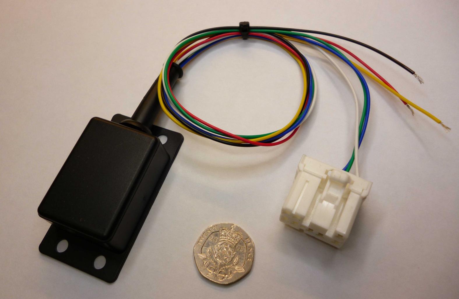

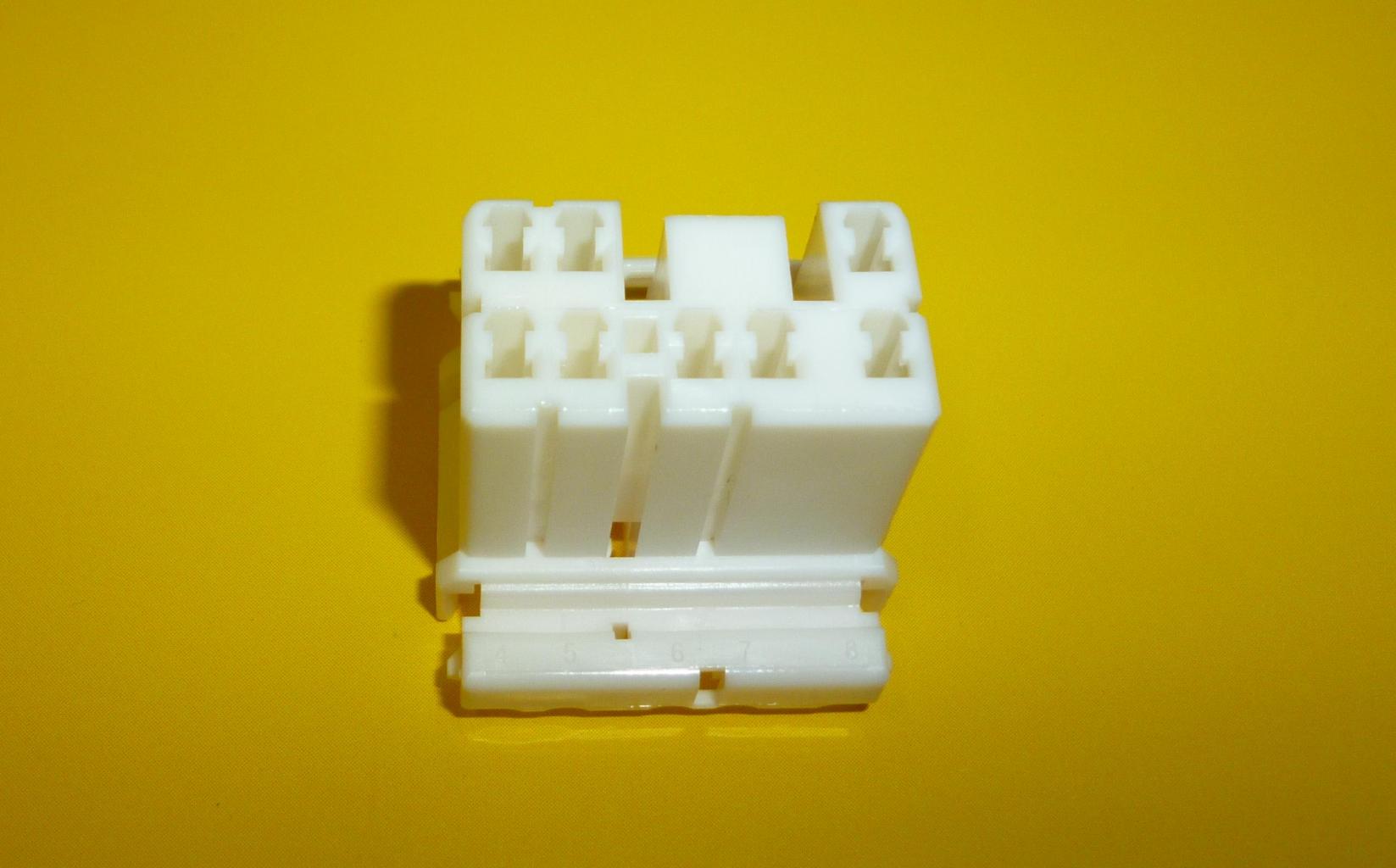

I managed to source the connector plug used on the Corsa C EPAS ECU. Let me know if you like what you see, battery is just there you give you a feel for the size, I have an ABS enclosure for it also.

Got my 'push button' EPAS assistance adjuster circuit finished, "EasiPAS", no knobs, just a push button of your choice! The front of the '40s are light, so you'll rarely need high assistance. How mine works:-
After the 10 sec start-up delay the EasiPAS outputs, for 1 minute, a slow speed signal this will give you 1 minute of high assistance to manoeuvre, after which time EasiPAS will revert to the default state of high speed which puts the EPAS into the low assistance state (as if you are driving at 45+ mph). So you always have this low level of assistance.​
Next Project is a circuit to translate pulses from the wheels/shafts to the right rate to automatically adjust the assistance:-​
This circuit will allow the user to program the pulse count switching points, simply by placing the product in 'program mode' by pressing and holding the button for 5 secs, then driving to 15mph, pressing the button again, then driving to 45mph and pressing again. This tells the circuit to switch from high to medium assist at 15mph, then med to low at 45mph, base on the input pulse count from the sensor on the wheels or shafts. Of course you can decide you want the switch points to be 10mph and 30mph, just press the button at those speeds instead.​

I would be interested to see how you get on, I have a feeling that the constant low assist will be sufficient for stop/start traffic, as the '40 is sooo light at the front!

Hey Nigel, sorry for the delay in replying. The speed translation circuit is done and waiting on a colleague to program it. the main 'issue' is how we let the user program the speed mapping, that is, the translation of the speed pulse count to the EPAS count. If the speed is a fixed mapping, then we can pre-program is prior to dispatch.
I expect the first versions we produce (in about 4 weeks), we will pre-program them to whatever the user wants. the cost will be less (just) than the £100. do you know your mapping?
We have one of the Torque Tek units, it is massive and inside is an Olimex development board! Ours is about the size of small box of matches (remember them), same size as our EPAS controller:-
