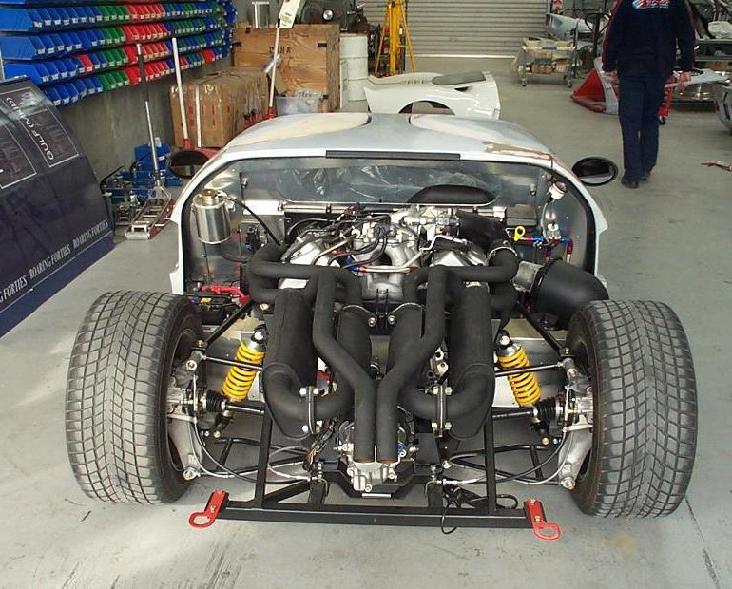

Here's a picture of my car taken at the factory last week. The spaghetti factory emissions exhaust is a nice piece of work. 6 cats, and two mufflers in there!

Even with all those pipes and cats, that thing is still impressive to look at. I saw your GT when I was there in March and I wanted a copy of it on my next GT. I like the 4.6. I'm sure there will be someone down the road that will design an 8 barrel manifold for it soon. Robert might even think about it.. /ubbthreads/images/graemlins/grin.gif /ubbthreads/images/graemlins/grin.gif

Tim, the car looks fantastic (and finished - how come you're not driving it ?) !!

Interestingly, a mate of mine is a consultant engineer who specialises in induction & emissions - I got him to do the design/specs for my engine, the goal being to pass ADR37-01. He checked out all the systems around & came up with the DC&O setup as being the best. The only change made was to turn the TB's 180deg so that the fuel rails & injectors are on the inside of the TB's, similar to TWM (his theory was to get better mix & burn by jetting straight into the head ports). Something must have gone right as it got thru the emissions test ! This mod was a real challenge on a 302, but by the look of things, the 4.6 has much more space between the TB's, so may be worth thinking about.

I'm not driving it because it is 900km away. But Robert Logan rang me on monday to say he was looking outside to see my car roaring up & down the street! /ubbthreads/images/graemlins/laugh.gif The emissions tuning is apparently going well, and they are off to Toyotas test cell next week to see where it's at.
Getting closer..... /ubbthreads/images/graemlins/grin.gif
Looking really good Tim.
I've seen a DRB GT40 completed with 4.6lt and it turned out quite nice. Yeah, you need those throttle bodies. /ubbthreads/images/graemlins/grin.gif
I've seen the effort DRB put into passing their GT40's up here and it's a massive undertaking. Although maybe not as massive as yours.
Even though our emissions are not quite as strict yet(5 year rule), the biggest problem seems to be passing noise tests. I witnessed the effort in getting a 302w passed, exhaust setup looked equally as impressive as yours, then add a heap of sound proofing, forget throttle bodies and aluminium rocker covers...they let too much valve train noise through to pass noise tests. So they fit stock inlet manifold and some nice and heavy steel rocker covers to get the cars passed.

I was down at RF dropping my car off for safe keeping whilst I'm on holidays and had a close look at your wonderful beast. The exhaust is a work of art and I must say it is the meanest looking engine bay I've seen in a 40. I don't think you'll have any noise emission troubles as Robert described it to me; your Maloo is probably much louder. /ubbthreads/images/graemlins/grin.gif

Bill, at first the sight of the "big" 4.6 didn't excite me all that much. But as the project has moved along, and i have become more used to it, and seen the possibilities for making it look the part, and "go" the part, i have come to think that this quad cam engine really is at home in the back of a GT40.
Yes, i can hardly wait to get it. It has taken a while, but i know what Robert and his team have put into this car, and the wait WILL be well worth it. /ubbthreads/images/graemlins/smile.gif
