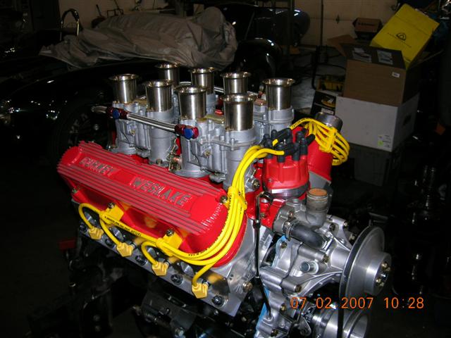

I just received a set of Gurney-Weslake (no 't' in Weslake) valve covers from Chris, and everything was as promised. Courteous updates by phone and email, and delivery in less time than promised. And they look great!
Now I just have to decide whether to paint them or not, and then dash them off to Keith Craft so he can add them to the engine he's building for me. Let's see, I have some decals and now valve covers, pretty soon there'll be a car under all that stuff!
By the way, thanks Chris!
As a follow-up, does anyone have experience with painting valve covers of this sort? Due to heat and oil, etc., is it necessary to powder coat them, or is there an off-the-shelf spray paint that will do the job?
The more I think about it, the more I'm inclined to paint mine black.
Kim

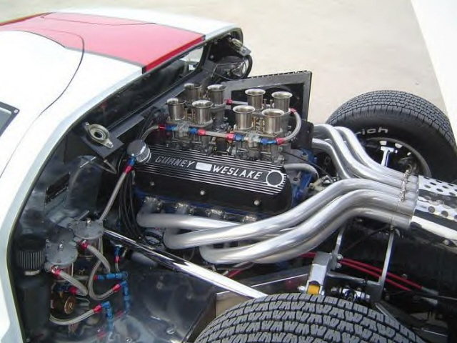

I bought a set of these covers from Chris and they are wonderful. They did however require some material removal for use with my AFR 302 roller heads. It cost me $60 to have them milled to fit. I powder coated them...see photo.

I've used VHT Wrinkle-Black paint on both Intake manifolds as well as Valve Covers. Never had it flake off or chip. Once baked on it is about as impervious to fuel, chemicals, etc as Power Coating..
yhst-66630250998963_1922_1070928
VHT Wrinkle Plus Coating
Hi Lynn
I like your treatment, your covers look great.
