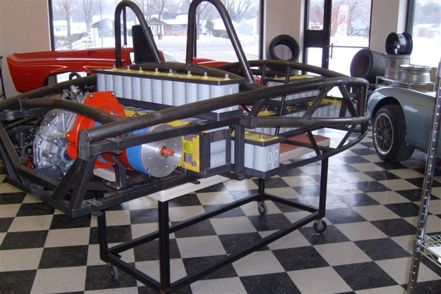

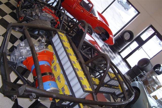

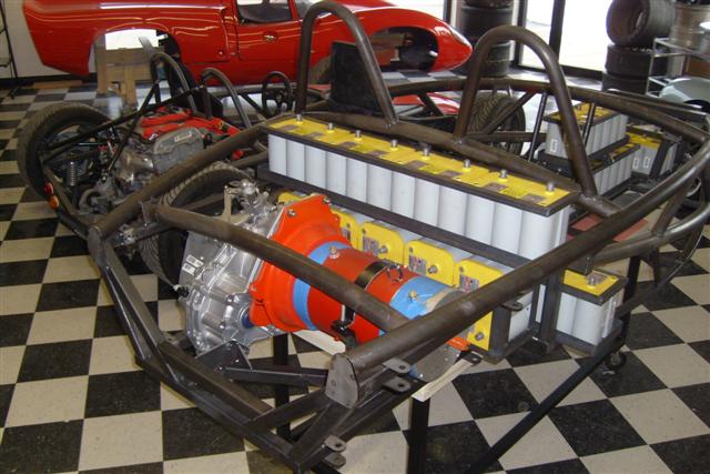

Here are a couple of pics of the Electrolite with drivetrain.....
Roadster Specs.
Weight < 2,000 lbs
0-60 < 4 sec.
Top speed 90 mph
Range 55 miles
Motor WarP 9"
Motor Torque 350 ft/lb @ 100rpm
Battery - Customer determined, packaging for 24 Group 27 batteries.
Controller Zilla 1000 Amp
Charger PFC30
Custom wiring included
Home based type charging ....no special charging post required.
The longterm plan will be to offer more advanced power source once they become more affordable and readily available..using lead acid allows the DIY access to easy resources and affordable replacement.
Full up price ...minus batteries is $34,995....

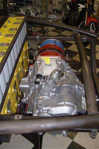

Randy...range is ...55 smiles....
Transaxle is a new F40 unit from GM...I have 6 more in stock at the moment.
Only using 2nd and 6th....
Recharge time from dead? Price of a full set of batteries? By "kit" is this really "batteries not included"??? ;)
Not familiar with the transaxle...does it automatically shift?
When do you think you'll be ready to sell them? (A good answer is "right after your 917 is done", BTW.) :)
--Donnie

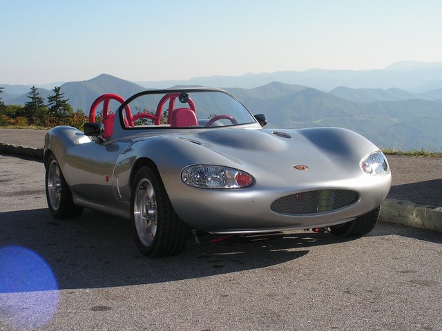

I spoke to Fran yesterday and he said he anticipates the end of April to be able to ship the SL-R on a 7 day order timeframe. I need some Unisom, I could not sleep too well thinking about the car. If the pictures of a finished SL-R with the F1 look like the rendering and the car handles well, I'm definitely in for buying one. I have my money ready, I'm just waiting to see what the car looks like with actual panels instead of the Photoshop. I like my Ginetta, but the SL-R would definitely be a little easier to work on. I'm looking forward to having some nice drives on the Blue Ridge Parkway with my brother driving one of the cars...
Go FRAN!
Guys ,
our delays are only due to having one chance to do it "right first time"...and we will be nailing it !!!!!!!...no guessing
Cool Ginetta.....:D
Brian Hamilton
You guys absolutely have to see the real thing in person to appreciate it. It is such a well built car and I am so excited about getting one. I am starting a career in Real Estate and getting married and all that exciting stuff, BUT, one of these cars is in my near future. I am already sourcing parts for the SRT-4 drivetrain I'm going to use to power it. I think I'm going to just put a stock drivetrain in it to begin with and upgrade later. I figure that engine will be enough power for a little bit until I get used to it, then it's on to MORE POWER! Fran is building an absolute monster in this little car, I'm being as patient as possible, but it's hard when you're this excited!!!
Keep at it Fran, you have dedicated fans!!!
