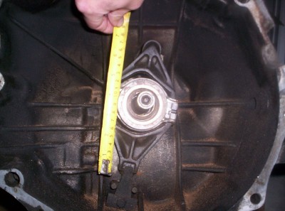

Does anyone know the the ratio of the clutch release leaver on the Audi 016 transaxle. My transaxle is installed so I cant measure it.
Mike,
Have an 016 sitting in the shed will measure and send pic if you like tomorrow. /ubbthreads/images/graemlins/smile.gif
Looks like the lever itself is 175mm long from pivot points.
The pic is not as good as I hoped but it may help. /ubbthreads/images/graemlins/beerchug.gif
