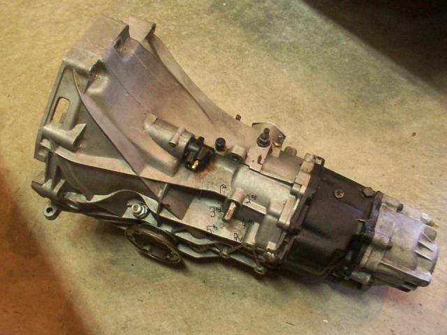

Here's a couple pics that might help (I'm no artist with MS Paint...).
