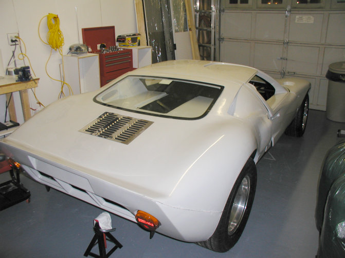

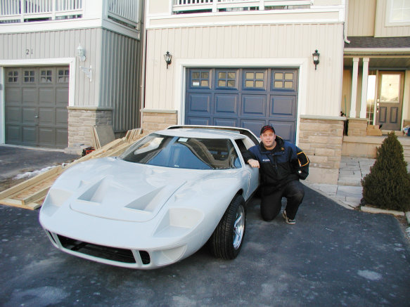

Well, finally got the car on it's wheels today so I thought I would roll the beast outside for some -20°C artic air, man it was a cold wind (as you can see by my frozen eye lids!)
The rear body needs some trimming on the inside mud guard area so that I can close it without it fouling the reverse links, not a big deal (MDA usually do this but we were tight for time to get the car shipped). Fuel tanks trial fitted, sill panels in the garage. The wheels might need a bit of machining for backspace, it's close, so I might need to drop the ride height to get a better idea. No machining was done to the wheels when ordered but Bob at Vintage sent me the maximum material removal specs for the front and rear.
Anti-roll bars tomorrow.

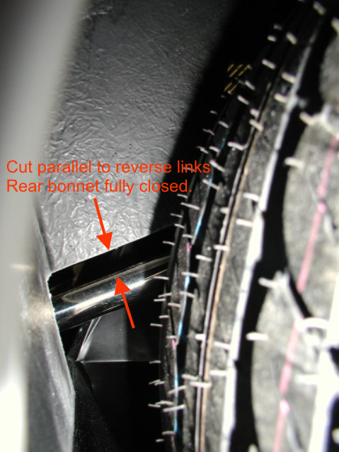

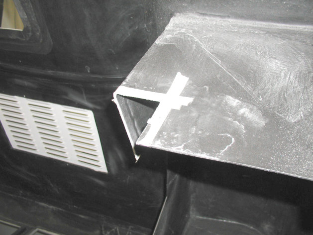

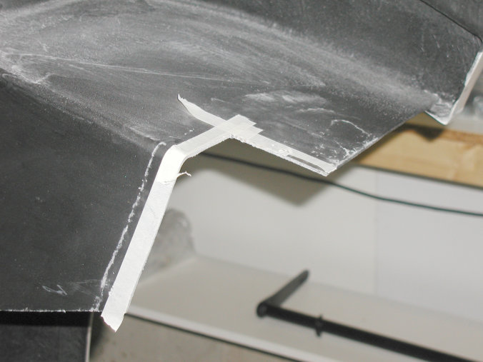

Here ya go Mark -
I had to trim the inner mud guards for the rear body to clear the reverse links. I lowered it until it made contact and marked off the area to be trimmed. Jigsaw worked fine and it now can close without effort.
Chris

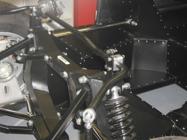

Rear anti-sway bar installed. They'll need to be taken off later for engine/trans installation.
Next up is the steering system.
Chris

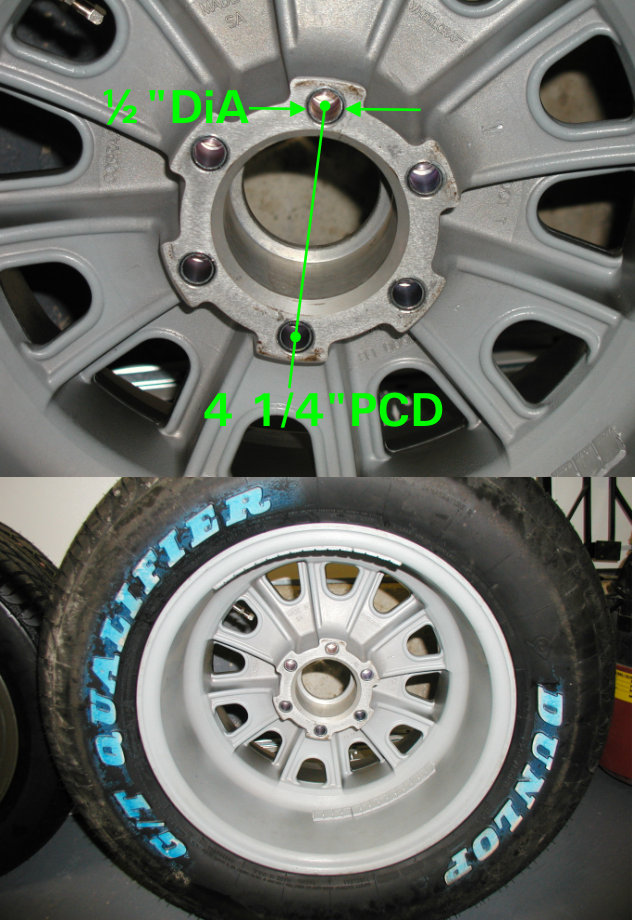

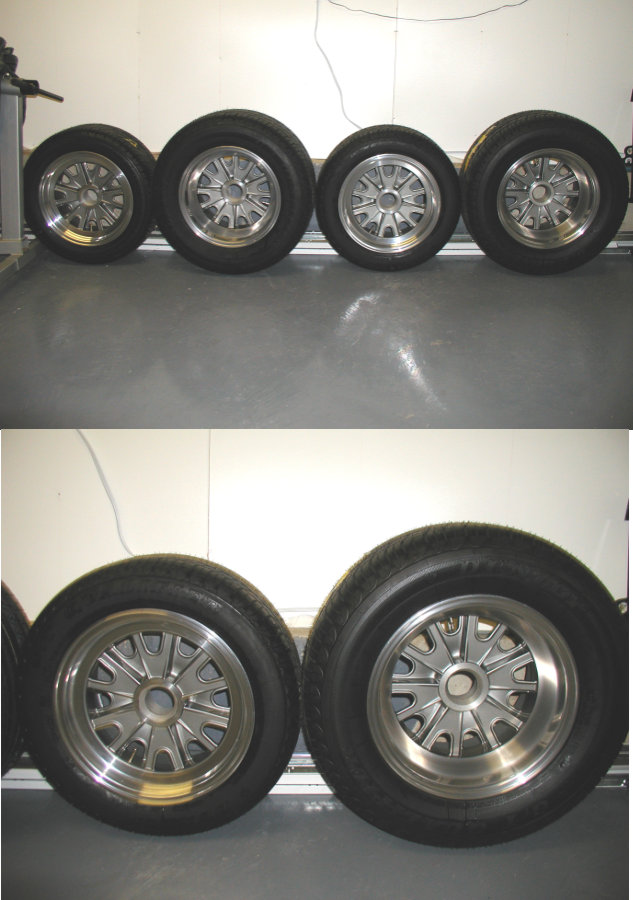

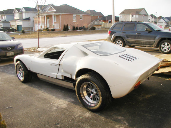

Hi Chris,
I went with 6-pin (for 6-pin MDA hubs) Halibrand Vintage Wheels @ 7.5 inch front and 9.5 inch rear. I can't get the tyres (ha) in Canada so I had to order them from The Tire Rack (great service). Front's are 225/50/15 Dunlop Qualifier T (T-speed rating) and 295/50/15 rear. Everything fits beneathe the wheel arch and has a nice beefy look.
Chris
Chris Kouba
Yeah, those tires fill the wells really nicely. Seems like those are the standard sizes for ~8" fronts and ~10" rears. Looks great, keep up the progress!
Chris
I'm actually selling my wheels (possibly tires also). The wheels are brand, spankin' new with no machining off the hub boss. The tires still have the labels stuck to them - Change of plans so they have to go. See above for specs.
Chris

Hi Mark - I know this should be posted in the Items for Sale Forum but I'll sneak a plug in here-
To be completely honest, I really don't know what wheel type I want just yet. With that said, I might as well sell these and free up some of that money and invest into other areas of the car right now so I can get it more up to speed for Carlisle in May. I can buy wheels at anytime, they just don't serve a purpose yet. It is a beautiful wheels/tire combo that I will definately conside next time.
