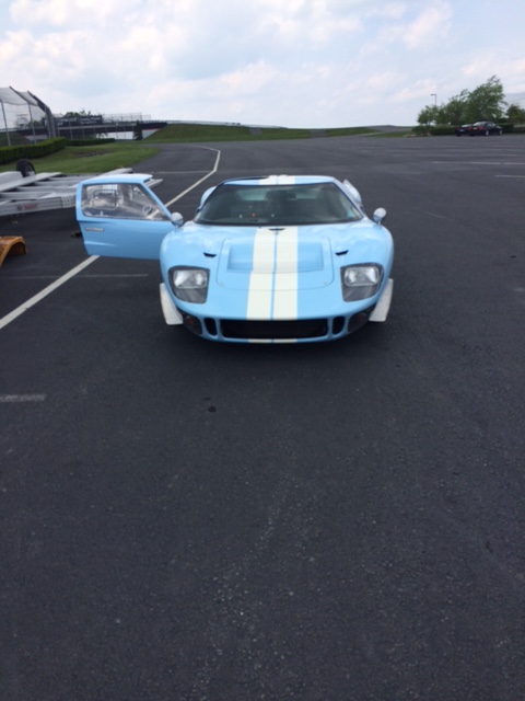

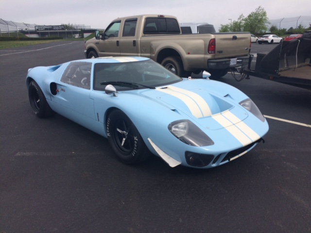

The first day at track was just getting the car runnign well. The second day about two weeks later was learning the car. Changes so far was increasing compression in the front to get rid of the darty feeling at speed, and loosenign the rear swaybar to settle the rear. Seemed to work ok, but rear feels a little too pendulum and there is too much lean in the car.
Next changes may be to stiffen front sway bar and then bring a little more stiffness back to rear bar to establish balance. there is just too much lean on turns. May also then add slightly more compression to the front and a little rebound to rear to settle car under really heavy braking and high speed corners, but will do sway bars first, one change at a time.
Motor is being kept below 6k rpm, power peak is 7k but 6k is plenty for now, still hitting 155 on straights and there is more than enogh power for everywhere else. Biggest adjustment has been learnign how to meter out the power. Coming from a lotus it was always momentum and very few places where max power could not be used.
In Gt40s every lar I see where I could be gaining speed and laptimes. Lots and lots to learn.

All good advice. A little lucky in that the car was setup by Dennis Oltrof so there was a decent base tos atrt with. Tire pressures each day start at 18psi and acording to Dennis should not go above 24. Easy to bleed off after first session(40 mins) and then they are pretty consistent. For the hoosiers, sounds right as they get a bit greasy around 26, but will look to see how they wear as I am used to runingn a bit more psi albeit on other cars.
Shock settings, yes they vary per track, but I am still trying to get to a baseline of stability that works for me. Notebook in hand. Hopefully I get tot he point where minor adjustments per track and day is relevant in terms of pace and skill. Love the tinkering, its all part of the fun of the car, and learning the car is not just the driving as you know.
BTW love the F5000
Pic was at watkins glenn. At this point I would say that i am maybe at 2/3 the capability of the car. Although I have always driven a manual on and off track it has been in more modern cars. The Gt40 takes a lot of getting used to in terms of feel, knowing the gears to extract best performance in each bend, how many revs to use before shifting which significantly varies depending on where you are on a particular track.
