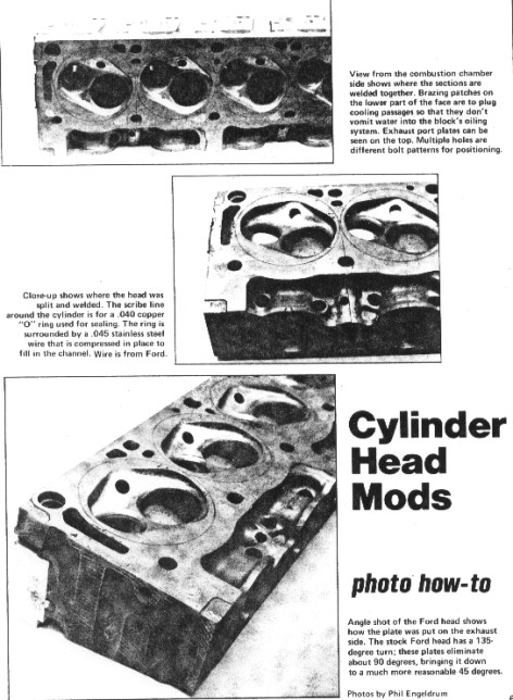

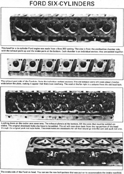

Here are the two pages that was given to me, not just two pictures as I said before. You can see the joint lines that run through the head bolt holes. It also has been high port plated.
regards
Clayton
