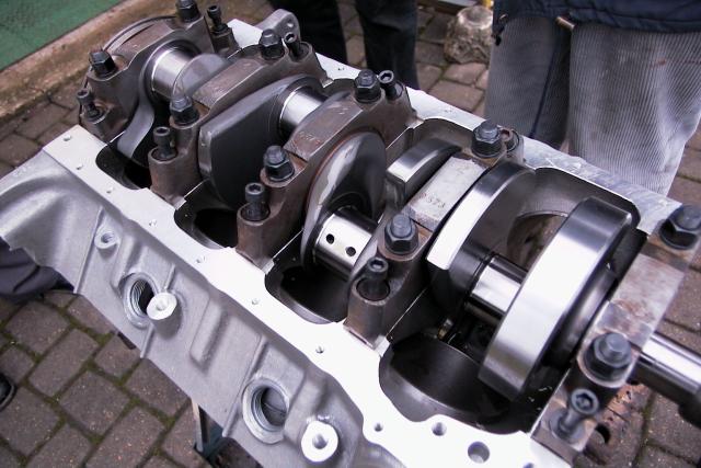

Here's a couple of pics of Roy's Fontana 302 - as supplied, which was the basis of his 347.

and from below - with stroked crank. Again, these pictures were taken before the internals were extensively reworked to 'get it all to fit' -

Paul,
Please have that motor weighed if possible before it goes in the car and note the configuration during weighing (carb or not, water pump or not, etc.) I would love to know the total weight of an all alumimium 347. This would represent the lightest of engine weights based on the Ford V8, and my aluminium head cast iron block (465 lbs) would be more toward the upper end. I would guess 325 lbs. I expect about 100 lbs going from cast iron block to aluminium and ~40 lbs going to the shorter deck height. Thanks.
I think it is too late for that Gary, that motor has been raced extensively in the car unless it has been out for freshening.
DART lists the weight of their Iron 302 block as 160 lbs. and their Aluminum 302 block as 75 lbs. The Ford Factory Iron blocks are a fair bit lighter than the DART, which has been considerably beefed-up. The late (1985-on) 5.0 block uses thin wall casting and is the lightest at 120 to 126 lbs. depending on the year. (And also not as strong, unfortunately). The earlier (1969-on) 302 blocks are a little heavier and stronger at about 145 lbs.
If you are comparing to an 85 or later Roller cam block, the Aluminum Dart block will save you about 50 lbs.
(Gary, they list your Iron 351 block at 195 lbs. for comparison. Plus I would add another 10 - 15 lbs. for the bigger crank).
Kevin
Using your numbers it would put the alum 302 at ~330 lbs. Very nice. The Aluminium Dart 351 block lists at ~95 lbs. Thus my motor in all aluminium would be ~365 lbs.
Hi Gary -
As Ron said, engine has been used for several seasons now, although I did speak to Roy and checking records - he seems to think the block was about 90lbs. I remember that I could carry it 'one armed' but that doesnt tell me very much!
Engine has just gone back in after Winter refresh/upgrade and dry-sump installation.
