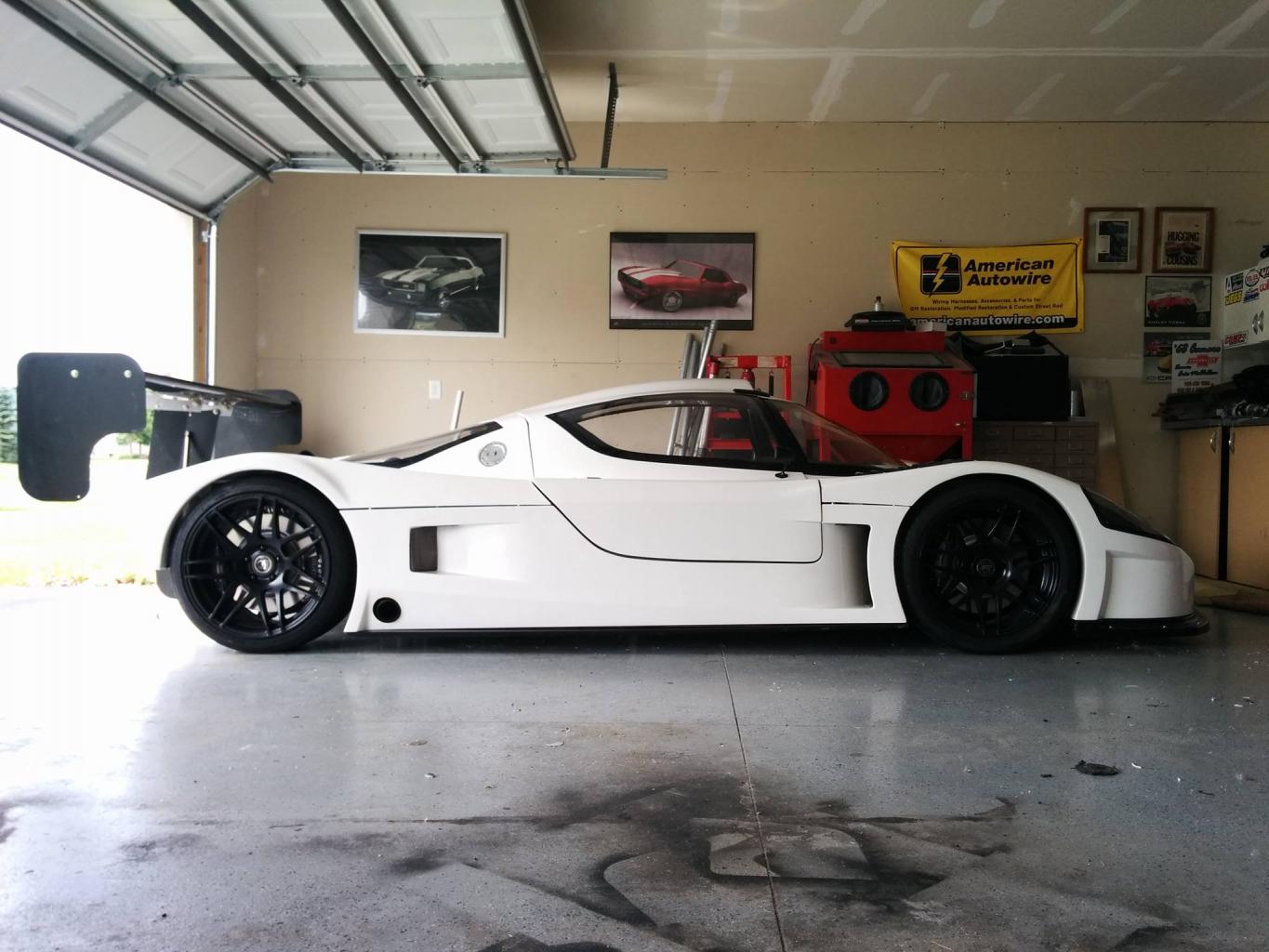

Looking at tires to drop ship for my car and there's not too many options. Anyone fit a 345/25ZR20 on their car successfully? I'm sure it'll mount on the wheel without issue, but concerned about clearance.

I run 335 19 nitto nt05s and had to carve out a fair amount of the inner side of the wheel wells compared to the 325's. Not sure about the interference with the 20's It was worth it tho. it fills up the wheel wells, looks better. Grips better than the michelin ps3's imho
According to the website, 335/25R20's will fit. I was hoping I could go a little bit wider, but sounds like I'm better off staying with 335's. I guess it's possible the offset for the 20's could be different and why they can fit 335's?

The advice I got when looking into tires was to keep overall tire height to 26.7" to avoid interference issues with the wheel well. I went in the ither direction and settled with 325/25/20 for my rears. I really wanted to go with non run flat tires and PSS in particular. There aren't a lot of options available for the 20" rear if you have these as constraints ;)
I imagine 325 for a street car will be more than enough from a performance perspective. May not be as wide so aesthetically not as imposing but eeeeh, 325 is pretty darn wide! One other concern - potholes! The low profile tires are more susceptible to pothole damage.

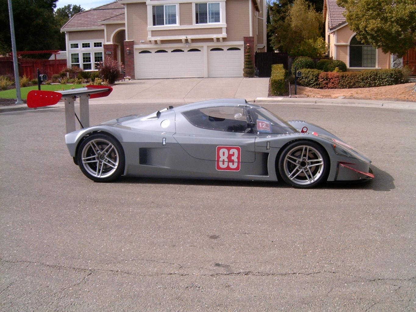

I have 345.30.19s on the rear of my SLC. They required a little body modification at the front bottom of the wheel arc. I split the flat face of the arc up about 10 inches and cut out a pie section about a 1/2 inch wide with the wide end of the pie at the bottom and tapering down to a sharp point at the top. Including the saw blade width, about 5/8s all together.
Then I clamped the gap closed and fiber glassed it together from the back. Then finished the front with body filler.
The difference is at the front bottom of the rear wheel arch. Mine is the silver 83. No other changes were necessary. I did trim the wheel opening return down to about a 1/4inch.
325s and 345s are the same diameter. All the tire tread width increase is inside the wheel well because the wheel width from a 10 inch corvette wheel and the 12 inch wide corvette well I used is to the inside and you don't use the wheel spacer either. Plenty of clearance inboard.
Check out the diameter of your proposed tire to a 345.30.19 Hoosier R6. Mine is about the maximum diameter you can use without more body modification or wheel offset redesign, or both.
Tire Rack will have all the tire size data. The 345 Hoosier is 26.8 in diameter.
