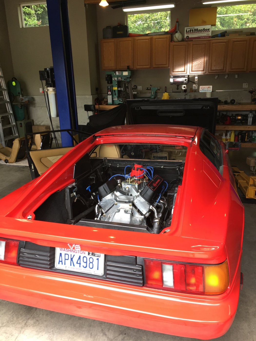

I started my SBF conversion in my Lotus esprit with a 4 barrel holley. It was simple and worked fine, and seemed to make pretty big power right out of the gate without a lot of tuning or mucking around with it. I only drove the car maybe 50 miles with the holley.

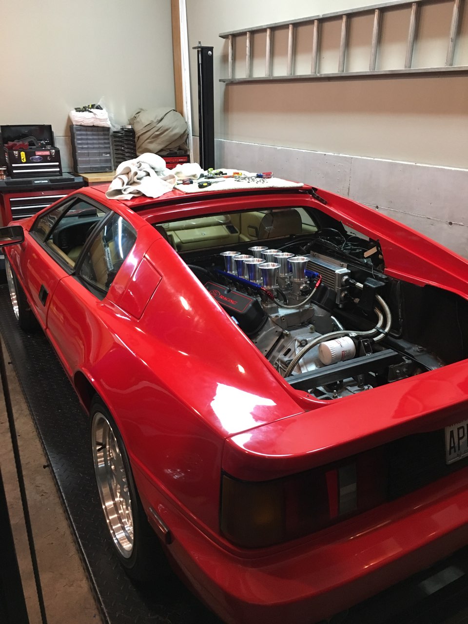

I got it in my head that it would be nice to see ITB's in the rear view, and also improve the power and driveability of the car. So, I installed ITB's. It runs well, but I don't think there's any more power according to the seat dyno. However, the car starts from cold and idles better and has a dead reliable warm idle and part-throttle smoothness to it now which wasn't the case with the 4 barrel holley.
So, net, my experience has been that the ITB's aren't about making more hp/torque, but rather improving general driveability. The AFR is well controlled across the full range of conditions, which isn't possible with the more static state of tune of the holley.

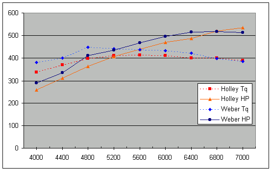

Quad Weber IDAs are very original especially in the "side to side" rather than "back to back" configuration and are more of a race type carb rather than the IDFs. You have one choke to one cylinder which means that at low rpm the carb does not get a good signal and so getting it too give a good fuel/air mix at low rpm small throttle opening takes a bit of fiddling. Also cams with a lot of overlap don't help to get a good signal to the carbs. At wide open throttle and high rpm each cylinder has only one opening to draw from. A 302 would probably have 37mmm venturis so there may be some restriction to air flow depending on what the heads can flow.
A Holley 4 barrel is quite different with one choke per two cylinders. It gets a better low rpm/ small throttle opening signal as there are two cylinders drawing on each choke. Better signal but less flow capacity per cylinder. At higher rpm however each cylinder "sees" four chokes especially with a single plan manifold with a large plenum in the centre of the inlet manifold. This is why the Holley is good at high rpm. The extreme form of this is the tunnel ram which is a tall single plane but is very much a race setup. The dual plane manifold is better at low rpm than a single plane as half the carbs two chokes feed four cylinders (two on one bank and two on the other. The carb is effectively split down the middle with each half feeding two on one side and two on the other. So at low rpm with only the primary chokes open one primary choke is feeding four cylinders and so so there is a good signal flow to the carb so good low rpm performance. A dual plane can be helped at high rpm where each cylinder "sees" only two chokes whereas with a single plane inlet each cylinder "sees" four chokes. The divider between the two sides can be cut down to allow some "single plane effect". The Edelbrock air gap manifold has a piece cut out of the divider as standard. The more that is cut away the more the manifold will behave like single plane. I use a dual plane Edelbrock with a thin open spacer to get the same effect. The inlet runners on a dual plane are longer than on a single plane which is also better for low rpm.
A Holley vacuum secondary has the secondary choke butterflies open ed by a diaphragm system and will open when the inlet manifold pressure reaches a certain value. On the double pumper Holley there is a mechanical linkage from the primary side to the secondary side and the secondaries are opened at a point when the primary side is open at a set amount. The point of secondary opening can be altered. These carbs are called double pumpers because both primary and secondary chokes have an accelerator pump system which sends a shot of fuel as the throttle is snapped open. The vacuum secondary only has pump jets on the primary chokes. The mechanical secondary double pumper types are more responsive to driver input. The double pumpers are more performance orientated and the vacuum secondary types are good for road use. You can juggle the two. I have a vacuum secondary for economical road use and a bigger double pumper when I want a bit more zip. With both piped up ready I can change over in 10 minutes.
The Holley Sniper type of throttle body works like a 4 barrel carb and theoretically should work better as it should meter exactly the right amount of fuel for all circumstances but needs a high pressure fuel setup and some dyno or rolling road time to get the correct setup. The eight stack injection setup has a much bigger actual choke area as it does not need the venturis to create low pressure to drag the fuel into the airstream. It has the same one choke per cylinder as the quad carb setup but the effective choke area is much bigger so the flow is limited by the heads flow ability.
I prefer low and midrange torque rather than high rpm power especially in a road car. My money goes with the double pumper Holley on good dual plane manifold. Cheap, easy to set up, no need for high pressure pumps, swirl pots or ecus, easy to rebuild, lots of spares available, reliable. I buy them used and rebuild them but then again I am a cheapskate!

Richard Holdener has tested a huge bunch of stuff on US V8s (his channel has a wealth of real dyno testing info in it), IR systems among them.
Have a look at this - I think this is a typical set of trends for EFI ITBs vs open plenum short runner. Obviously not relevant to carb'd IR set-ups.
