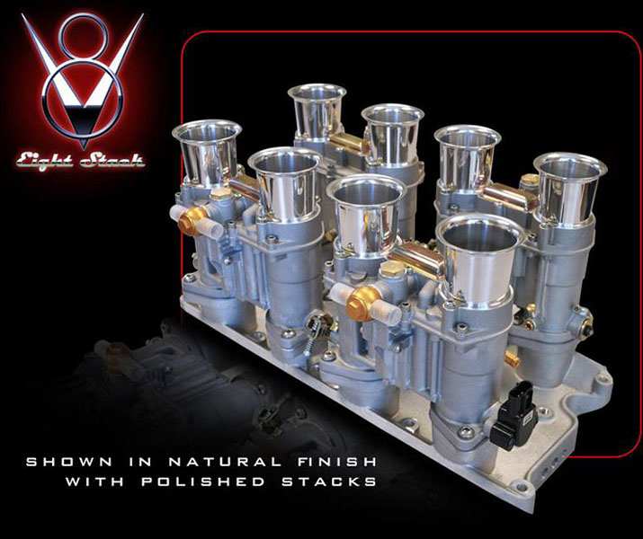

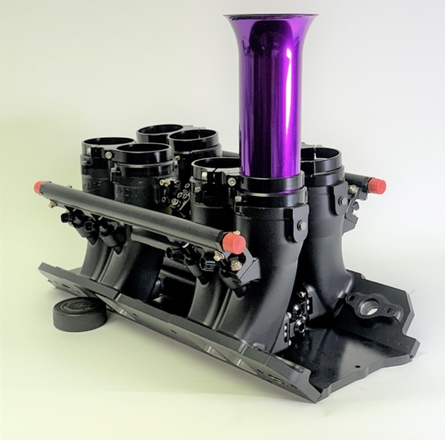

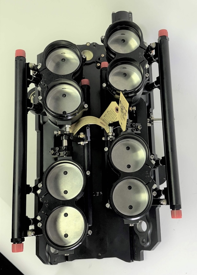

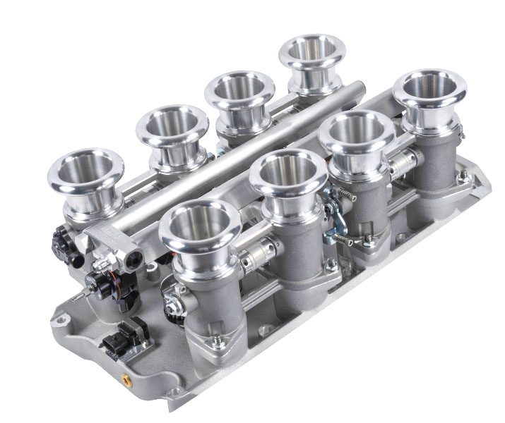

There are a couple differences in the EightStack and the TBI. The EightStack, the injectors are inside the castings that replicate the body of a Weber 48IDA. The injectors are situated above the throttle plates and inject onto the mostly closed throttle plate at idle and lower throttle openings. That presents a little more work when setting up the system and the Accel/Decel settings. The injectors are not easily accessible as they are buried inside the throttle bodies.
The TBI system has the injectors on the outside of the throttle bodies, held in place by the fuel rail. They inject below the throttle plates onto the backside of the valves. More like a modern-day injection system.
The EightStack is about 8% more in price. The TBI is slightly easier to tune. If you are after all-out performance, the TBI is the better choice. If you are after period-correct looks, the EightStack is the better choice. Either will wow the typical on-looker.
These are shot's of my current build using the EightStack. I prefer a period correct look,

Paul, Thanks much for explaining the differences. This is a really hard decision. Both these systems look awesome.
Dave Hood

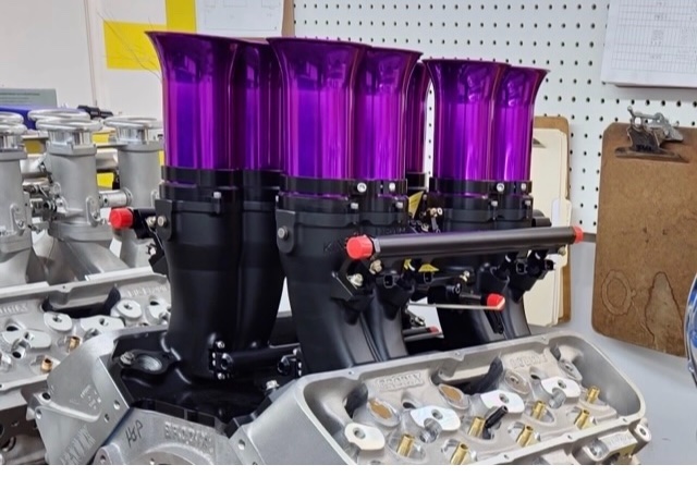

The Borla set-up (bottom photo above) is what I have on my car. It works very well. My only complaint was that the flange at the top of the trumpets did not accommodate the KN Filters I wanted to use. So I had to swap them out with trumpets similar to the top photo that have a rounded top edge.
Randy Folsom
Dave, I probably was not clear. Both pictures are Borla systems. I wonder if Prestige can order the 8-Stack system from Borla with trumpets from the EFI ITB system. Since air filters will largely hide the trumpets, the difference in looks should not matter that much. I will give Prestige a call. Which K&N filters did you use? Cheers, Randy

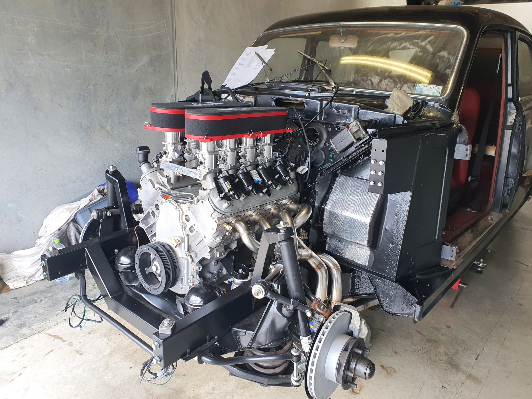

On the subject of filters, I was looking through a datalog the other day from recent fang on the motorway. I don't usually pay much attention to MAP readings because I use Alpha-N fueling but I do have a MAP sensor logged. When wide open starting at about 3k my MAP reading dropped steadily from a flat line at 100kpa to 96-97kpa at 6600. I haven't done a back to back test yet but I'm pretty confident that will be pressure drop across the ITG filters rather than losses in the manifold. At 3-4% loss of air density I'm probably giving up 15-20hp. Those mesh tea-strainers or small individual filters are probably worse - anyone measured them?
Cheers, Andrew

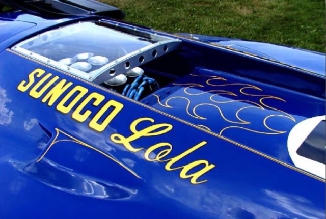

Jim, I don’t know yet. I don’t have the engine or car yet. I may have to do something like the 69 Sunoco Lola. I am holding Fran up on the car, he is not holding me up. I was supposed to take a mock-up block with my accessories down to him to verify fit or make modifications to the tub. This was in January. I have been ill for sometime and have been back in the hospital since last Wednesday.
As for the engine, I initially contacted them August 24,2023. It wasn’t until December that I got a estimate and sent them my deposits. Every manufacturer takes forever to get products from. It was 4 months to get the block. Then once it was received and the bores measured it’s approximately 12 weeks for custom pistons. I just ok’d the print for Moroso to build a set of one off custom billet valve covers and custom oil pan. I don’t know if the cam has been ordered yet. I can say that Kinsler was very efficient at building the EFI. I originally wanted Hilborn EFI. I’m glad that I didn’t buy that. Holley bought out Hilborn and made a big todo about their unit. Less than 3 months after them buying them, they pulled the plug on the whole deal. Brad at Kinsler is THE man to talk to on their unit. Constant communication between Prestige, myself, and them.

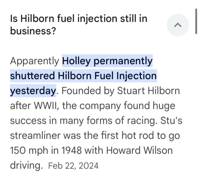

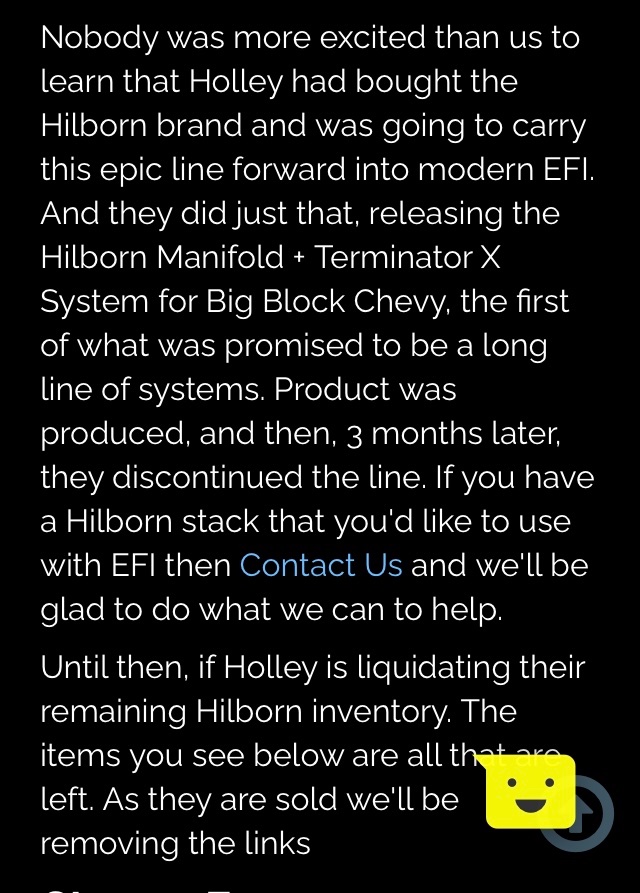

Hi Brian, can you expand on the Holley/Hilborn comment? Are you saying that they have stopped development and product support for the EFI-R range? Cheers, Andrew
Brian Kissel
Hi Andrew. Yes, according to everything I have read Hilborn units are no longer available. I think there was (4) retailers that bought up the remaining inventory. One of them I contacted said there inventory was gone as well. Andy Starr was the man behind the Hilborn EFI and may still have inventory. Holley no longer supports them. You can reach Andy here.
I was disappointed that I didn’t get the Hilborn unit, but glad I didn’t buy it only to find out they pulled the plug.
Regards Brian
