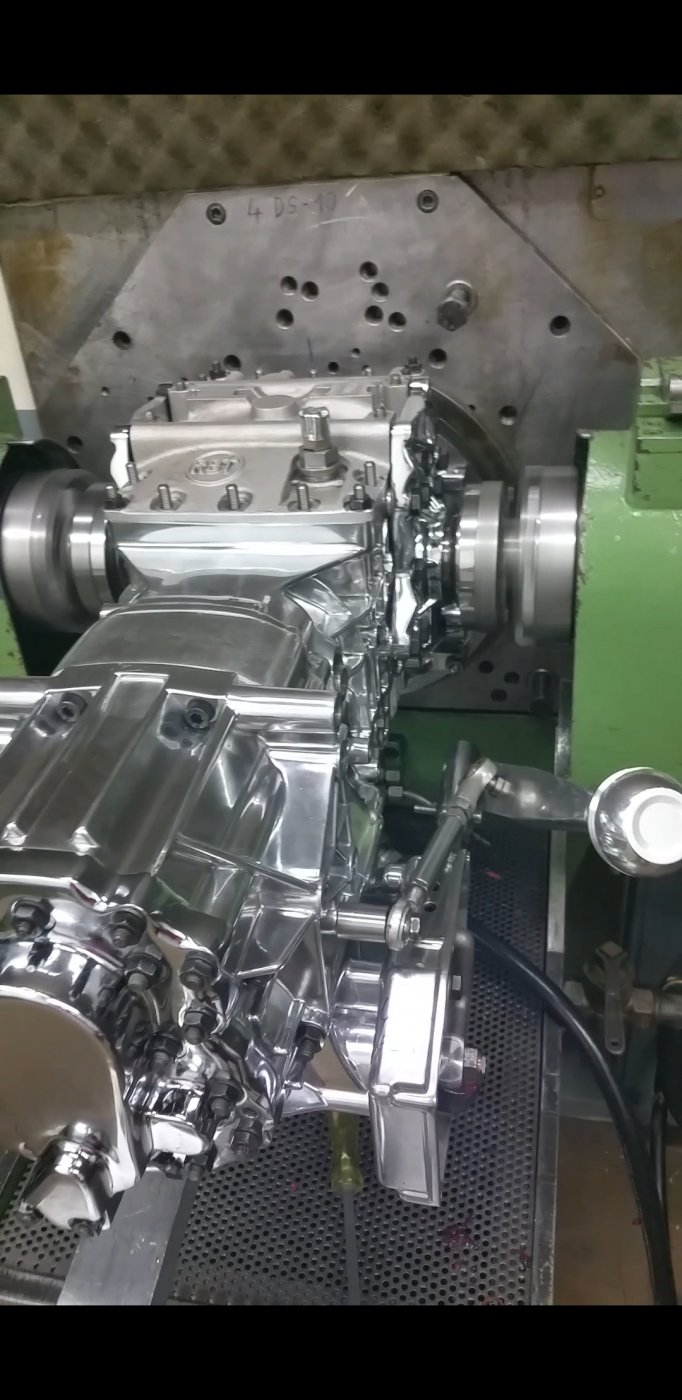

Just few update of my wip.
I finally aborted the rbt option and decided to start with the Quaife QBE62G.. few days ago I finally requested a quote to Quaife and unfortunately (or da I have to say "fortunately") they told me the gearbox has been retired from the market due to a technical review. It would be ready not earlier than 1 year. Obvioulsy they told me not the reason.
Anyway I decided to start again with a ZF. Maybe I have found a Pantera gearbox.
Does anybody can tell me where can I find different gear ratios?
Furthermore, which modifications do I have to apply to rotate the gearbox? (i.e I need an inverted diffs).
WRT the differental : do I just have to assembly the differential rotated or do I need a different one?
Where can I find spare parts? (in europe if possible ;-) )
Thanks to all of you
The RBT 6 speed, is the same gearbox that is used in the Saleen S7..
It offers wider gears, a hand cuff between 1/2 and the remainder of the gearbox.
It is 50 mm longer that a 5DS26.
And is called a RBT 6..
It was also installed in the Shelby Series 1 car..
We have parts to build them..
But have a limited number of ring and pinion ratios at this time..
