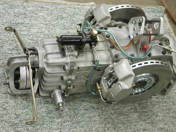

I was trying to rebuild a gearbox by myself using a modern one with a new case but the CP box layout of the ZF is so narrow that I cannot replicate.

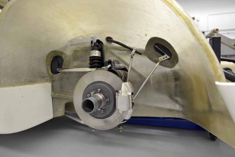

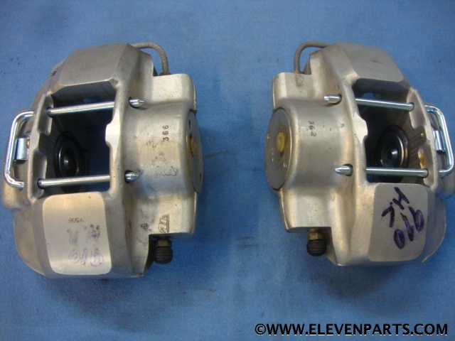

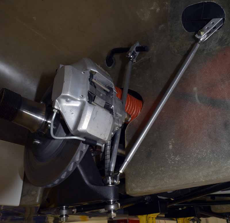

The caliper brakes you are looking for ( from the pic you posted some day ago) is effectivly a Race ATE brake but not at all the ones fit onto the GT40 ...... Just look at BG site and you will not find similar ones
In fact they are ATE "germany" from the 65's done( may subcontracted by Girling????) for Porsches and some few others race car ( look on the pic of a rear 908 Porsche suspension)
Those calipers where initially fit on the 911 RS and then onto the Le mans prototypes 907 and 908 ; they are now extremly rare and very very expensive ( 4 times BG calipers !!) when you find a pair on auctions
There was time ago a german Porsche shop selling some at crazy prices and they sold evry part they had !!!
The reason is ; many collectors racing with 911 porsches and updating their car to RS model had to replace the steel cast calipers by those ones
in order to get FIA papers !!!!!!
On the 911 R they where "pressofuzioni"in aluminium , on the 907 and 908 they where magnesium
Early ones where 2 pistons , then they change to 4 pistons
Some time ago some friends did a CAD drawing and have them machined from "billet" and the project failed due to the lake of accurate drawing and eventually machining !!!!! waste of time and money.....
Hope this helps

I have few constrains to deal with ... syncro + 6-speed + "outer case style"...
The quaife is a very good starting point but I also need someone to modify it as for 6-speed but I don't have any supplier.
The best option I have is RBT who is already building this 6-speed gearbox ( I need something reliable).

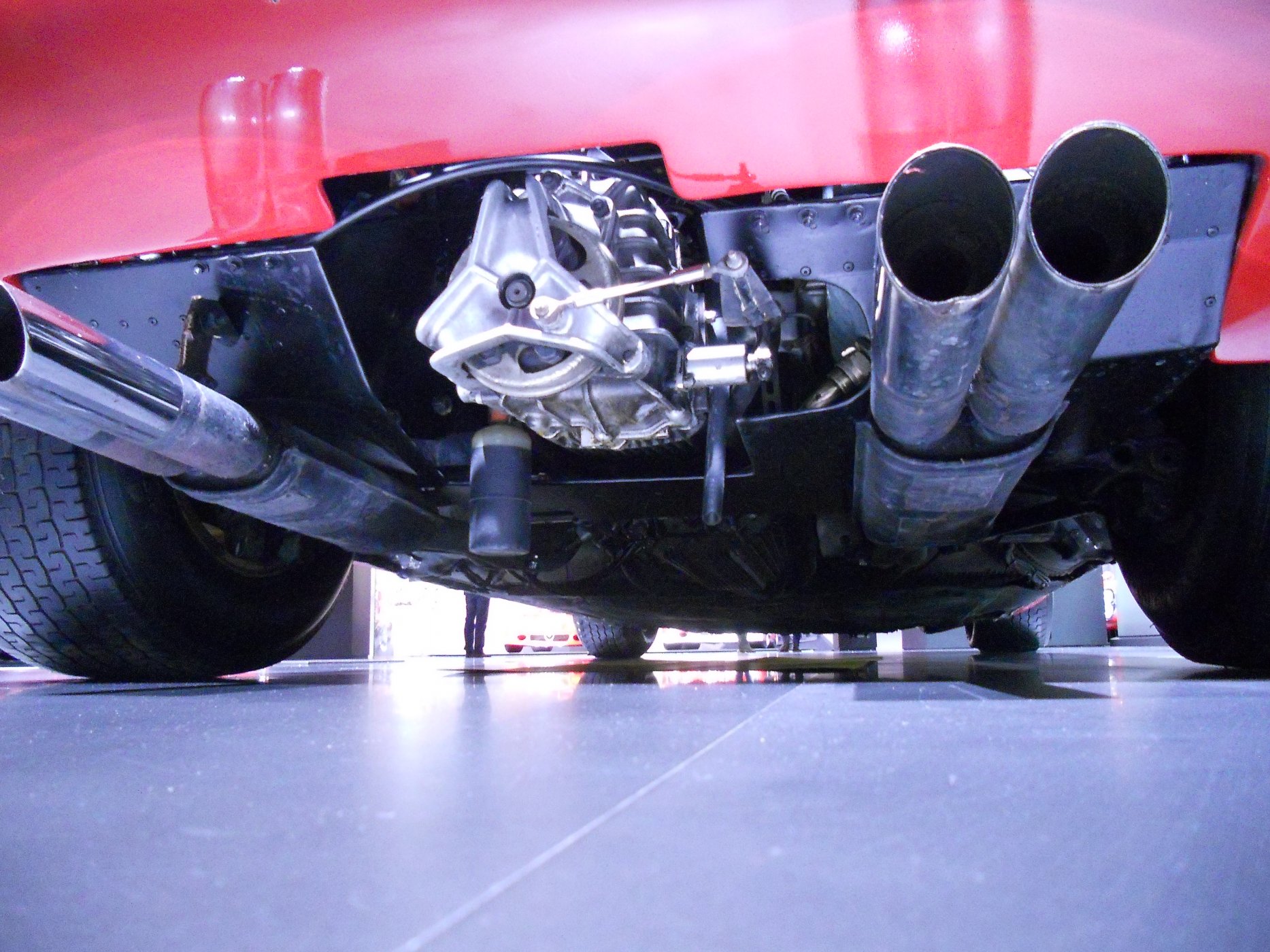

This would be just the starting point because I need to modify the C&P cover in order to have a Colotti style bracket and...Last but not least... I need to modify the rear cover in order to have an external driven shaft... like this one... (if I will succeed in)...

280x20 vented discs are very easy to find at every brake manufacturer site ; then do you proper aluminium bel to suit gearbox out flanges
There is a solution to make some acceptable replicas for those brakes ; you need to find either 944 or Peugeot coupé caliper brakes ( they are aluminium 4 pistons but the shape is very similar to those ATE calipers ) then taking of the black painting and doing some nice aluminium polishing those Brembo brakes gives an surprising good result .
the bores on the ears being 90 mm so very close to the 89 mm spacing on the ATE is another good point
