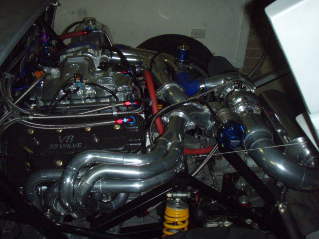

We will shortly see how a GT40 (RF) with approx 1,000hp will handle the turbo power. At the moment the motor is pushing 587hp with only 5psi boost and 16 degrees total timing. Once she is run in (about 1000km's) we'll push the boost to approx 22psi and as much timming as we can. The motor is a 4.6L Mustang Cobra with all forged internals.
