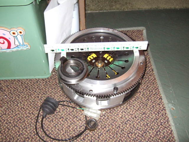

Thanks for verifying that I'm on the right track! Just in case anyone is interested, here's my setup.
Best Regards,
Al

Hmmm, looks like I have some sorting to do. I have the flywheel but nothing else. Not sure my flywheel looks like yours either. What is the piece at the bottom of your "sandwich" with the cut outs? Is that the flywheel?
Alex Hirsbrunner
Hi Ron,
The whole thing below the ring gear is the flywheel, the pressure plate is sandwiched inside of it. Pretty hefty piece. Here's a side view that might help.
Hi Fran,
Thanks for the tip.
Al

Holy sheet.
That bottom piece isn't all one piece is it? Looks like a steel flywheel, then an ally spacer with the holes cut in it.
Why can't it just be normal?
Alex Hirsbrunner
You're right Ron, it's three parts: traditional flywheel, hat and ring gear, but the aluminum hat and ring gear are almost as heavy as the flywheel.
Al

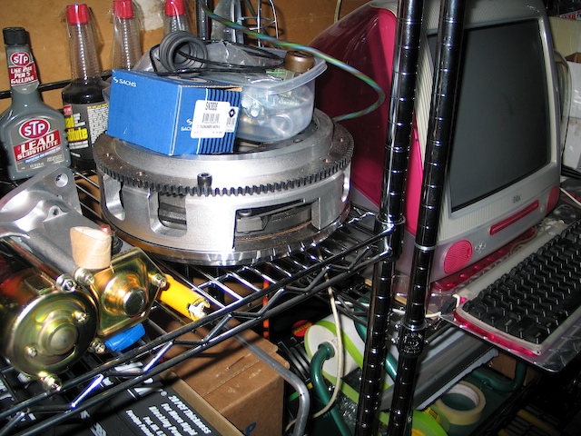

I'll get some pics of the one I got too, I suspect it is similar to Al's as it came from Roger too. It was supposed to have been a lightened version but I'm not sure.
Sandy
