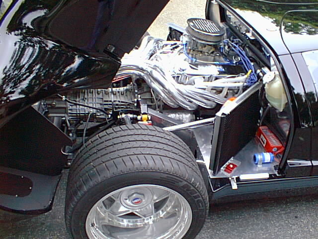

Bill, I had talked to Bud Jones (40Bud) about this and he had mentioned 3 3/4 lb. My system runns great now with 2 1/2. The only difference between my system and all the other standard GTDs is the size of the condenser (14 X 18, in the rear). I have the same evaporator, drier and compressor (Sanden 505).

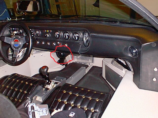

One other thing, I used a Vintage air round vent for the center section of the dash. If you guys are interested, I will give you the part number. It is very easy to install and it does not detract from the "look", I think.
The only thing I am not too crazy about, is I used R12 /ubbthreads/images/graemlins/crazy.gif /ubbthreads/images/graemlins/crazy.gif
I have attached couple of photos regarding the Vent and the condenser.

Farhad,
I'd appreciate the vent part #, as well as who manufactured
those pipes. That exhaust looks awesome! /ubbthreads/images/graemlins/cool.gif
Bill,
Thanks,, The part number for the vent is 49354-VUL ($10). You can order direct from Vintageair (even though the website mentions distributors). They also have billet round vents,,$$$. I am cheap!!
The pipes are standard (none crossover) GTD pipes. They are ceramic coated. Got them as part of the kit.
