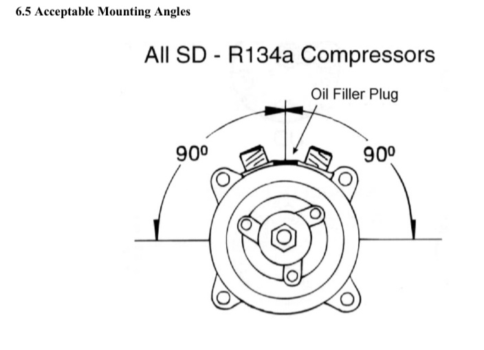

The Sandon site states that the compressor must be mounted with the oil fill plug at the top.
( above 9 o'clock and 3 o'clock ) article 6.5 in there manual. click on post #6 info above.

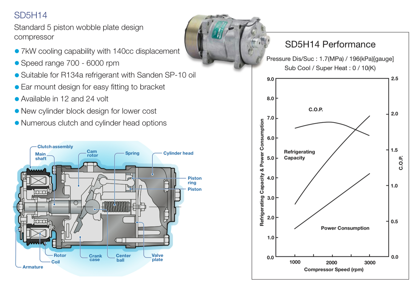

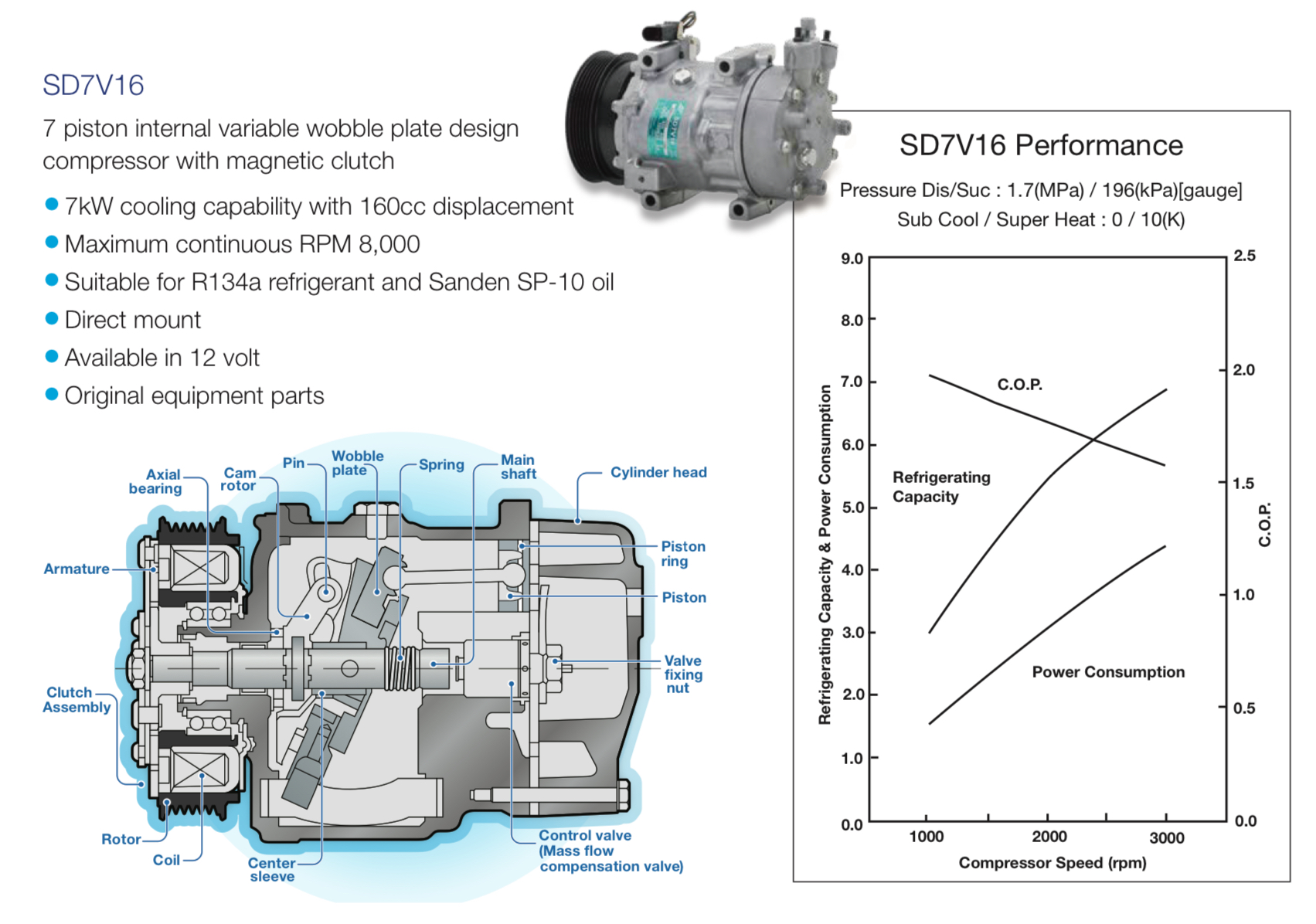

I went on an excursion down the WWW Rabbit Hole and found a good source of information here;
Starting on page 9 it shows many of the SD prefix compressors having a sump. These are older designs and many of the newer / smaller compressors don’t show any reservoirs in them.. Some even suitable for use at high RPM (8k+)
Good reading !!

Hi Randy,
What is the implication of the sump/no sump distinction? My compressor came with paperwork saying the “oil filler port” must be placed no further down than horizontal or it would lead to compressor failure yet I can find no such hold on this model. That paper was marked “SD508” but mine is the mini SD7B10. I really don’t want to spend forever trying to shoehorn this thing in somehow so it is not upside down, especially as other members here have reported no issues running the same compressor inverted.

Here’s the service information that covers your compressor -
Sump vs Crankcase
A sump is typically where a volume of oil would be stored for an oil pump to pick up and circulate.
A crankcase is merely the housing where the compressor’s pistons / crank (if applicable) / Wobble Plate, move within…
I did not find any drawings of your particular compressor that indicated a sump - but then it just may not have been called out.
All of Sanden’s documentation seem to indicate that the fill / drain plug be mounted within the 9 to 3 O’clock range. Frankly, I’ve not seen this before and have always mounted the compressor where it was convenient and out of the way.
Still - if you have the option, I would mount it per Sanden’s documentation.
