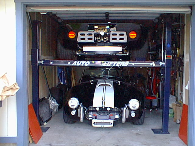

The single most valuable item in my garage is the lift I installed last year. It is a two-post, clear-floor, 10,000-pound model from Autolifters. It has been absolutely invaluable in my projects, especially the Lister replica I've been working on. It is a little bit of a hassle to get low cars on it--they have to be lifted with a floor jack first--but the ease it adds to what would normally be unpleasant tasks (transmission install/removal, oil pan removal, even bleeding the brakes) more than makes up for the time spent getting the car on it properly. Drive-on, four-post models would be even more convenient in that respect, but I like having the wheels free so that I can remove them if need be for brake work, etc. while the car is on the lift.
