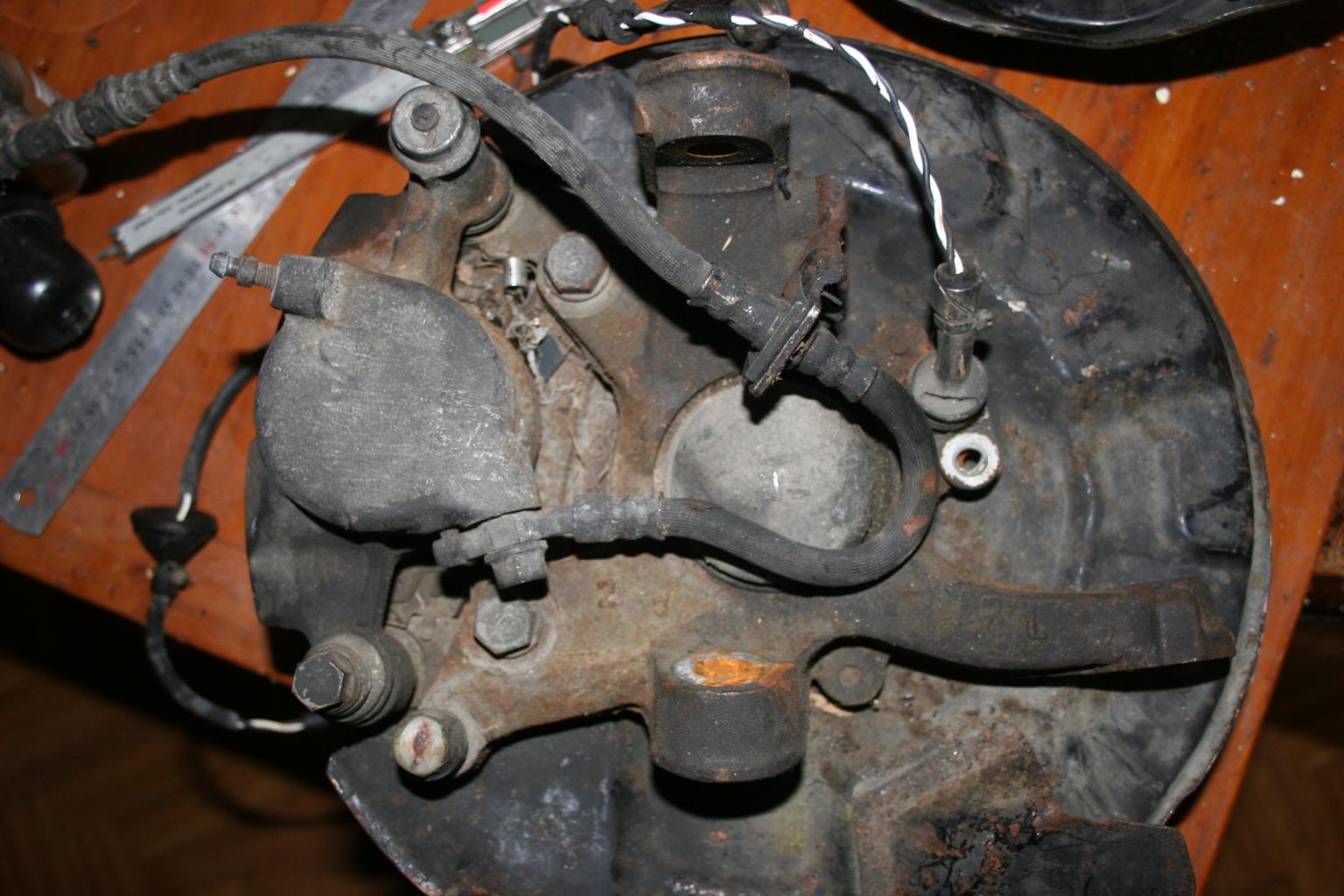

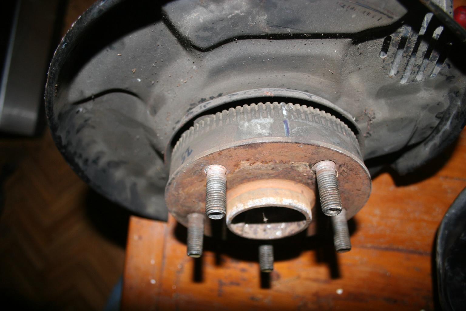

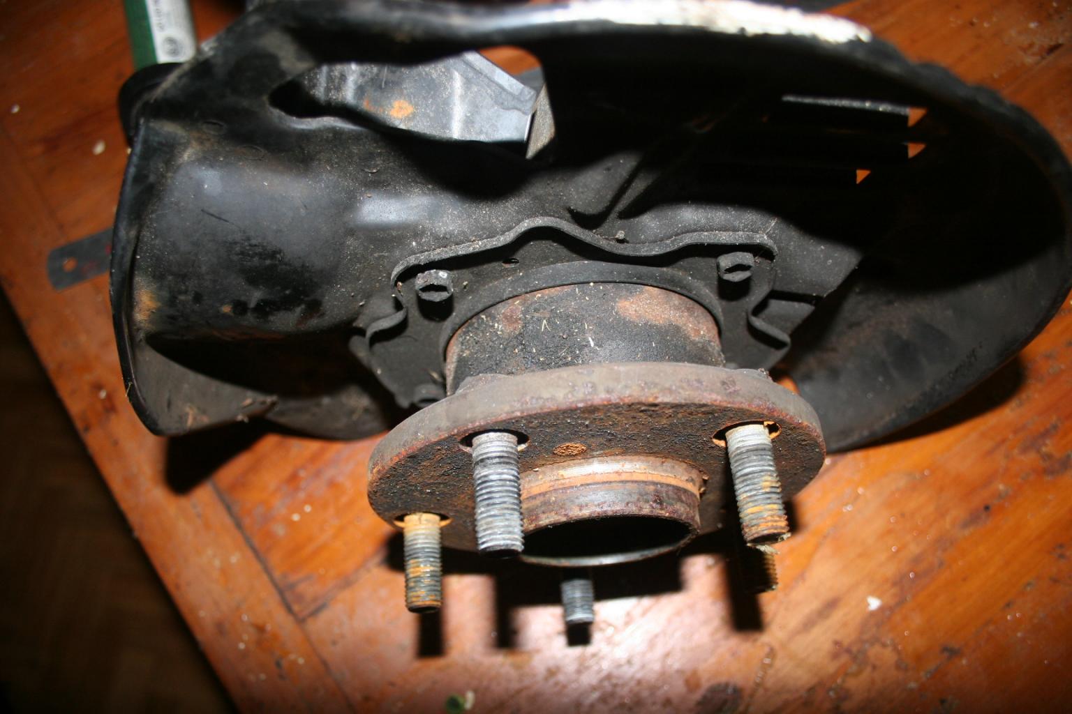

Hi guys thanks for the replies, I have included some pics the first are the Supra the second the Soarer, the two uprights over all measure within a few mm of each other, but the biggest difference is where they put the stub axel relative to the kpi viewed from the inside, the Supra axel centre is about 15mm in front of the kpi, and the Soarer is 10mm behind, so given the bottom and top suspension arms stay in the same place this would have a major effect on the wheelbase, this is not a problem through as the bottom and top arm can be moved to correct that.
I originally measured from the centre of the axel to the pivot on the steering arm and the Soarer measured 140 mm and the Supra 110mm, but I wasn't till I put the two side by side to take the photos, I realised the distance from the kpi to the steering arm pivot was identical at 130mm so there is no advantage to use the Supra upright to get quicker steering because relative to the kpi they are identical. so I think I will make life simple and just use the Soarer upright. I just wish I knew why the axel is in a different position.
