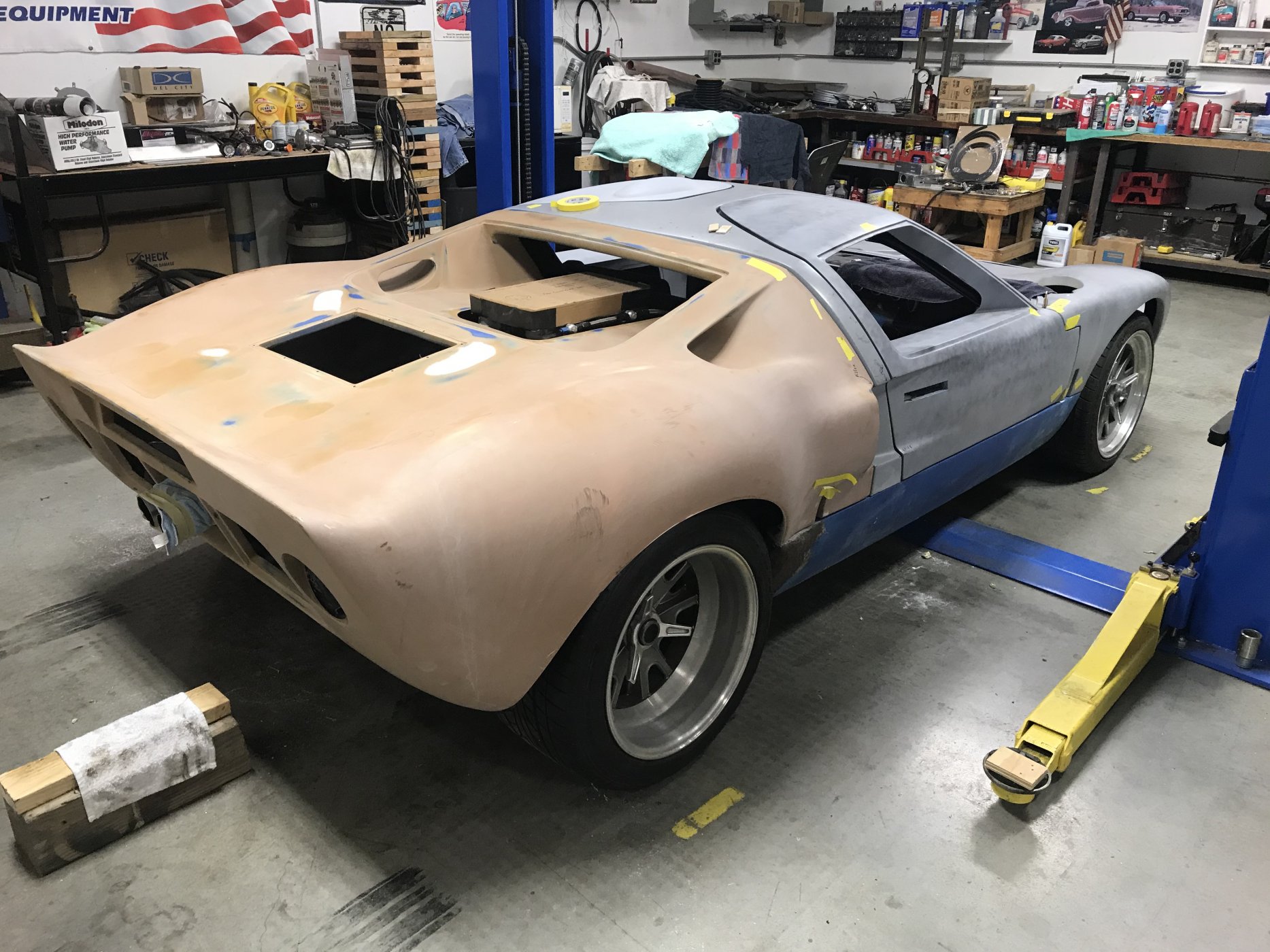

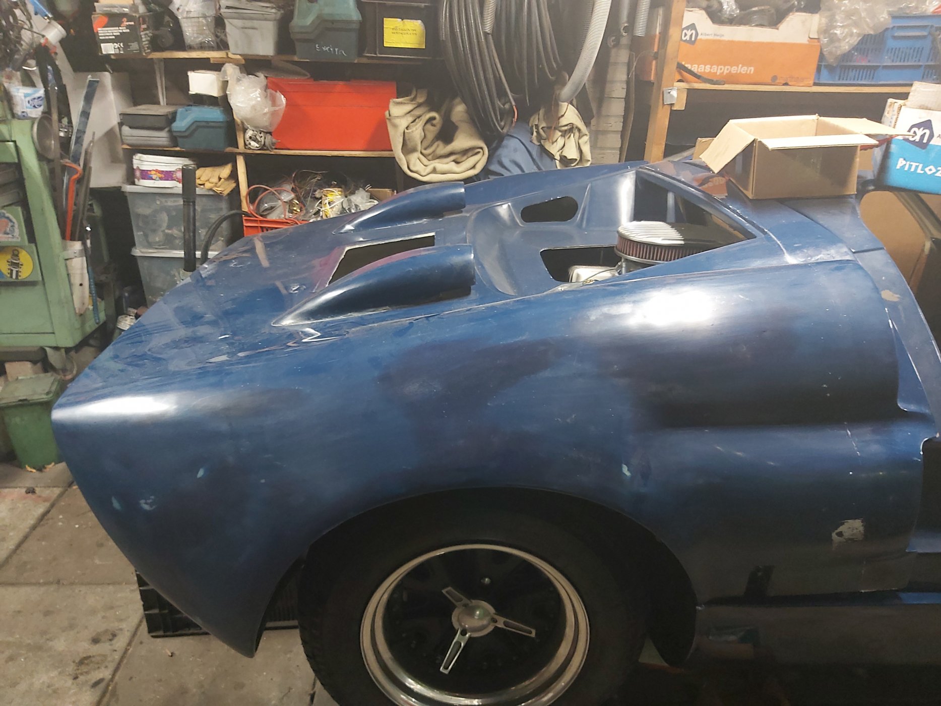

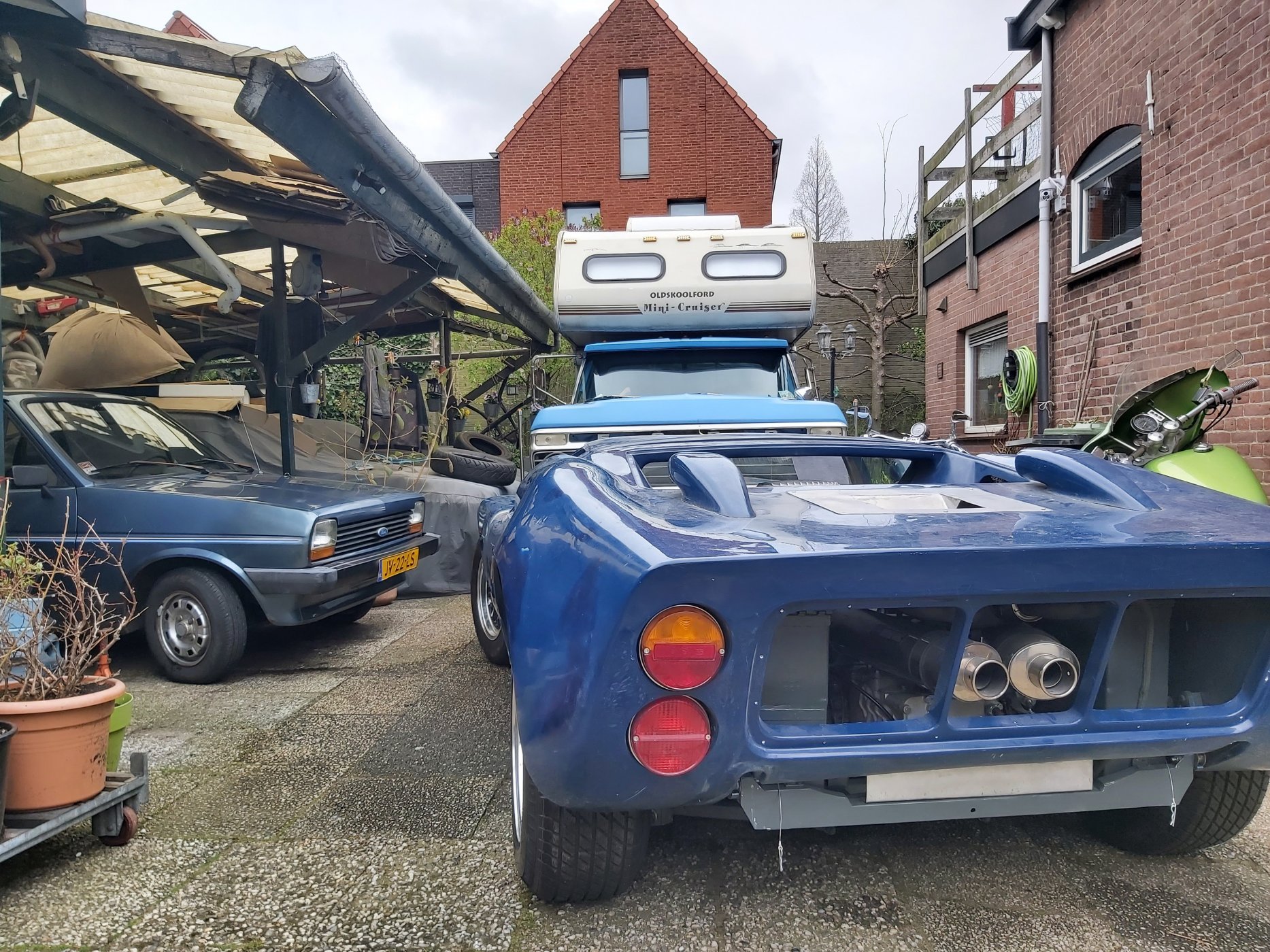

One of the things that bothers me about this rear clip is the duck bill . It is not really correct .. or is it? Seems to me this looks like a modified MKI rear clip. The more I look at it the more I go back and fourth on my dislike of it. Which begs the question, how many variations of the MKII rear clip/front clips are there? I prefer the " rear haunches" of the recognizable MKII rear with the flat extension plate.

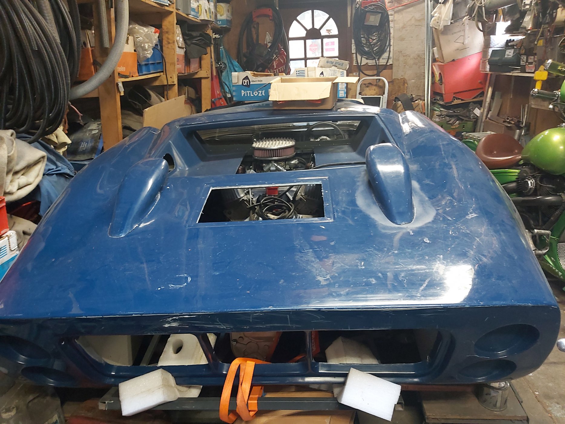

I was told that the rear was splashed off an " original" MKII ( heritage unknown). Here is an image of the rear clip - in process of clean up.

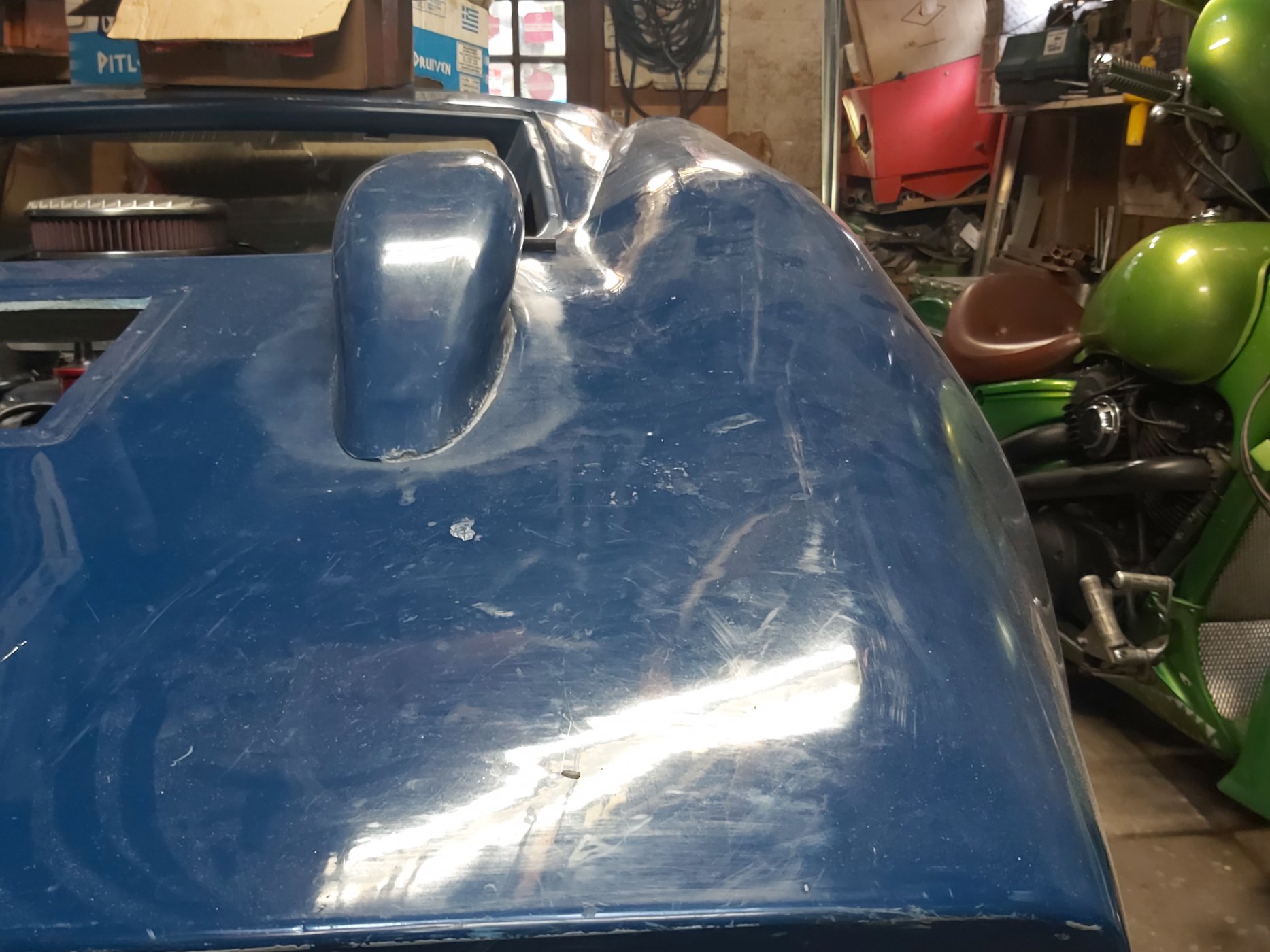

Your clip does differ from mine. Supose to be a GTForte clip.
It is hard to tell from the color/angle, but it looks like the area behind the scoops is nearly flat. Is there a small rise in the surface as you near the side (fenders if you will), rounding it out. If you look at mine you see pronounced "bulge" in that area. I do see many differences in the the two clips.

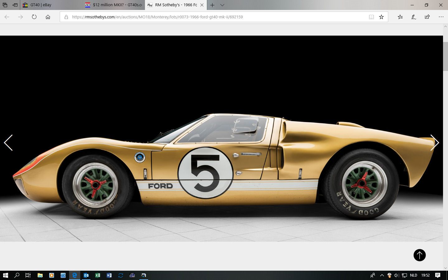

In basic, a mk2 has a mk1 front clip with bigger wheel humbs and a deep vent with and without splitter.
Ford lowered the mk2 up front to get more downforce, and to create the required wheel clearance they raised the front wheel humbs.

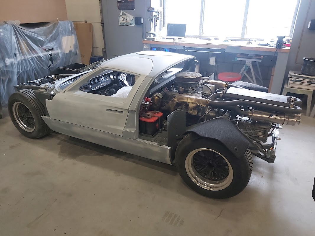

I am using a mk1 spider as it came with it.
Spider from a mk2 differs also.
Arrow points out a line that goes into the mk1 upper scoop. On a mk2 that line does not excist (see previous P1016 pics)
Where that line goes to on a mk1.

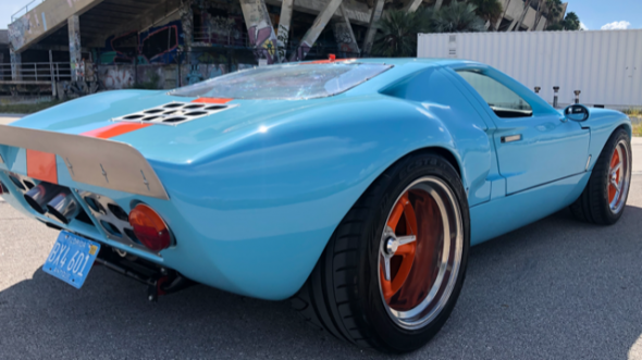

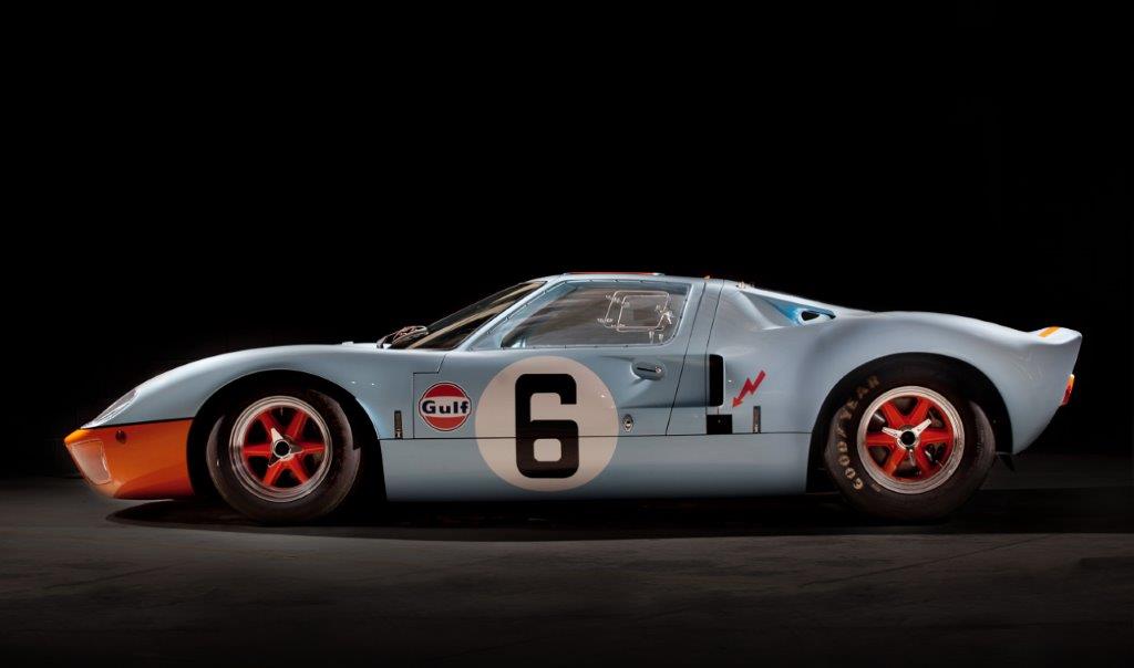

The swage line on the 'spider' & door top is not on any genuine GT40. It is a quirk of the replica market. The Gulf car above is a replica.

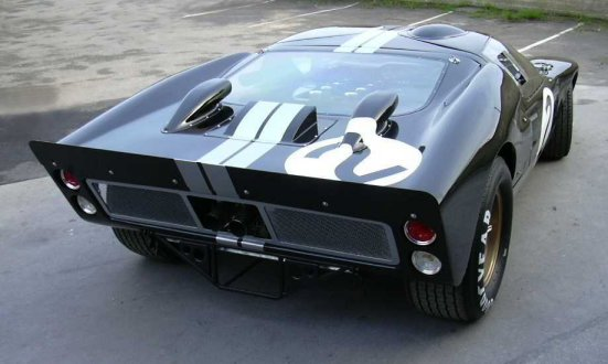

Many thanks. I see some of the details in my clip shared ( somewhat ) with the Tornado rear clip. Any images out there of an MK11 with the "duck bill"?

Both of your rear ends are modified MK1s.
The MK2 has a much deeper rear window and is straight across the top back edge.
Keith. Not sure of the heritage of your back end but its a MK1 with an extra side scoop.
JP. Yours is a GTD MK2. They used a MK1 and modified it by adding scoops and another set of MK1 tail light holes.
MK2 tail lights are much smaller and deeper.
The top side profile has a crank in it where the top scoop ends and it should be a smooth curve front to rear.
The tail lights are too large and the rear vent holes are nothing like a MK2.
Andy Sheldon, thank you very much for clarifying my rear clip heritage. very much apriciated.
Puzzle is comming toghether now. So we have a GTD body, which we never knew.
Bought as a abandoned never build project now seems to be a KVA "B" type chassis with a GTD body. Nearly finished by now.

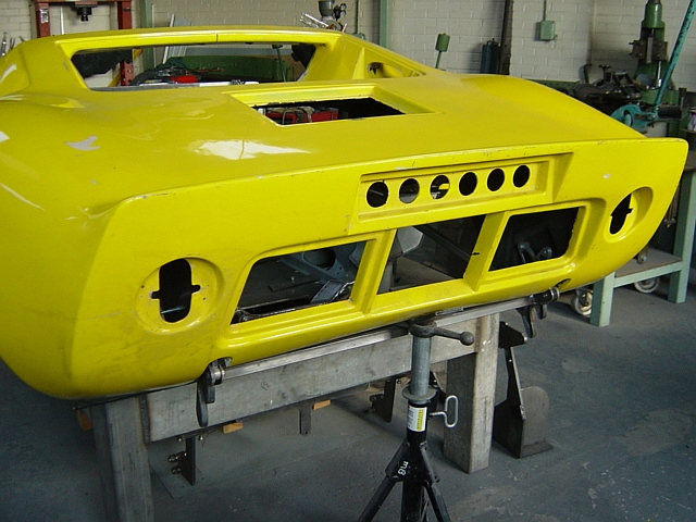

RCR rear clip. Sorry I don't have a better side view. Their body was popped off of P-1008
Doc Watson
this was sold to me as a racing spare for 1040, original with a horrid gelcoat as the previous owner used it to splash a mould.
