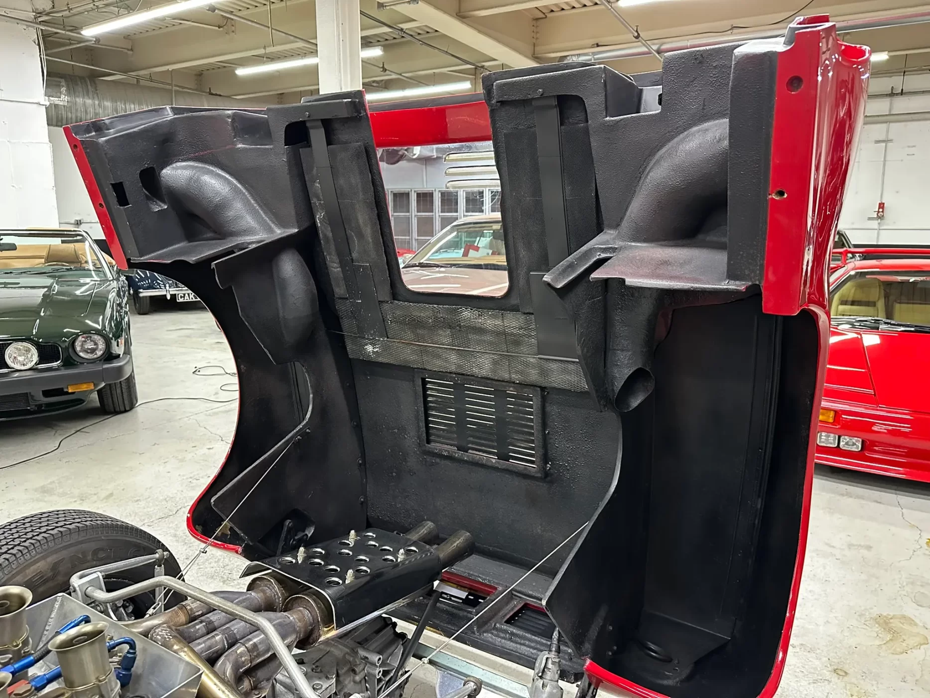

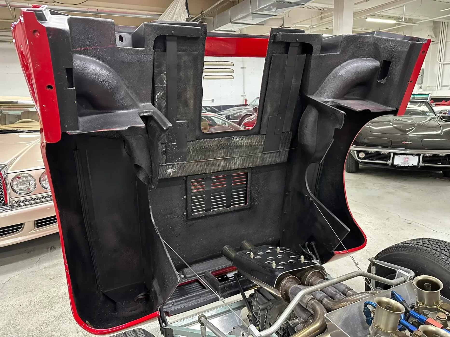

These are a SAFIR clip

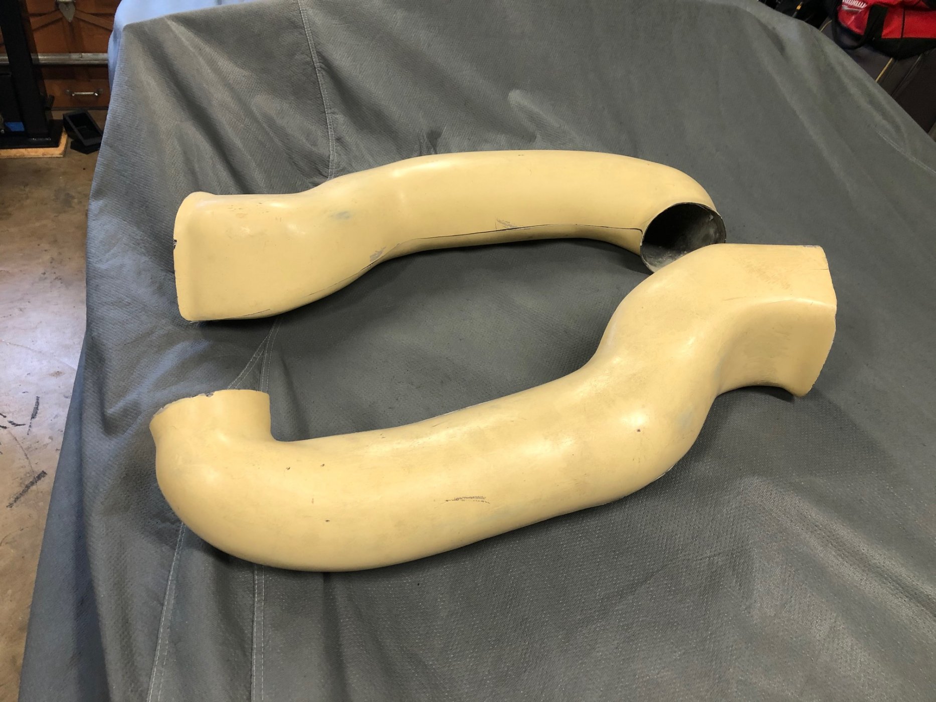

Does anyone have photos of the Hough ducts? I did find one picture of the brake duct but hoping to garner enough info to make a set for myself.

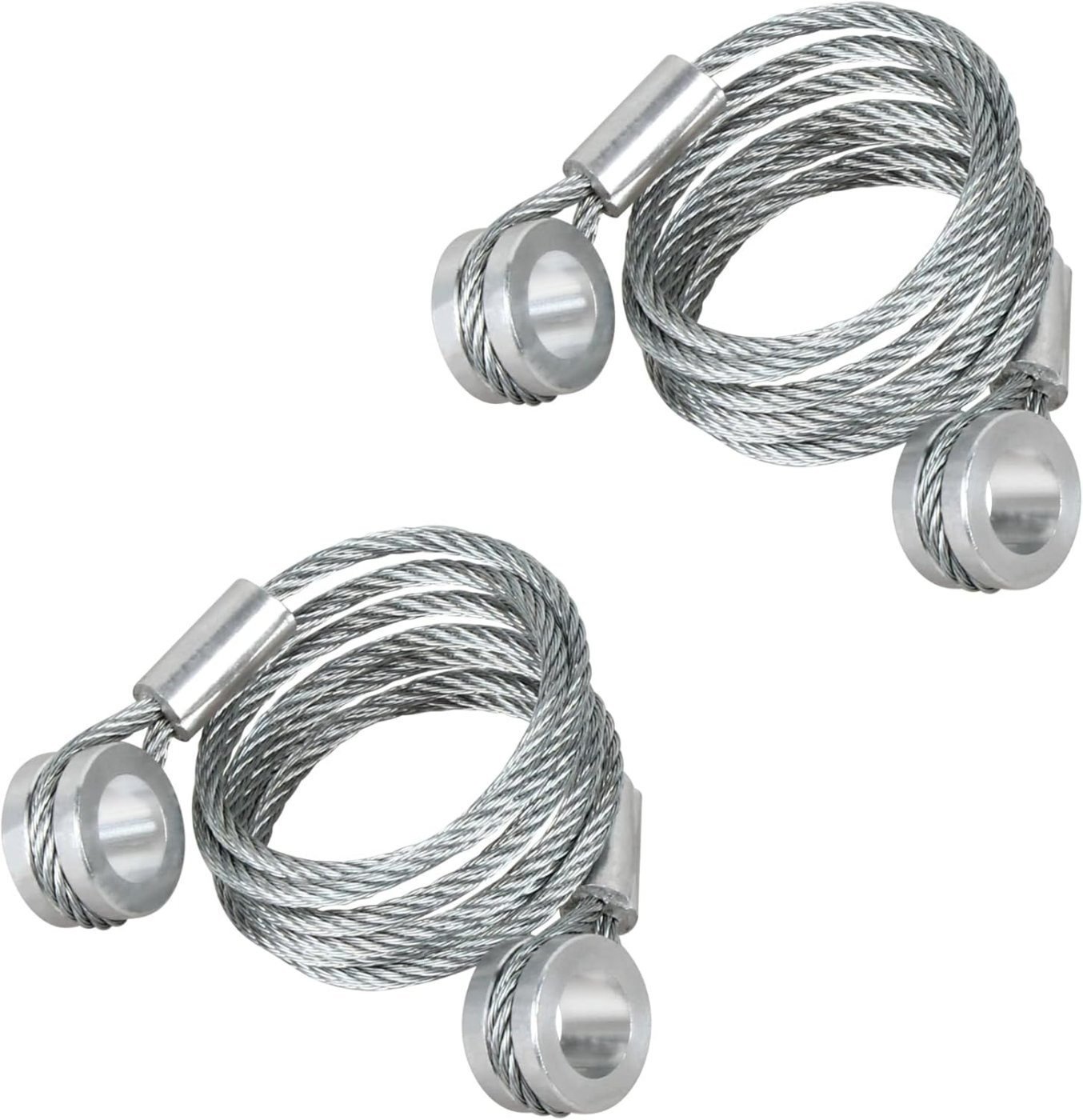

Most original and the SAFIR cars the cable unclips from the tub and stores on a tab that it wraps around, and the clip then attaches to the tab on the clam.
We have cables that are "self-springing", i.e. they coil naturally so they can stay attached to both the tub and the clam and self-store in a 4" coil so no interference. They come 31.5" and 41.5" with eyelets on each end. They are $44.00 per pair. 716.812.3938 or [email protected]
