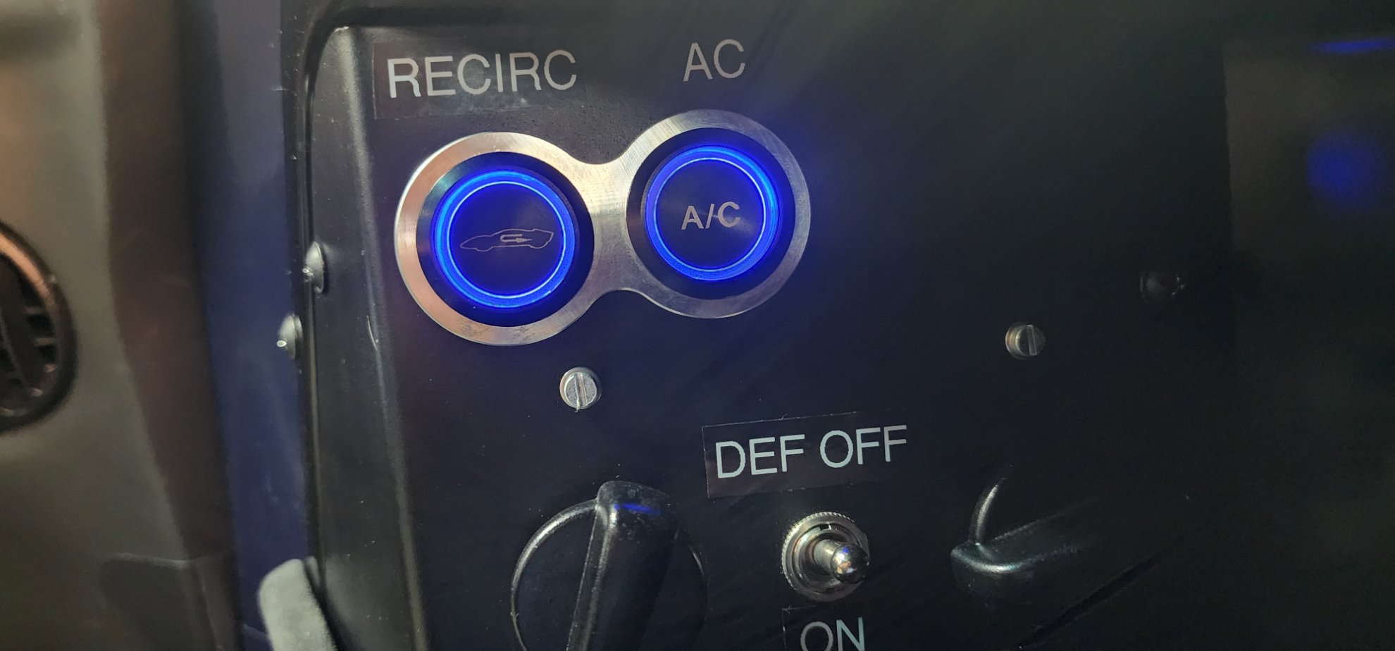

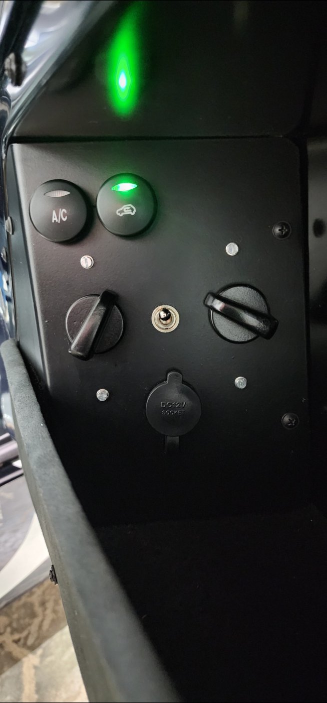

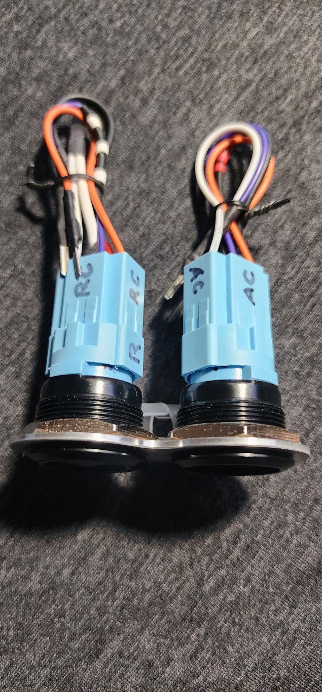

I have had these custom switches made to just go ahead and update both switches. Even had the GT40 silhouette laser etched into the recirc button.
