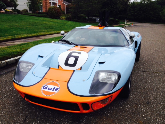

a couple of more picts with the GT40

Ah... that's where it went to! Beautiful car Kurt! Had my eye on it too. And I thought my garage was fun! Very, very nice collection of cars you have there!
