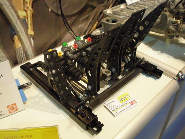

I saw this unit being sold at a UK race car show earlier this year, which is based on a pair of seat runners and I though was very neat solution.
Regards
Andy
