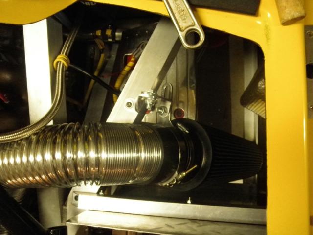

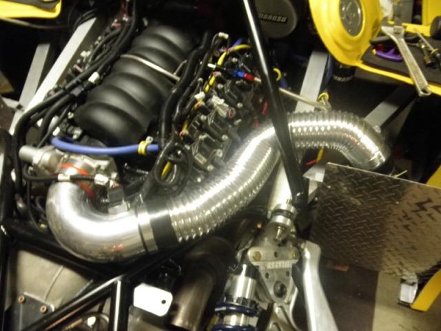

Anybody have any pics of how they're drawing air to the intake manifold from the side scoops. Car is away getting the exhaust done and we mocked it up out of curiousity (I don't have my air tube from the factory yet, and the only pics I've ever seen of it was Cam's using flexible tubing) and neither of us could figure out how the heck that would ever be possible to feed from the side scoop :confused:
I think this is Cam's car, but It's all I've got

I've seen his. I'd be curious if he ever did a back-to-back dyno without that corrugated piping - apparently the ridges in it disrupt airflow so it's the same as halfing the diameter of the pipe (i.e., 4'' corrugated piping flows the same as 2'' smooth/round tube)
I certainly hope that the flex tubing is a temporary mock up.....looks a little too 'home depot'. Would definitely look better with stainless or aluminum tubing

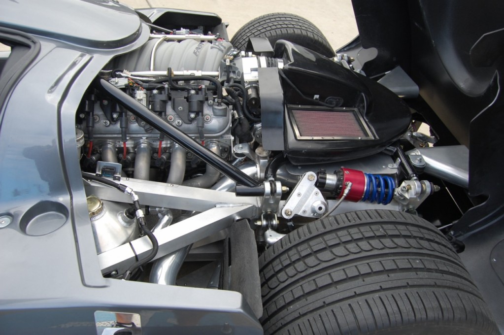

I have to angle of the air cleaner more forward to give a little more room for the inner fender.

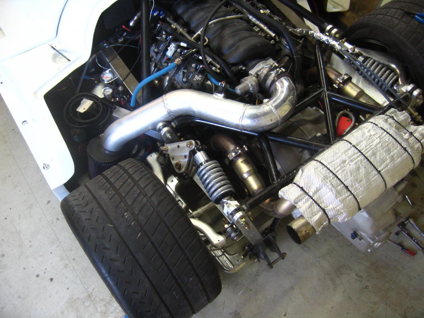

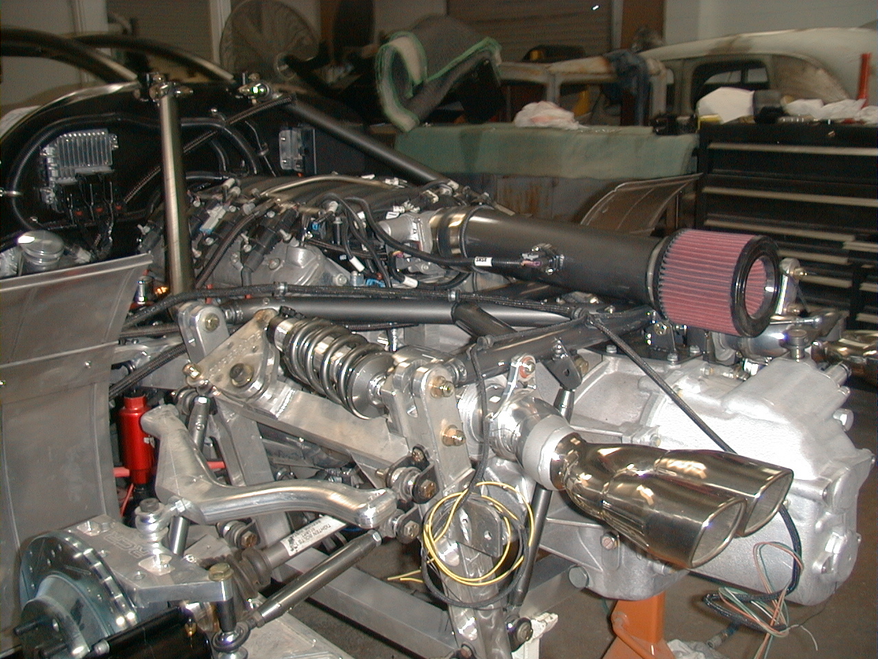

I went straight back, it involves making a vent in the clip but work great.
I can't believe that run clears the body and the diagonal cross-bar. that's what I was visualizing, but it sure doesn't looke like it can fit.
The Grey car has the engine raised due to the Albins transaxle and the whole tail section modified quite drastically.
Waynes intake will clear just fine as I am sure he has tested it....the left rear roll cage support need to be moved forward from the billet upright attachment point , to locate on the aluminum chassis rail though...

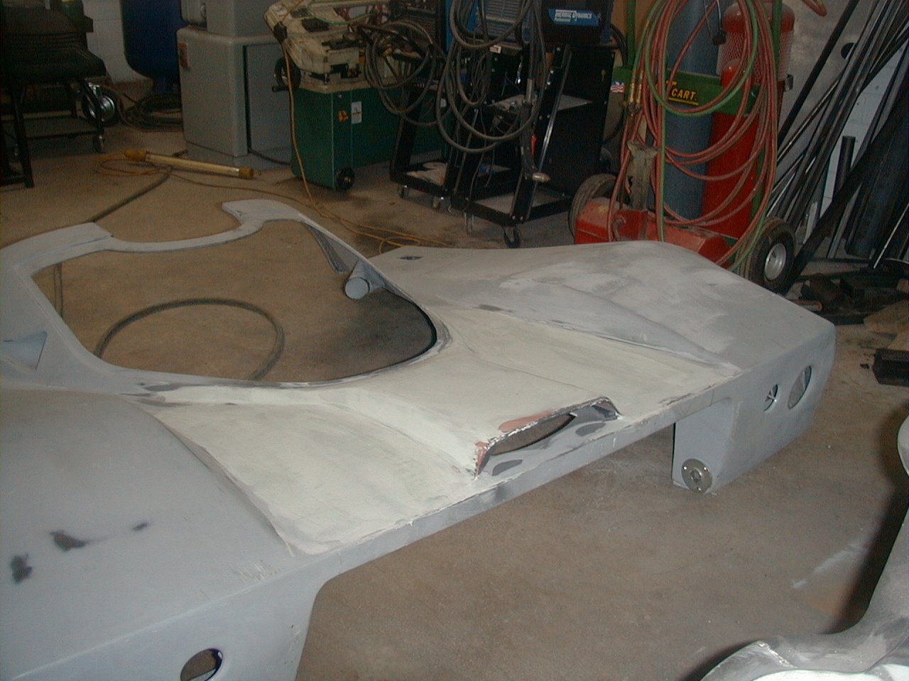

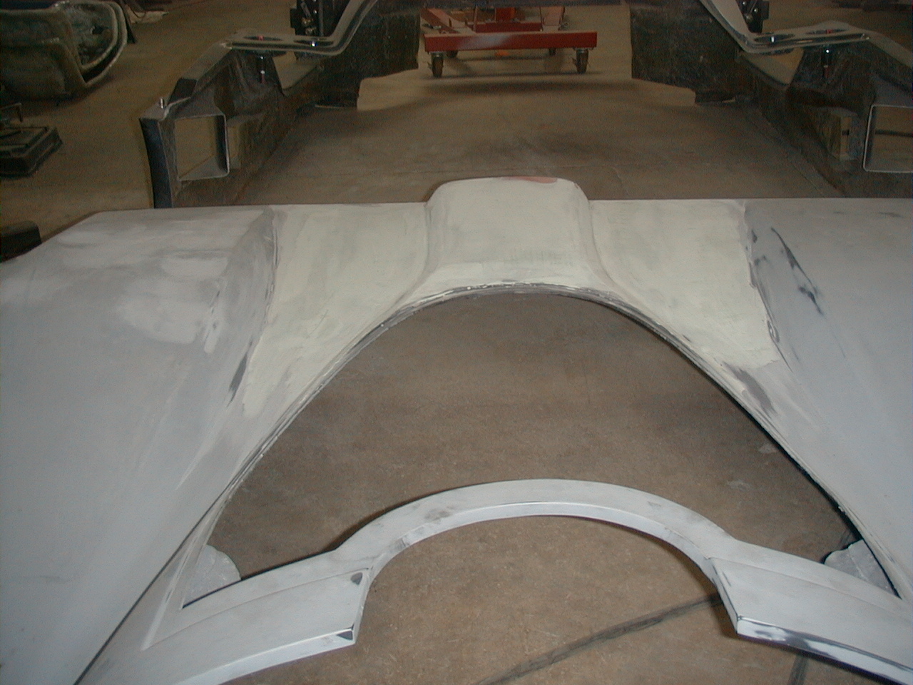

If you go to my build it shows the layout of the intake and the modification to the tail to allow the cool air right at the filter, it also helps to get cool air into the motor compartment back where the exhaust runs, it may not be as aerodynamic as the one above but it does work
Ooooo, I see now, you've relocated the driver roll cage mount!
I've been looking at the picture for days wondering how the heck you were going to clear the brace and it finally just hit me, haha. Yea, I'm slow, sue me :laugh:
Are there any concerns with brake dust and other road/track debris? Seems like you would be in for a new filter every thousand miles...
