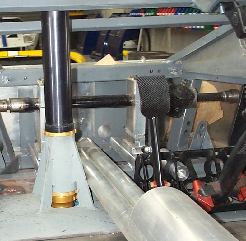

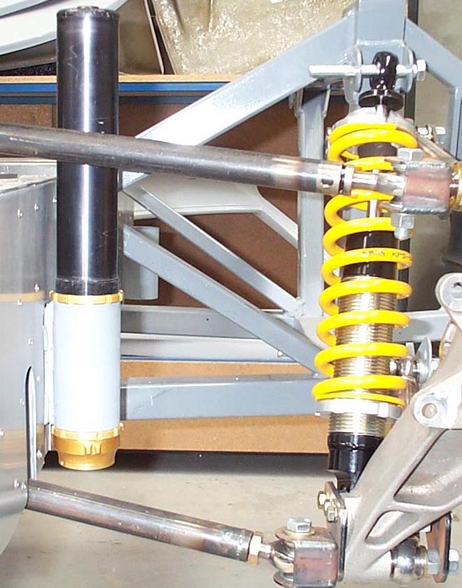

I have a set in our race car. I will ask Sam to post some pictures on Monday. We used three jacks, one up front and two at the rear. The great thing is that with the removable allignment bars and left and right handed rose joints we can put the car in the air and do suspension changes in seconds between practice sessions or at least when she is on the track we will (still a few months away from her maiden flight).

Attached are photos of the air jacks front and rear. All bracketry is welded to the chassis.
