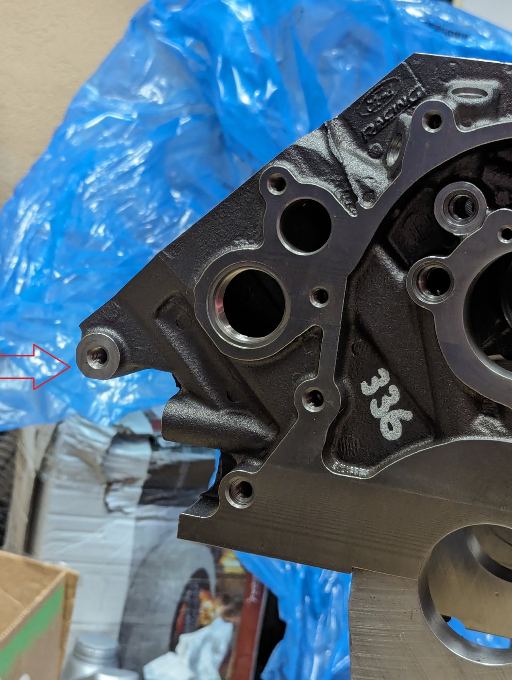

On the face of the Ford BOSS302 block is a 3/8-16 boss, located on the passenger side, below the cylinder head. Most all alternator mounts I've seen use the holes in the head to mount the alternator/bracketry.
Any tips on what this boss was used for so I can search out the bracketry associated with it. It appears it IS NOT cast into a 289 block and a Tall (351) block would have it in a different location.
Some have reported it was for a smog pump/bracket but those also appear to be mounted to the face of the head. The only thing I've been able to find a picture of has a ground strap attached to it.

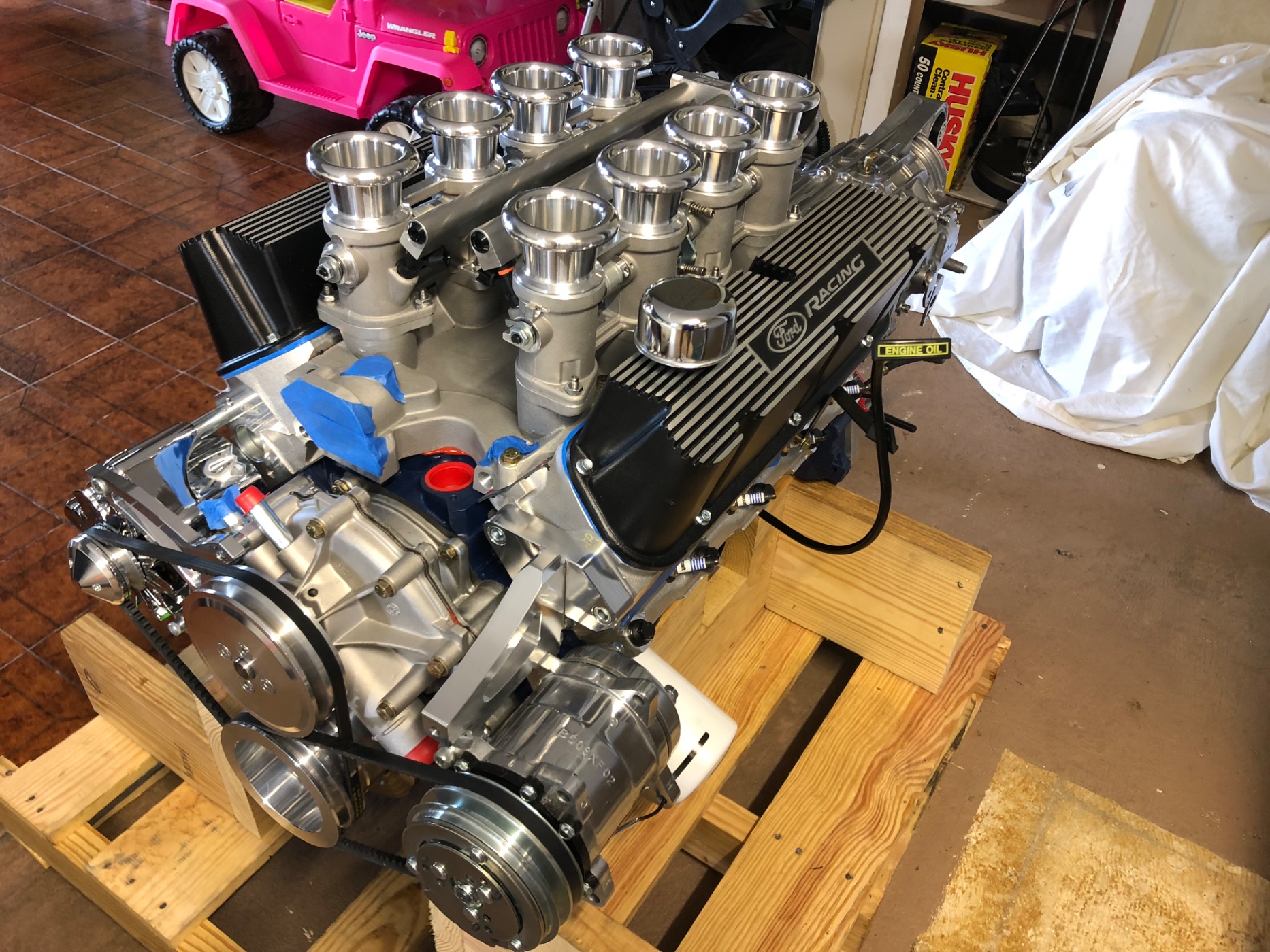

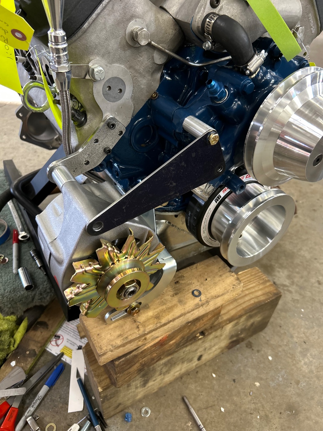

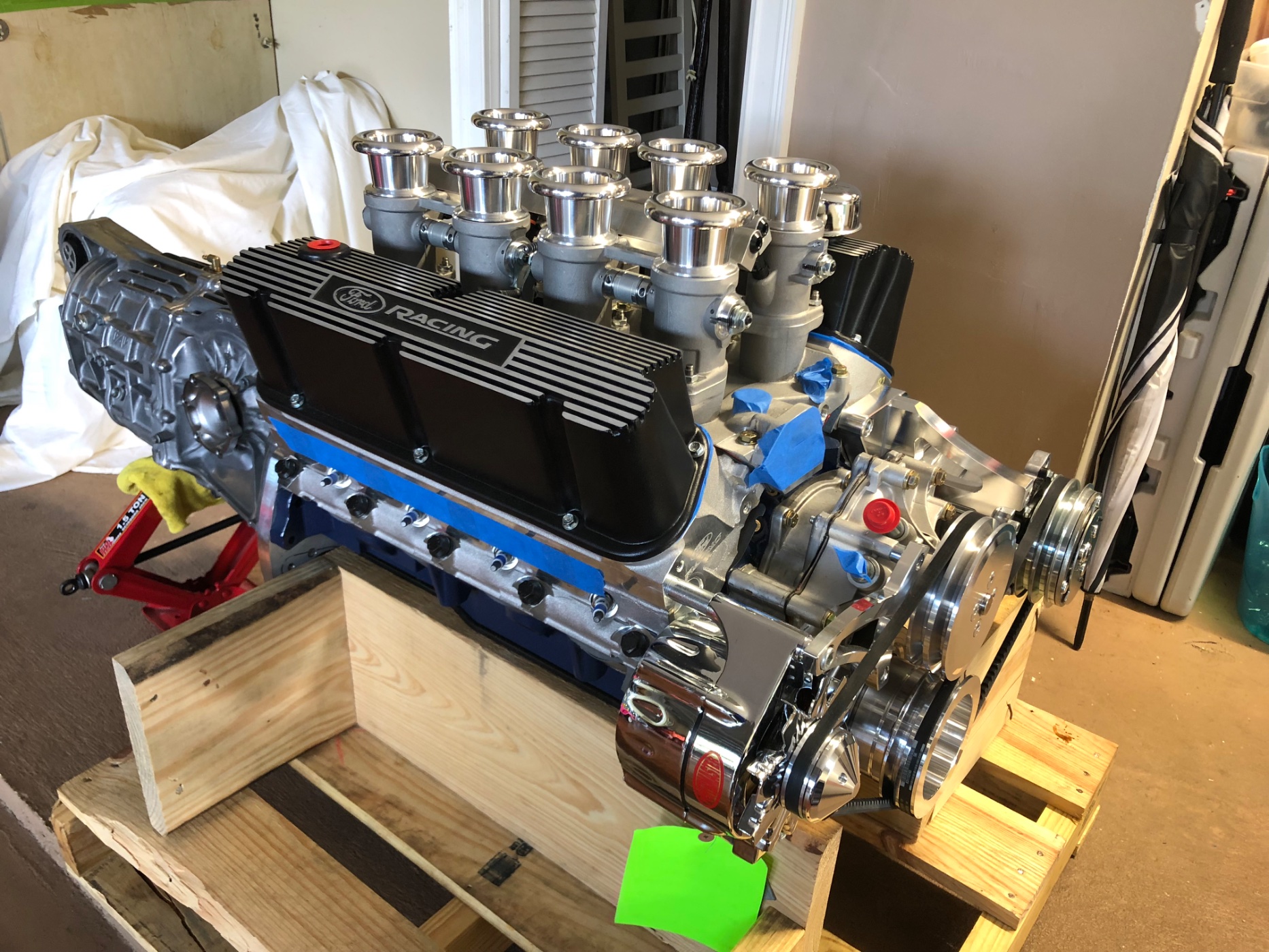

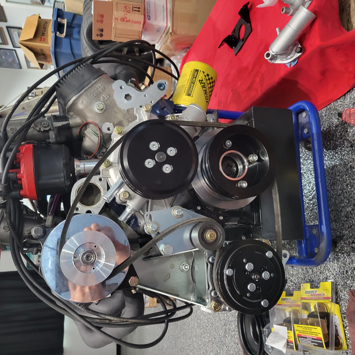

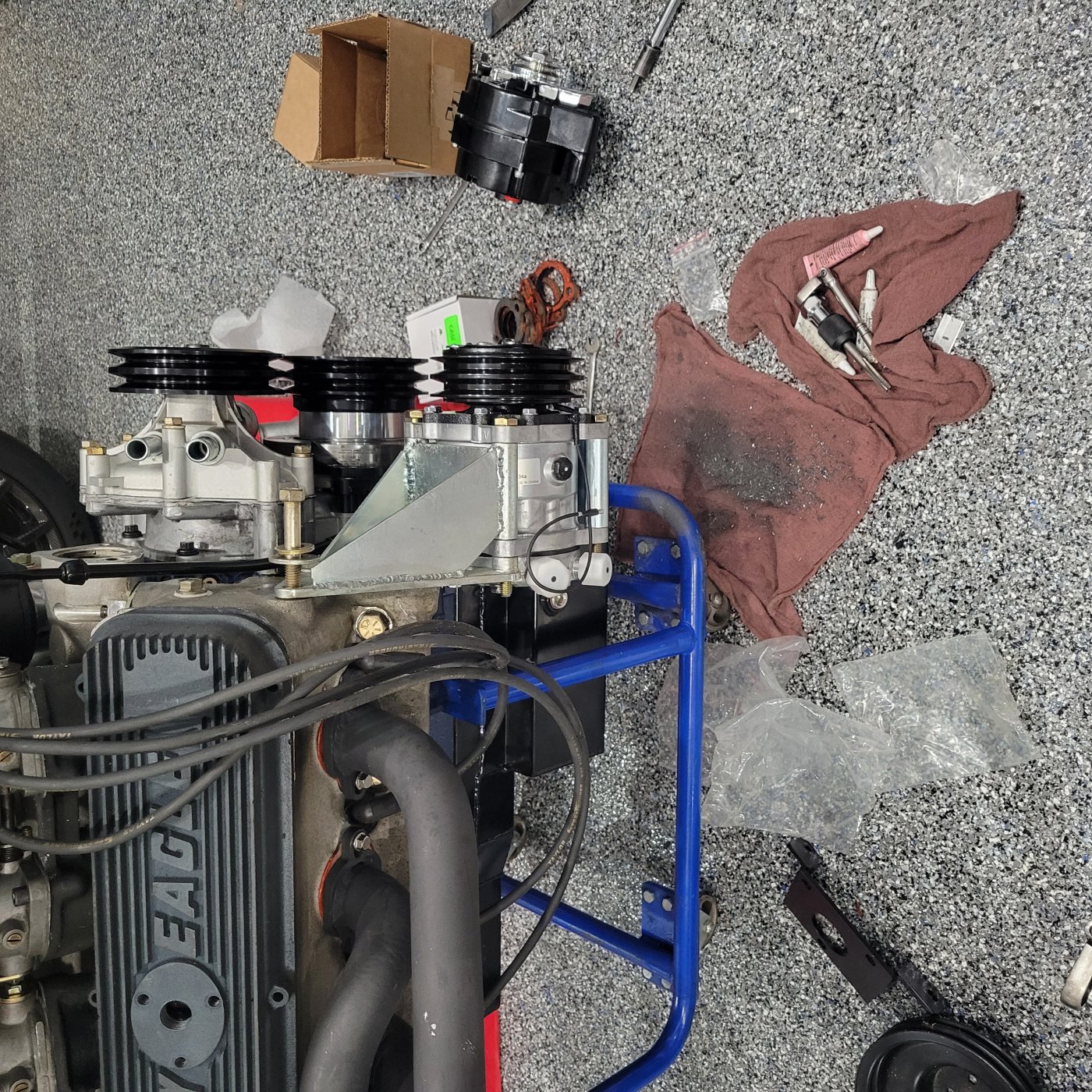

Paul, I just went through this with my Ford Motorsports block. The boss on the block below the head was there but not drilled and tapped. On my AC bracket it had a lower bolt hole that lined up with this boss and I center punched it and drilled and tapped it. See picture below. My engine has Gurney Westlake heads so I had to massage the holes that mounted the bracket to the head. Hope this helps.

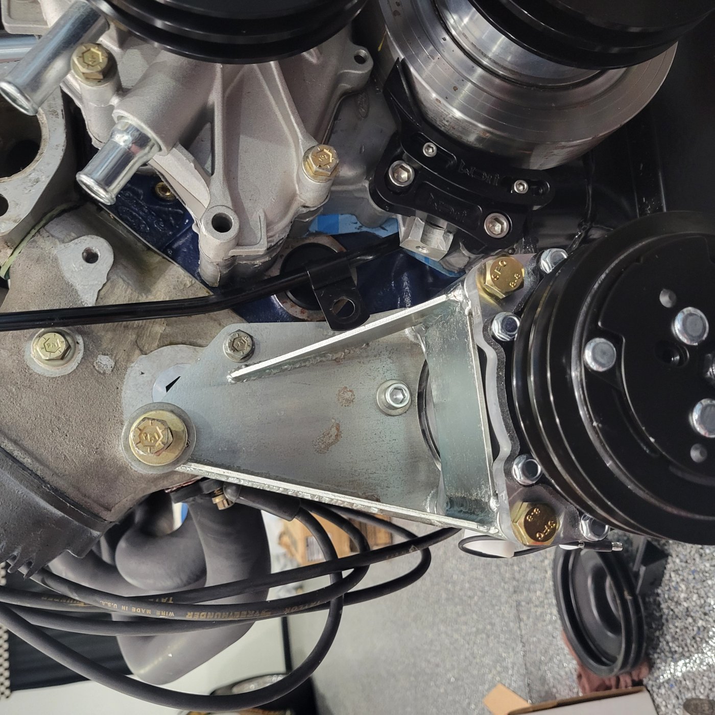

Doug, is this the bracket you're referring to
If so, it bolts to the head of the Boss302. The boss on the block appears to be the mount for the smog pump. Hard to find pictures on that but I've seen a couple showing the pump in that location and it appears to be mounted to the boss in question.
