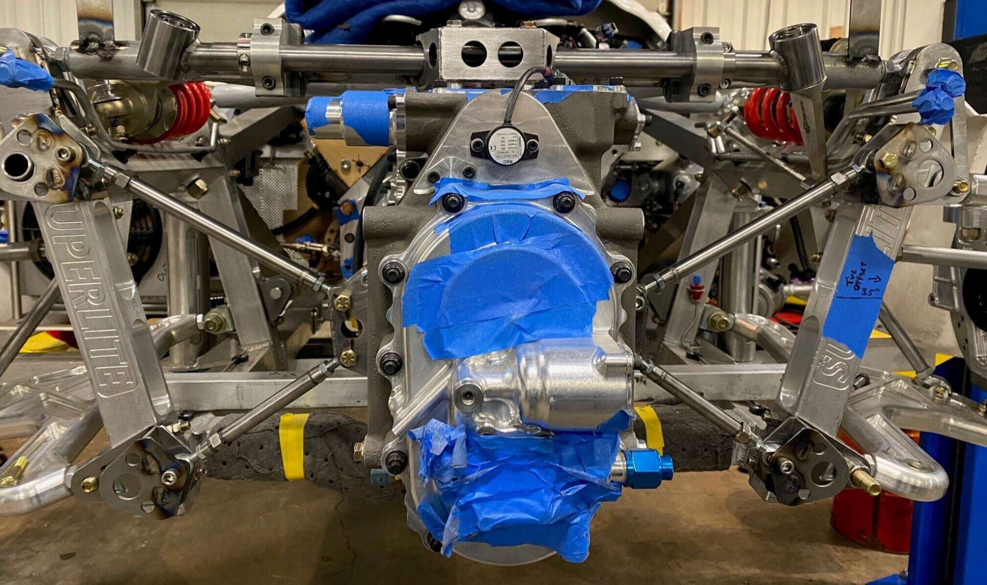

(3) The billet bulkhead plate enables you to treat the transaxle as a stressed member which will stiffen the rear billet uprights and the rear of the car. As can be seen below, four indexable links tie everything together and the box with the two holes on top of the transaxle connect the bulkhead plate to the to the rear suspension brace.

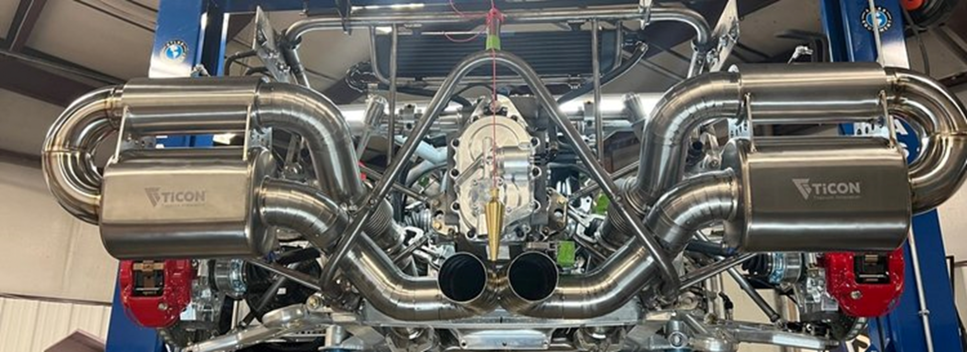

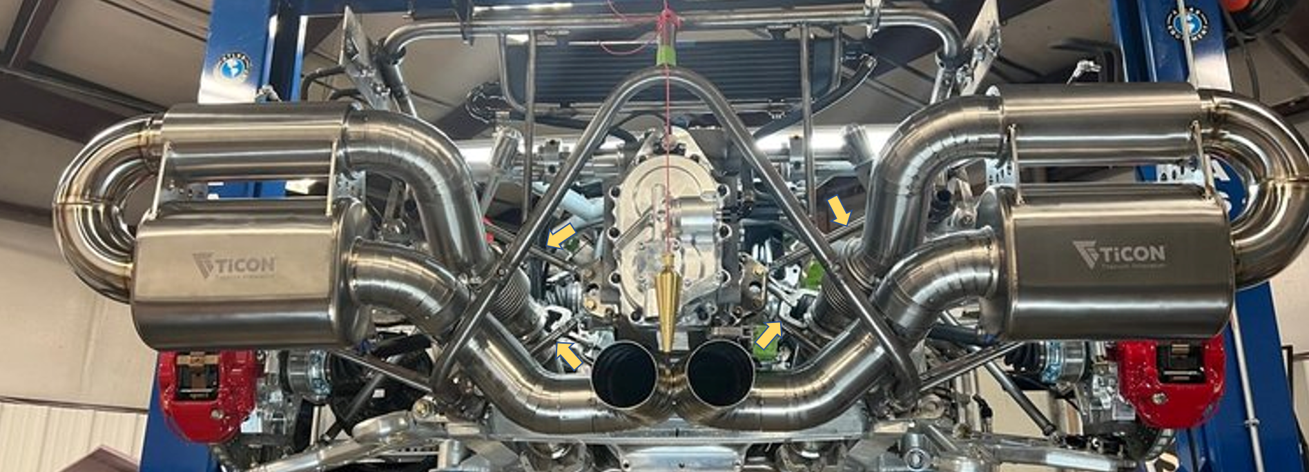

(4) There's lots of room under the transaxle. This provides you with at least two options: (1) If you have a dry sump, you can drop the drive train an inch or two -- the engine will bind before the transaxle or (2) you can keep the standard engine height and fit a 3.5" OD X-pipe under the transaxle as shown below.

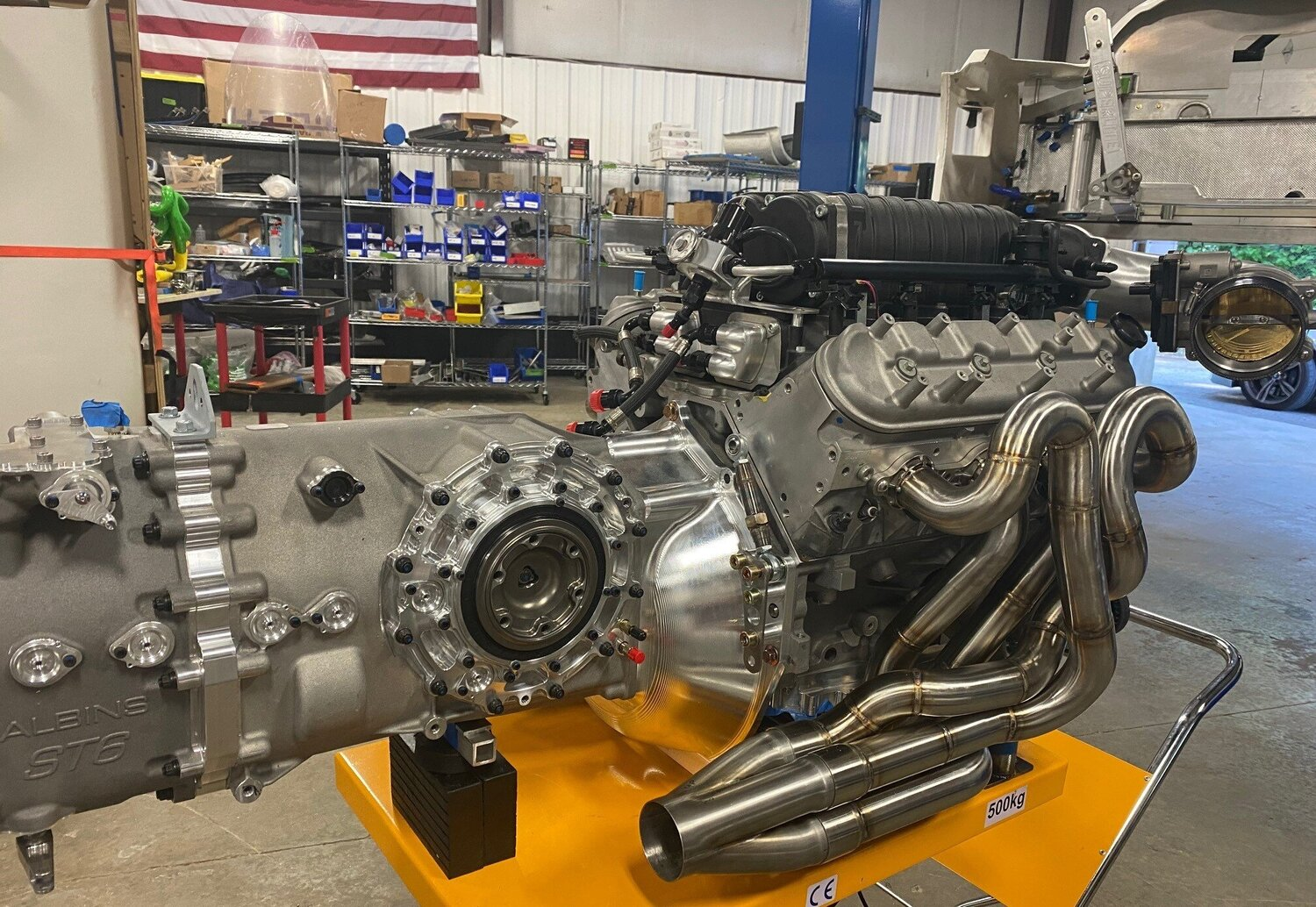

(5) Albins offers a billet bellhousing for LS engines which makes things easy. Here's a picture of my setup. This makes it clear how much room there is under the transaxle. I have dry sump and if were to lower the engine I'd machine the bottom of the bellhousing.
