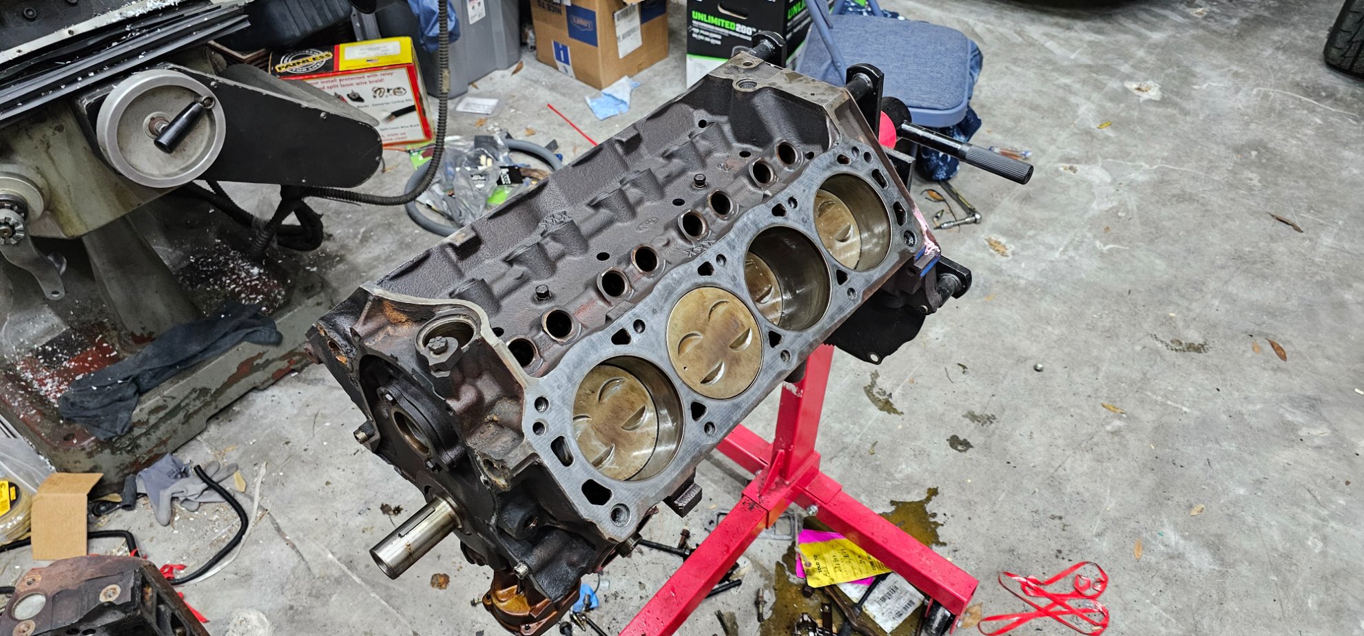

Choice of engine is a sbf 302. I figured I wanted to be around 400rwhp, which can be done relatively easily in a 302.
I bought a 302 out of a 1996 explorer and then took pretty much everything off of it and threw it away except the heads and intake manifold.
Machine shop bored it out to .030
Trick flow 11r heads, 56cc chamber, 190cc intake.
F303 camshaft with 1.72 rockers
Intake is an Edelbrock performer air gap
Efi Holley sniper
The heads and pistons should bump compression up to around 10.5:1 so I think this combo should be right around 400hp.

Looking good - but - I Hope you’re using different pistons than the ones shown as I am pretty sure those valve reliefs aren’t deep enough or big enough to keep your new intake and exhaust valves in the clear….
Those are the old factory explorer pistons. I put in the 11r trick flow pistons to match the valve size of the heads. Current setup as is does not bind in any way, you can rotate the engine without any issue at all. Definitely a bad idea to put those heads on stock pistons for sure

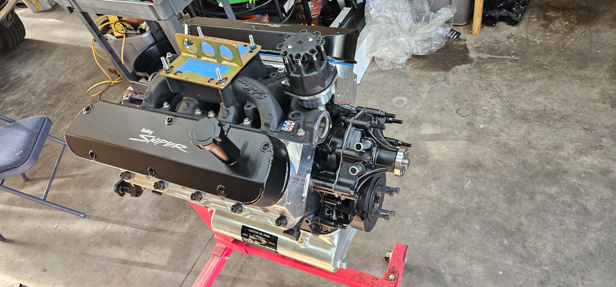

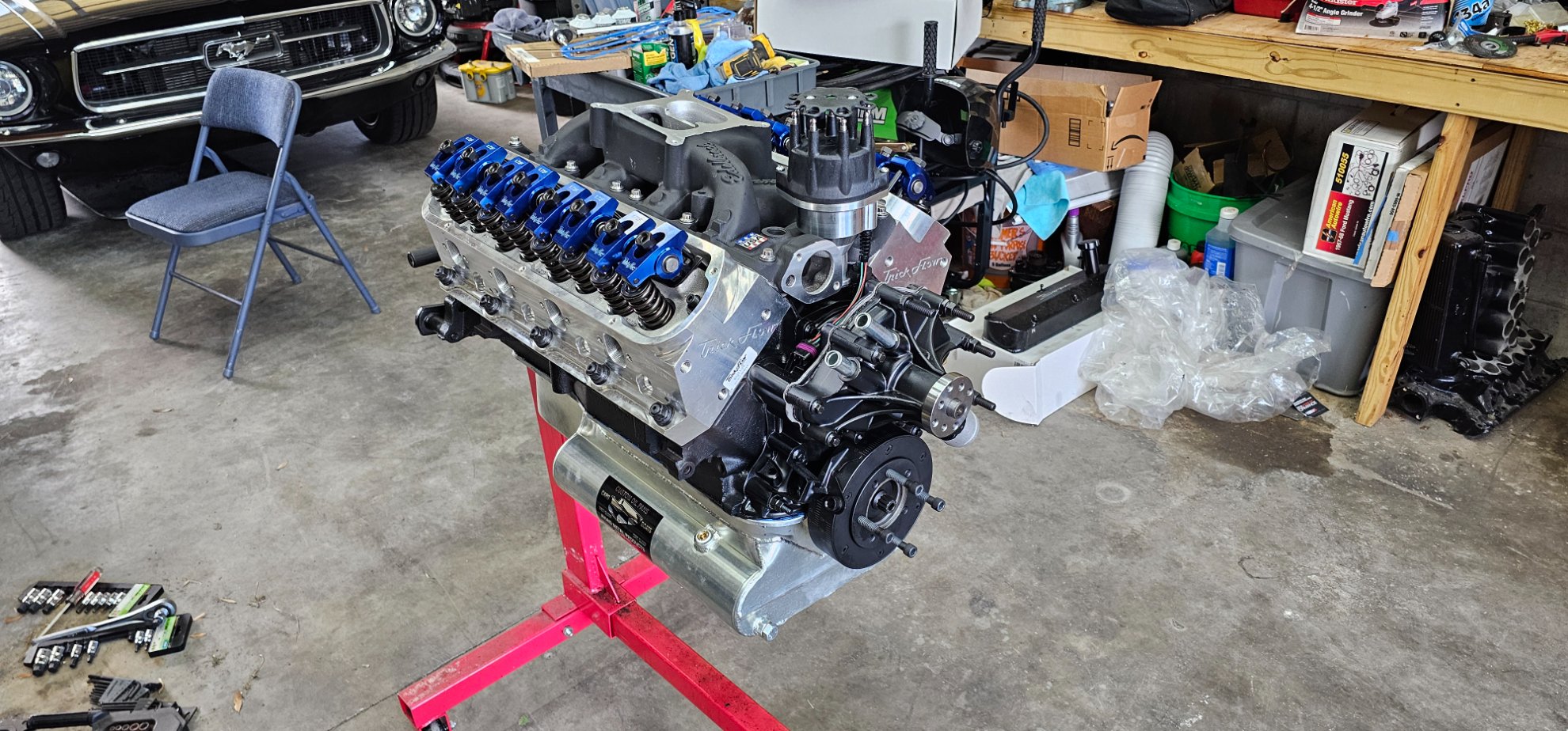

Nice, but I think you will get a problem with the vent tube height on the valve cover, it will probaly hit the rear clam shell.
I considered the 347 stroker, probably the main reason was cost and longevity that I didn't go with it. I can achieve the power I wanted without having to go that route so I decided against it.
As for valve cover height, I figured I'd run into clearance problems with it. Also concerned with intake height but we'll see. I don't really like the sniper valve covers too much but I like how they look. It wouldn't hurt my feelings if I had to change them

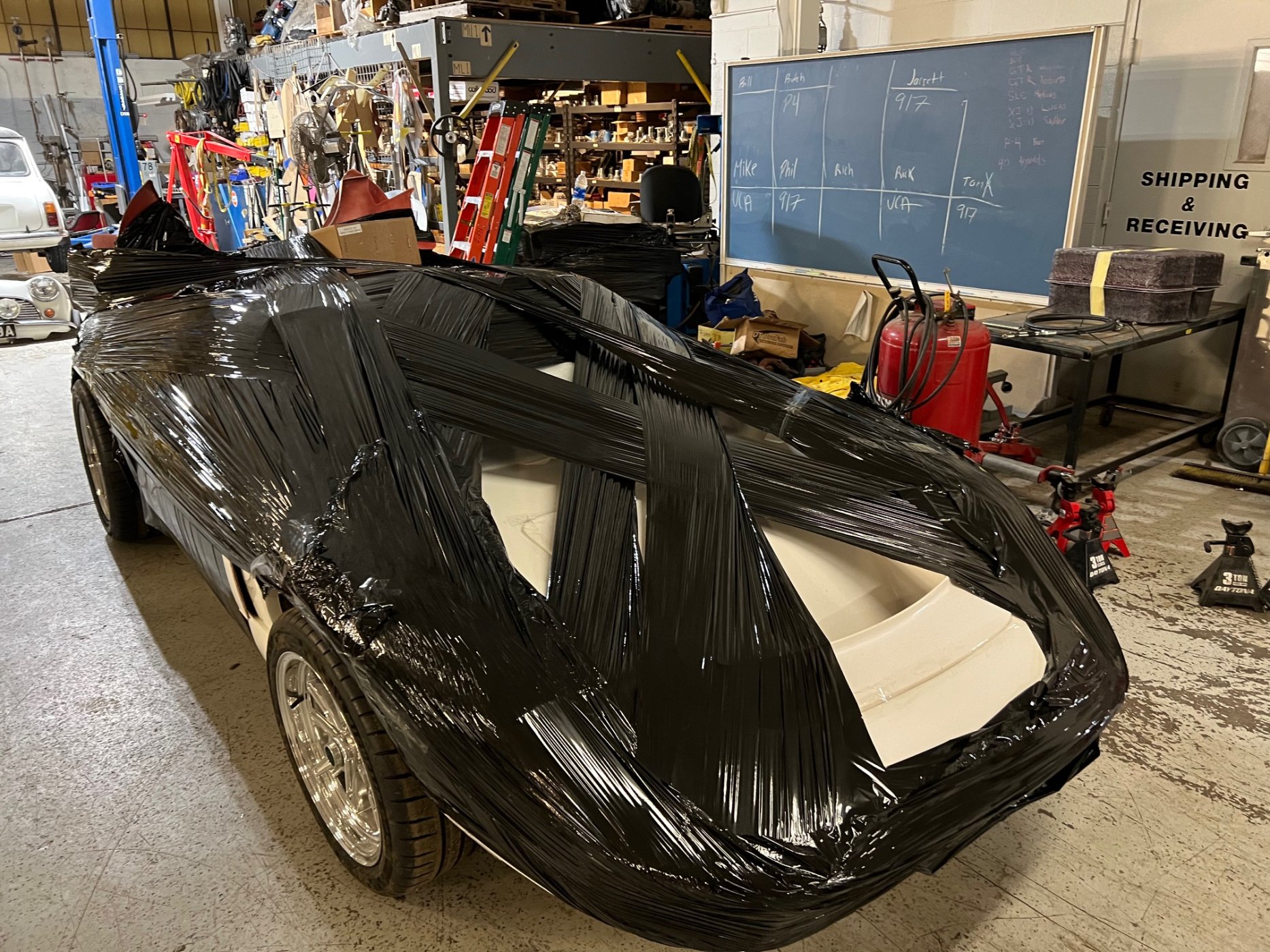

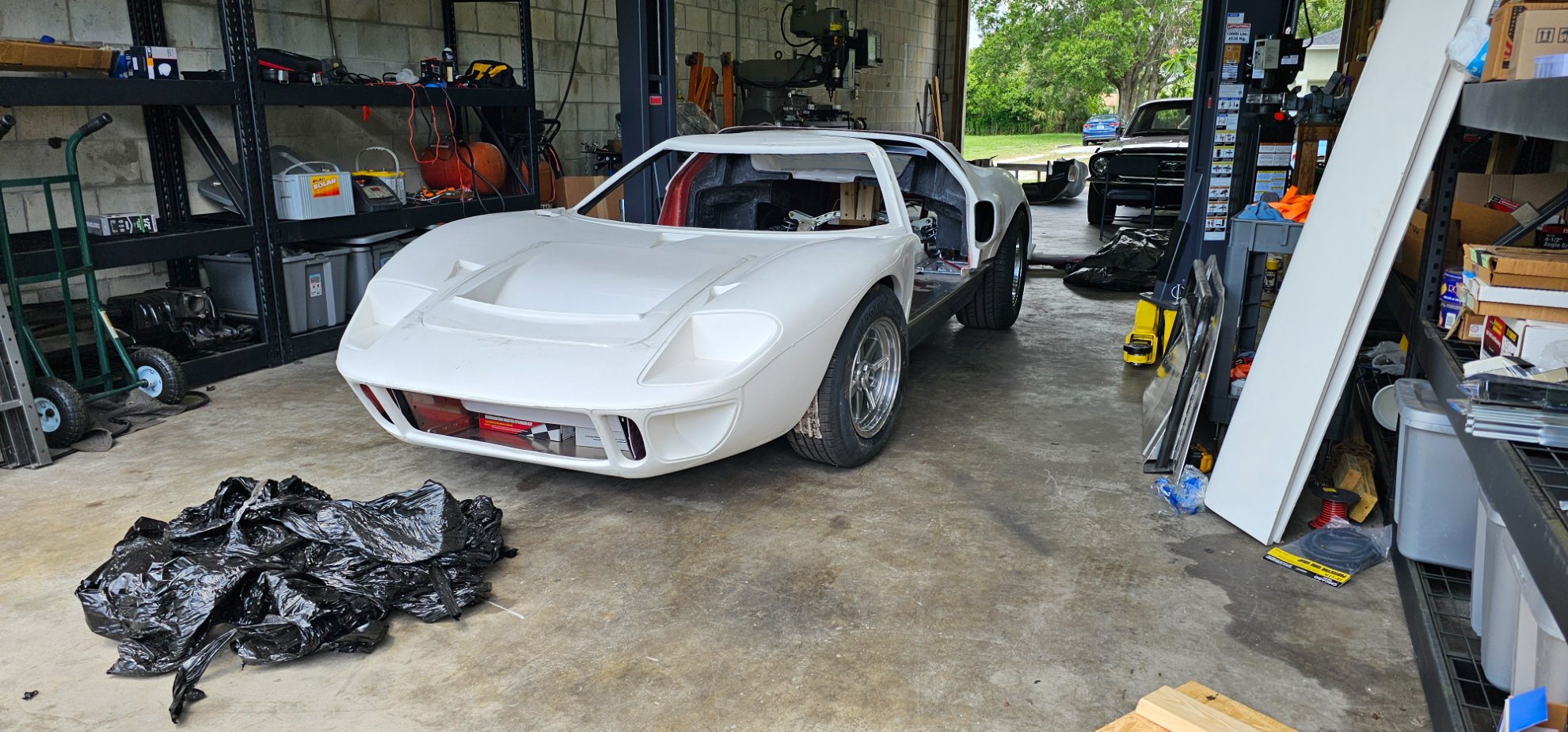

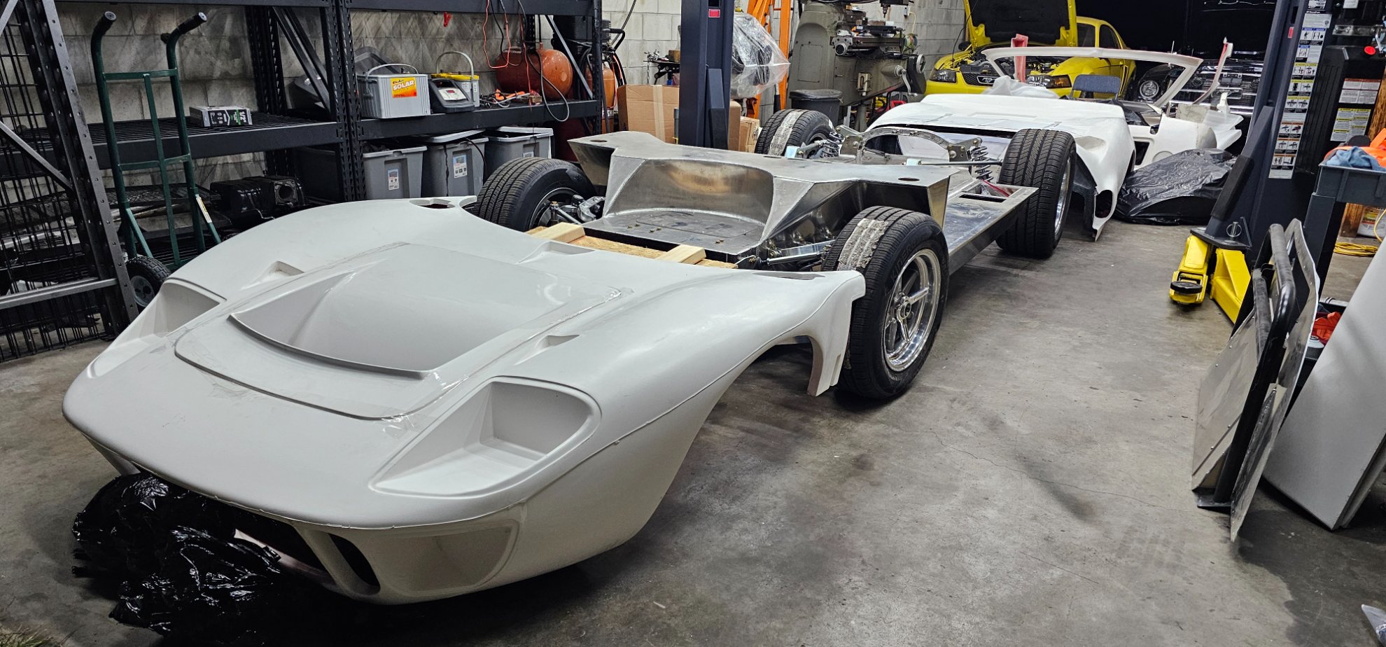

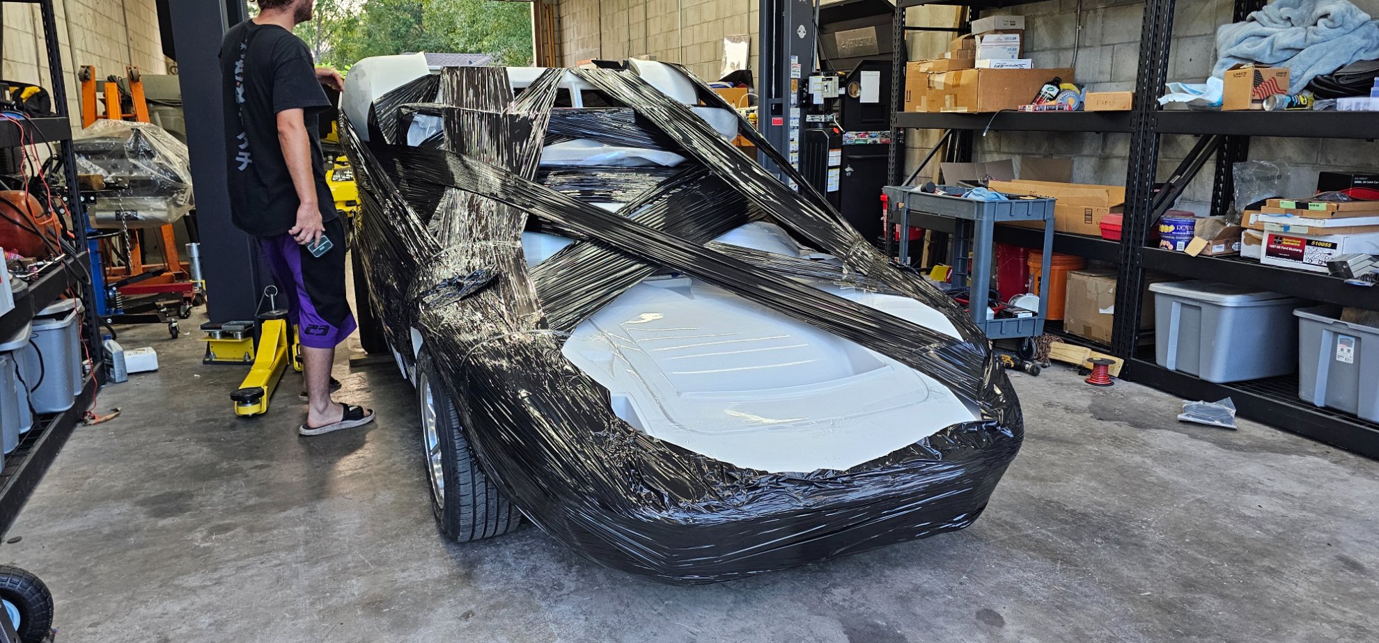

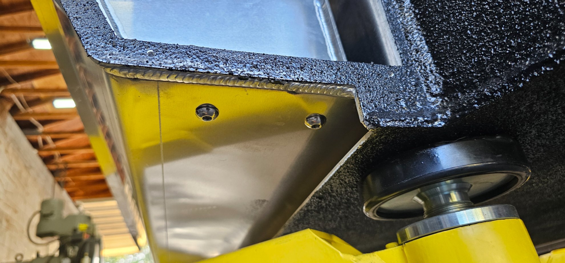

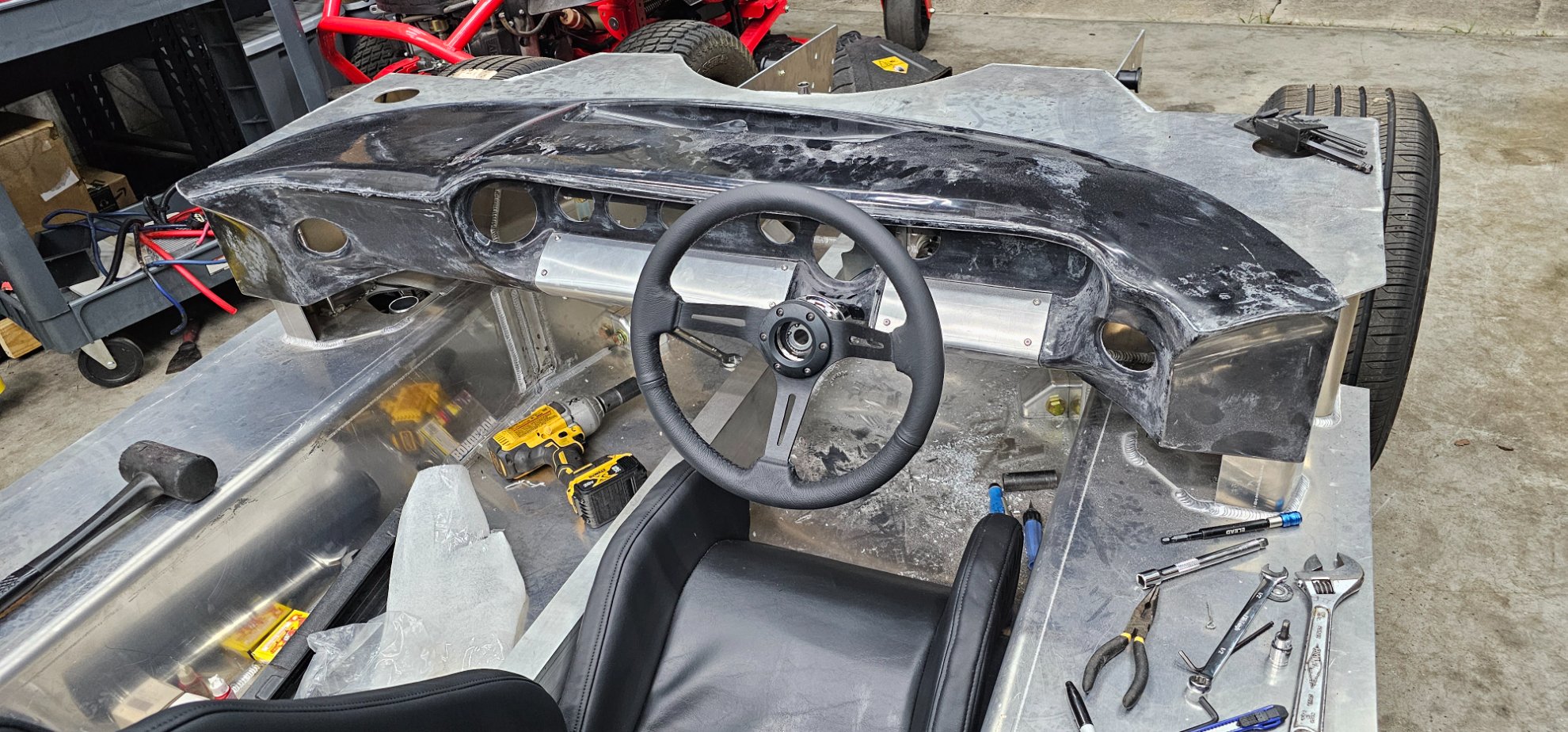

The car was delivered yesterday. I used Stewart transport and they got it to me really quick. No issues with them so they're a good option to anyone else looking for a shipping company.
Soon I'll get to disassembly and reassembly, but I have a couple things to figure out first. The transaxle was not with the car, I'll make the assumption that it is on backorder or being shipped but I'm not sure. So that's going to put a lot of it on hold for now but I can continue on with other parts of the car. I don't have a checklist of things to do inventory on or a list of items being shipped so I'll just be patient for now and see what shows up in the next couple of weeks.

Now I'm happy for you:) You've been waiting for a while now and you've finally received the building kit. I'm excited to see how many parts are missing when you finally get the overview. Good luck with your building project and look forward to following you further. I haven't received mine yet, but it's on its way and I'll pick it up in Oslo next Monday.
They sent the checklist and I still have a couple boxes to go through and store, so far everything missing is being drop shipped or on back order. Next step is to get it on the lift and disassemble everything and start the deburring process.
