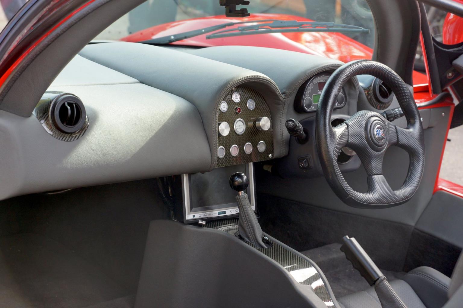

I've purchased this Alpine unit. I'm going to attempt to retro fit it to the SLC. The pic shows how my current rear view monitor is installed between the dash and the centre console, the dimesnions of the Alpine will allow me to fit it in this space; moving the Alpine unit towards the gear stick to allow enough depth. My existing camara should connect to the Alpine.
I just need to decide on amp & speakers and their location.

Dan, The main reason I purchased the Alpine is:
- rear view camera function is compatible with existing camera
- play music whilst driving
- it fits in the space i have available.
To be honest I’ve not even investigated whether it has an ‘accessory’ mode as it wasn’t a concern.
Also, I’m hopless with car audio and will have a professional install it. I will try and get them to provide me with details on how they wire it up.
