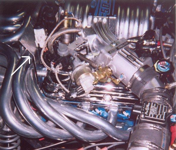

Neal,
Nice touch with the aluminized silicone fabric heat shielding on the back of the pan. I have a heat shield almost identical to rear wall of yours to protect the intake manifold and fuel rail from header heat on my car.
