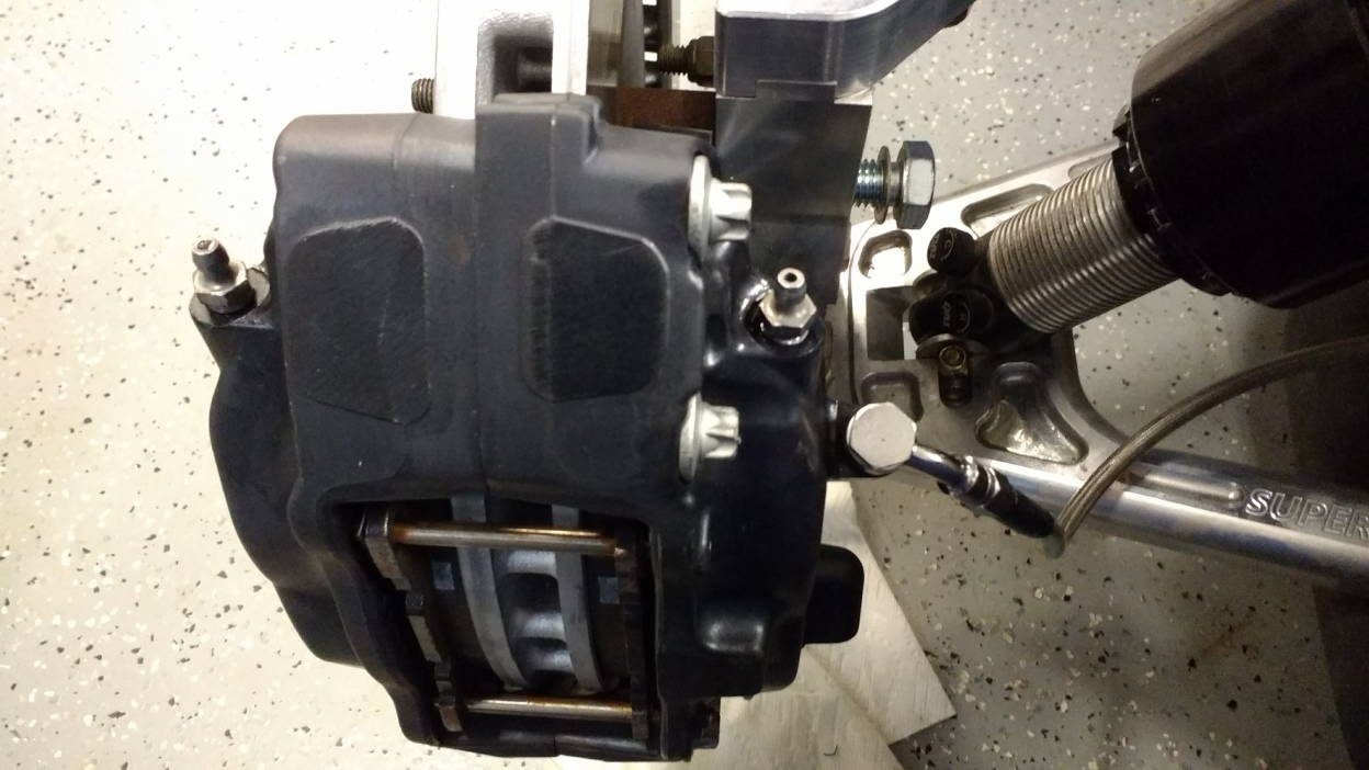

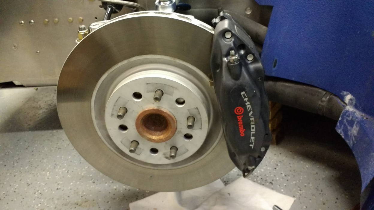

Randy: Pictures attached of the troublesome left front caliper. In one of the pictures, the spring was removed. This was done to see if it made any difference. It doesn't. What looks like rust on the caliper pins is actually a thin coating of high temperature brake lube.
