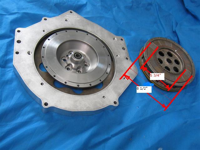

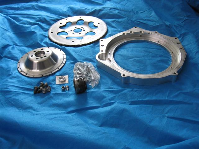

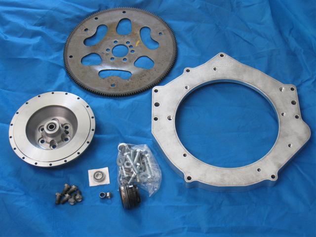

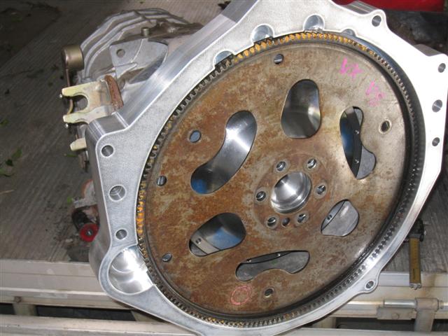

A G86/20 (6 speed Porsche boxter s ) to a Chevy LS1 -- nice light flywheel and "OS" triple plate clutch with throw out bearing extension, also uses standard LS1 starter and flexplate (ring gear)
See! -- nothings too much for our customers:laugh:

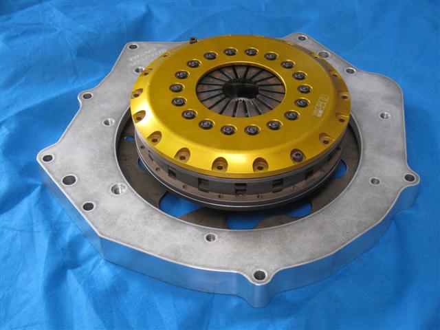

Right on Adam ---Simply a nice bit of gear and compact ( the Clutch )
Pricing :- The clutch pak I think is around $3.5k aud --the rest is around $1500 aud ( $960us) as a one off

OS Giken makes some superb clutches. I was actually going to use one myself, but now think I might go with an Tilton 7.25 triple organic button. Time will tell when I get further into the build :)
