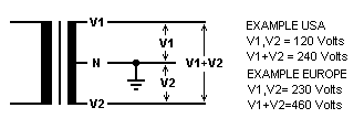

Perhaps this diagram will help explain; In the US 230V is phase to phase in the UK it is phase to Neutral.

As pointed out before 220V in the USA is achieved b going across 2 phases where as in the UK its a single phase.
