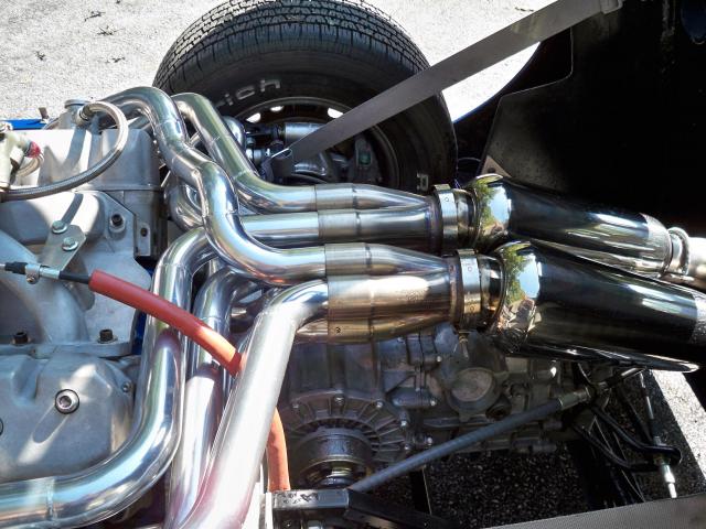

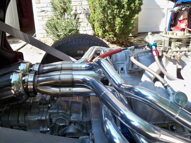

Here is mine with the rear clamshell up while we were aligning it last night, 930 4 speed.

As far as I know there was not a G50 4 speed transaxle. Are you sure you don't have the 930 transaxle?

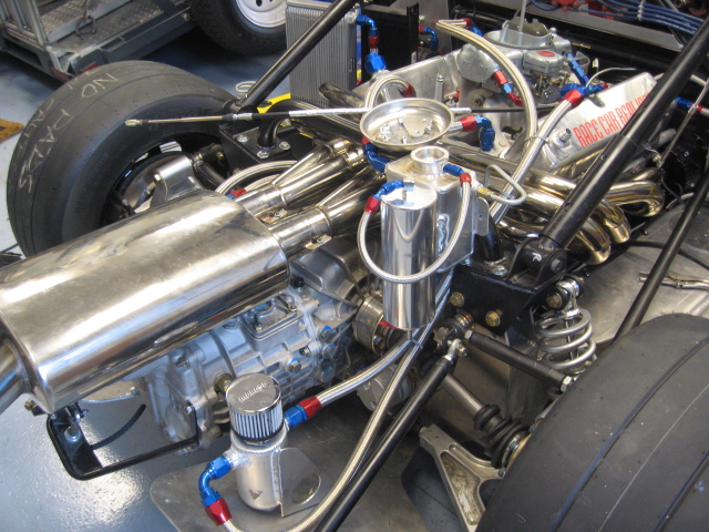

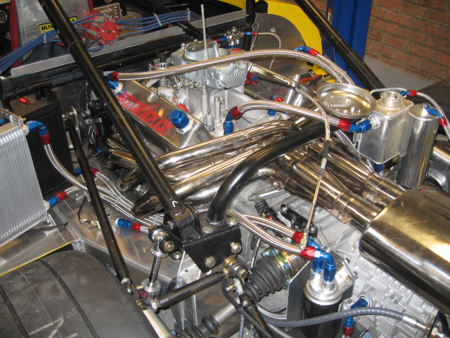

How's this??
This is a early RCR MK2 with a G50 .
I'm also guessing you have a 4 speed 930 trans which has the large actuator arm on the top, the G50 has no such arm. The RCR 930 rear cross brace is notched to clear it.
