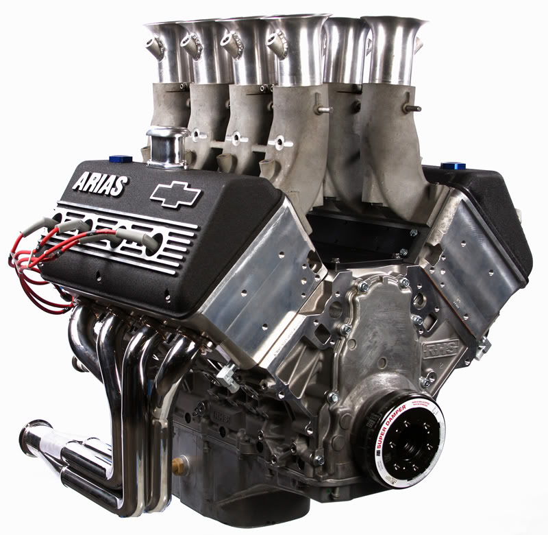

Hi GT fans, Seems Shelby via Denbeste is making a hemi head for the Ford Windsor engine. Check it out. ranger jim
They are available for the LS series engines too.
Maybe a pair of these could top off that flat plane crank LS that is being discussed on this forum ;)

But I think Arias actually exists, don't they? I mean, they are a real company and all and actually BUILD stuff, unlike certain others I could name.....
Mind you, how much more power would you get from a 351 with hemi heads versus good wedge heads? And would it matter in a GT40 or a Cobra? I suspect not.
While I haven't posted much, not any really, since joining but this one caught my eye.
Those heads look killer. The intake ports are almost big enough to stick my hand into. Which leads to my next comment....look at the HP and Torque outputs in the article. All that power is waaaaay up in the RPM band. A real dog down low too, only 296 HP at 3500. Not useful for anything but a drag engine. Heads with ports that big only work at high RPM.
If it had smaller ports and valves it would work for a road course or hot street engine.
Looks cool though.
