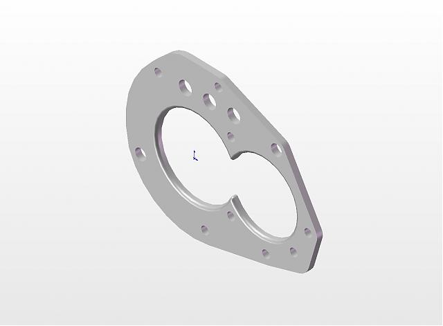

Julian et al,
I cannot post the Solidworks model. The manage attachments says "invalid file" when I try to upload it (as it's not a file type listed in the choices). Instead, I attached a .jpg file. Keep in mind, the model that Jim provided is only a 3D model, meaning it is not a dimensioned drawing. The .igs and files like .dfx are commonly used for machining programs (depending on the program; MasterCam, Virtual Gibb, etc).

S Steve,
I don't happen to have a jpg file handy, and I'm not really sure what good it would do you to have a picture. Andy just posted one if this helps. I don't have a drawing of this because I simply put the cast iron housing on a CMM (coordinate measuring machine) and got the data I wanted then I built a 3 dimensional model in Pro-E wildfire. Once I had this done I import the model into DelCam Powermill 8.0 and write a CNC program from this. Since I modeled the part I know what I want for tolerancing so I don't need a print to tell me. All of the little holes are clearanced for bolts so they don't have to be held really tight on position, the 2 little holes near the middle are oil communication holes so they don't have to be perfect. The 3 largest holes in line with each other are for the shift shafts, I modeled these kind of close to the shaft size so if your not going to hold good position increase there diameter. The 2 medium size holes that are some what diagonal of each other are for the dowel sleeve and need to be held tight on diameter and position.
Hope this helps:)

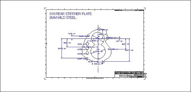

plate
Here is a drawing I did of the elusive plate.
I surface ground them down to about 7mm.
Take them to a clutch shop and throw them on the flywheel grinder.
Happy to email the DXF as long as its not to 3000 members if you know what I mean.
I can guarantee the accuracy.
Jim
