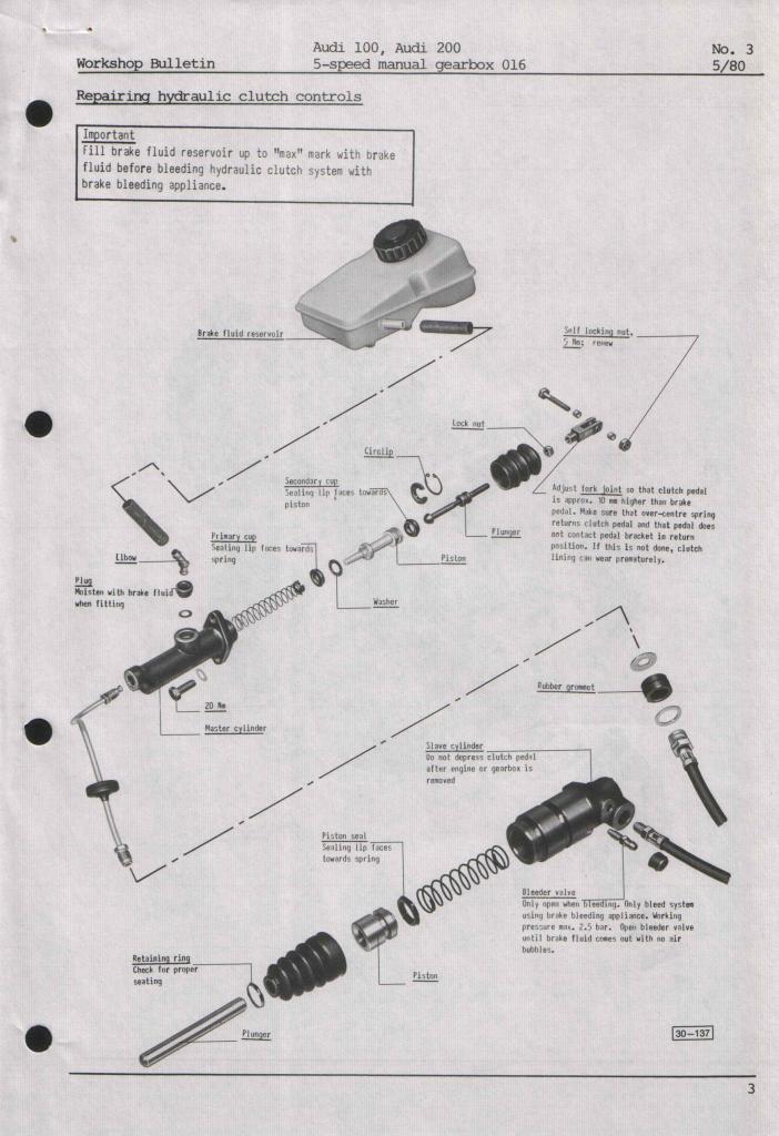

I have an older RF 40 running and Audi 5 speed gearbox. I cant seem to locate the bleed screw for the clutch slave cylinder. I can find the hose entry point from the master but cant see any where to bleed it from.

If it's an 016, it should be on the side of the slave cylinder. See diagram.
