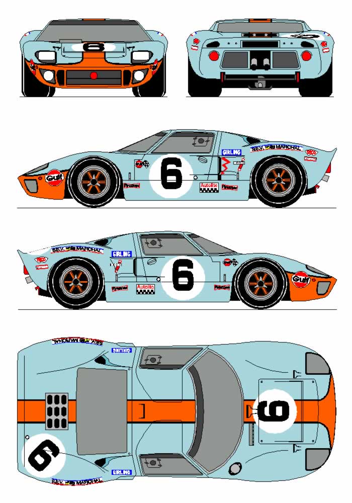

I found some photos on the web after looking around, slot car sites have some good ones. Here is one I found that might be helpfull. One thing that I think is missing from the decal collection on the #6 car is the Zig Zag arrow on the rear vent.
Here is the image I got, not super clear but you can make it all out

Last week I ordered the autolite with Mr. Collins. I also send him the files for the horseshoes and S. Yesterday I produced all the decals necessary for the 1968 version. I also made an fairly accurate replication of number 9. Therefore I did some accurate measuring of the sizes of these decals.
Ferodos is 22,65cm wide.
Autolite is 14 cm wide.
Firestone is 28 cm wide.
Gulf decal is 22,65cm (say 9 inch) high
Sylvania S is 10,3cm high
Horseshoes are 13,5cm high
White circle for number on doors and back are 50cm diameter
White circle for number on front is 56 cm diameter
Number 9 is 36cm high and 20,5cm wide
number 9 on front is 40,5cm high and 23cm wide
I believe the gulf decals with checkered flag are not part of the 1968 version (not on the back)
I made these also, if anyone is interested, because in this case the decals of Mr.Collins are not accurate replicas of the originals.
