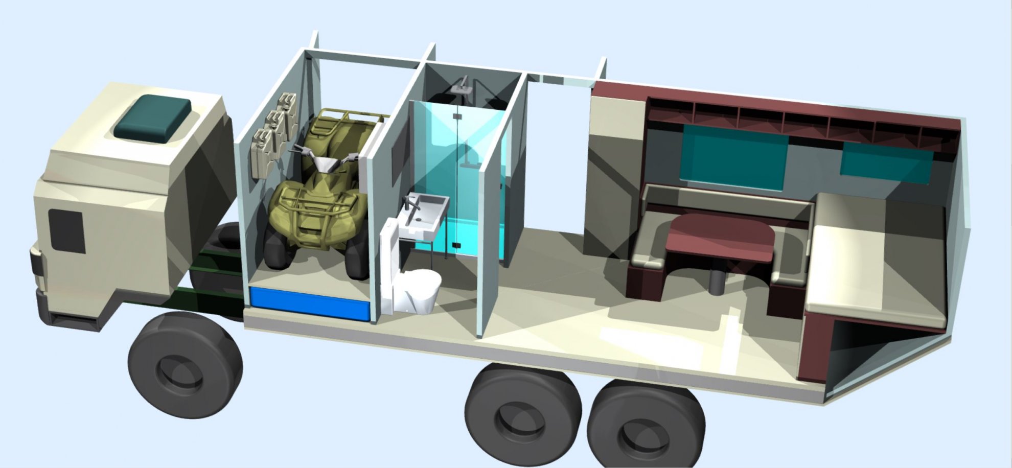

Will become this truck:
CNTlQGYFydJpFdTb56I2qdmhfAQm5NAJDuan-f4xnZ8ZzGARAt3T41O9IDz6ACuYrBHhbumKtBi7VHMTGD6Rld89nSUaF1bfXb9IOTQA91sI95Ht0hCWiC96vqDGylj9vWT5qmCVpjc9VrXPSfGCselzIRpCrQFJLSLjOvDvACJhH8j7Sk2S4Mu1FvLgU7f2bmbLclbbv9yGneI7mPI6DYoqQA1vhlY-aRdhMn7DiVxK5LlCqfPU9VLRLEZCrskq43iwjkWspDlsS5FAbAtKllAKneRquGYuH5bqFZ7TcH5k7rU3gEk_2LJ8IC0v_XY8aGzii5qt8nc2hpFTtzQ-5tzuCQsn87hT9gcdfn0CmhRbt8tkU0aRdGOHqPT6S4HecQQWTEudO5kKSCp9i_79t5H4D8sogk8WMUJEaHW0UVAMEc9RHVbwagV3yse195jd1PlnKIM6uve-iNZZh1kP1wwLNoXso0uu99lfklENE7p831RqGCOACI9hsBCrHCe512zczzcVMlfko0xnKiP-07zFFPUujcFPi2hYgT5Kd6A-saT2NuoEYiwGogA4qyz6jcejBJ3WobnRFbbudRVkGgtj1CJr18Uv0Ier87AEsKRWgxLuwxFUsrxKrMPXu18Z10EIFYJZ__sF_nSa5K_gfgnCgnkf7QzJIDBZt5DEWBwtmsp-GmRQkjsAYwIV9LiQNsBVNz1CraYnh_J8fTq0OH3c18iDz-GHxjATuiWjrOCpCYee=w1489-h848-no
(don't worry, the cargo bay at the back will have a door on it)

Much has already been done, much remains to be done. The tractor components were stripped off, driveline stuff rebuilt, induction system replaced, other chassis maintenance items addressed, tires replaced, radiator leak fixed..... and that was just the beginning. I have a build thread started on another forum which I have been pretty good at keeping current. The purpose of this post and thread is to share the project with you and possibly get some feedback on what I am doing and ways to make it better. I have always appreciated the amount of info passed around on this forum, maybe someone will have a good idea for me to incorporate here as well.
I will try to post on here when I post updates on the build thread, probably with just a link to the latest update. If you have any questions, picture requests (of the project, not me!), etc.. fire away!
And of course, as shown above, it will be painted in our traditional white with red livery.

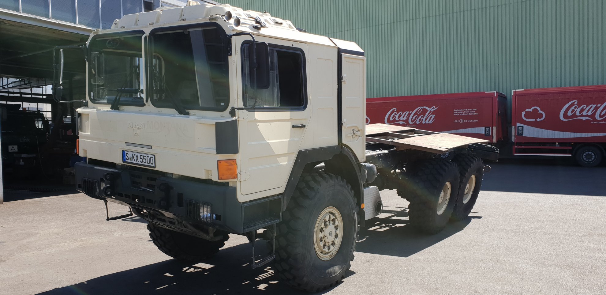

With the current emission rules in Europe anything less then a Euro 5 diesel engine will be out of the question now unless its stone age on classic registration.
So a Reo M35 multi fuel Whistler always tinkers me to do the same. ( they are available in Holland).

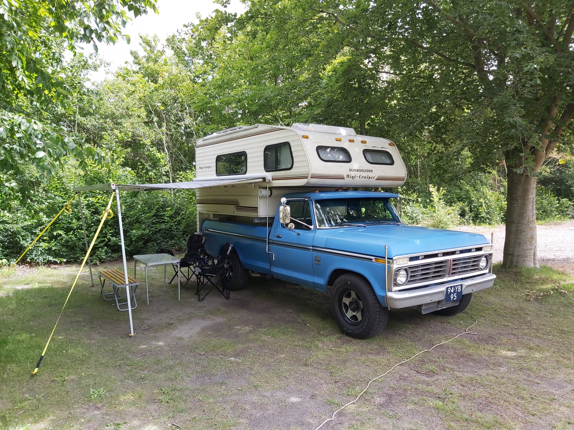

For the moment, our '73 F250 Camper special will do fine, and will haul our GT40 when its finished.

H.J. - That also looks like an AWESOME project! I think what we have is already overkill, but at one point I even thought about tracking down one of the HEMTT chassis instead. Then I realized just exactly how much more ridiculous that would be. So I throttled back down and went with just the 6x6.

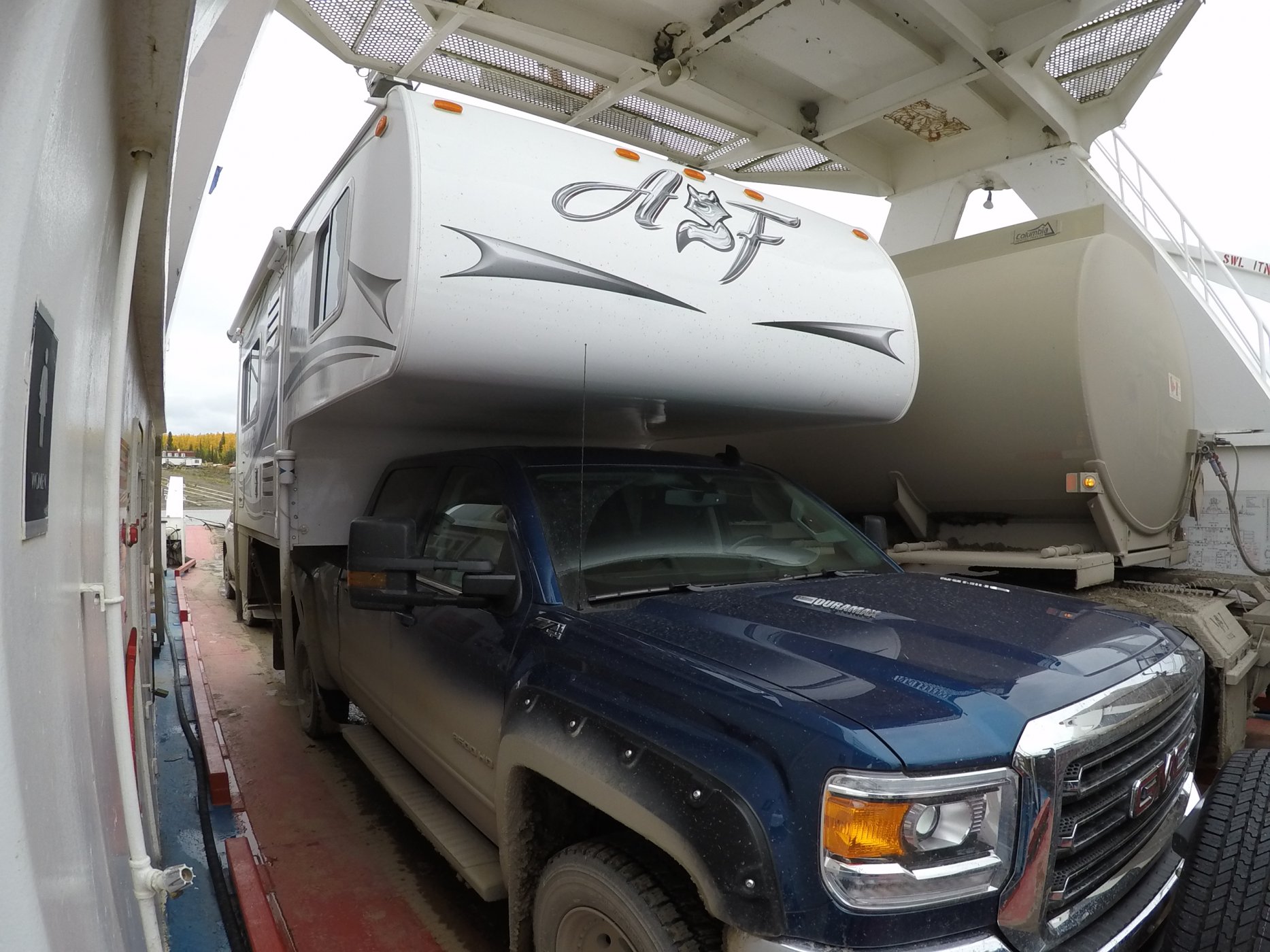

I'v had a bit to do with RV's and wanted to build that type of set up, it would have been a fun project, but went a Arctic Fox slide in and GM 3500 on singles. The camper is very heavy so I'm using commercial 19.5 in. tires on Vision wheels. Better in small places and one less vehicle to insure and maintain and 20 - 23 MPG. loaded with car in trailer. The best trip so far was going to Tuktoyaktuk on the Beaufort sea last year and have a look at the DEW line station.
Caution tho, There will be times when the twist will exceed the limits of your setup. With all my home work I was going to go with a three point system. A pivot on a rear cross member. Here on the north west coast of B.C. most roads are tight and twisty. Keep us up yo date and have fun, I like it.

We also had a slide in which we hauled in a crew cab dualie. The camper was a 2001 Bigfoot 25C10.6- which we loved for what it was, but felt it was lacking in storage and never felt "roomy". In addition, I was able to delaminate the front wall under the cabover at one point on a trip down a marginal road to access a trailhead for climbing. It took 3 hours to go 12 miles. The intent for this one is to endure no matter what we encounter and swallow TONS of gear, although I will admit it may not end up feeling much more roomy inside.
I am impressed that you can haul the truck, camper, and a loaded trailer while managing 20-23 MPG. That sounds dreamy compared to what I used to get with my rig ('06 Powerstroke, maybe 12 MPG on a good trip with the camper):
