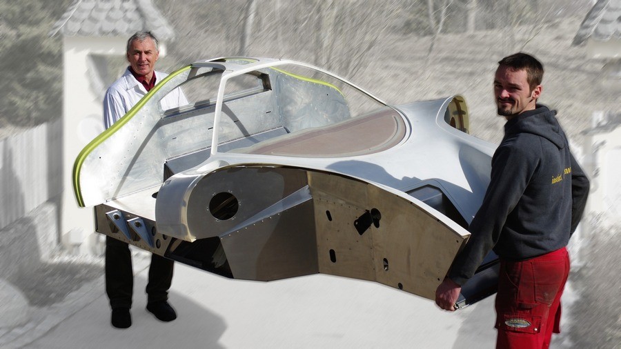

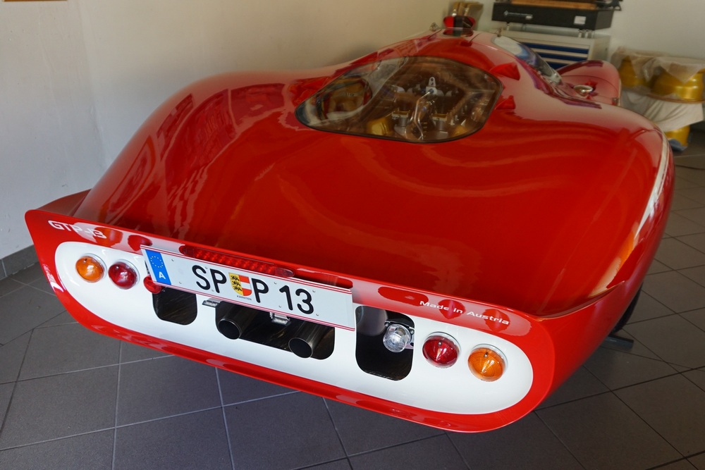

JWAE tested the GT40, Porsche 917, Mirage M4, and the Ford P68 3L in the MIRA wind tunnel. The results for the 3L were interesting: 15.66 sq foot frontal area, 0.334 drag coefficient @ 0 degrees yaw angle, 17 lbs lift on the front, 210 lbs downforce at the rear. The GTP13 builders modified the 3L body a bit so these figures are not exactly applicable. The dramatic introduction was over the top; but Verdi in the home town of Mozart??
Nice build, though.
