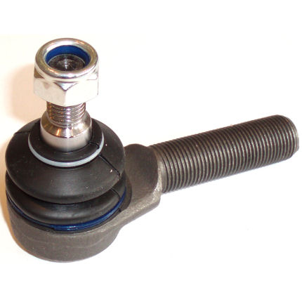

Is this what you mean? In the UK they are used at the end of the top wishbone on many kit cars. They are the steering drag link on the early Ford Transit van. Rally Design in the UK sell them.
