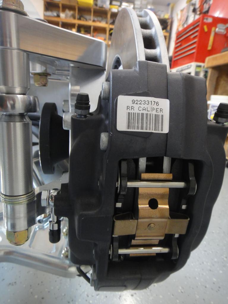

Dave Forster
Here's how mine are installed with the RCR-supplied fittings.
The 45 degree fittings should go in the rear and the straight ones in the front. The fittings are part of the kit.
They are now included with the brake line package.
