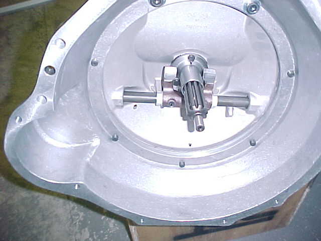

This is an old thread but can anybody shed any more light on Gary's request for a source for the ZF collar and throw out and give me a part number for the Tilton clutch recommended earlier.
Here is a shot of the front of my own ZF/2 with RBT bellhousing.
