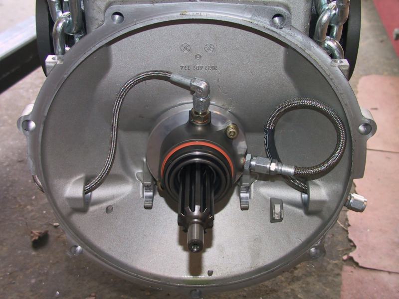

I ended up with this setup which thus far is working very well. It is a tilton hyd. throwout (the 1.9" tall porsche unit) and a custom adapter to mount it to the three bolts that hold on the front bearing support. That combined with the 19lb Tilton clutch make for very smooth operation.

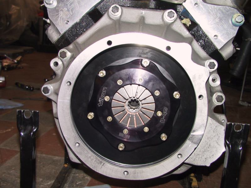

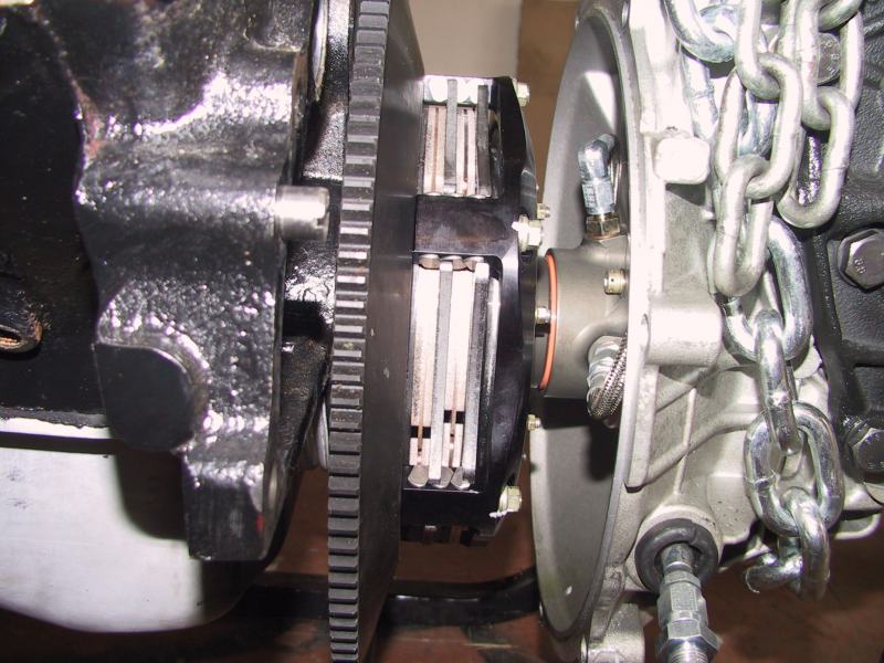

This is the flywheel assembly in relation to the throwout as installed with the belhousing removed to see how it all fits. Note 7.25" diameter clutch relative to the OE diameter flywheel. Total weight for flywheel clutch and pressure plate is 19lbs.
