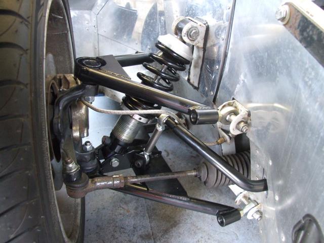

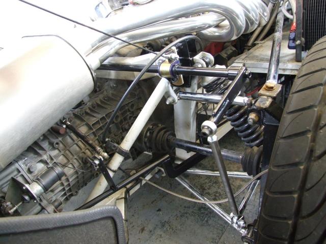

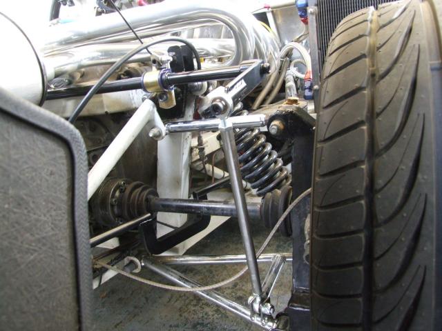

Paul, 22mm dia Special steel we use.
Paul

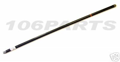

Hello Paul,
This thread has got me looking. so far the best i can find in terms of a straight splined ant-roll bar is from a Peugeot 106 and that was on Ebay, i haven't been able to find a proper supplier of universal antiroll bars but where theres a will theres EBAY!!!! I think the 205 may have had these type too.
Keep us up to date with your decisions etc so others may follow
